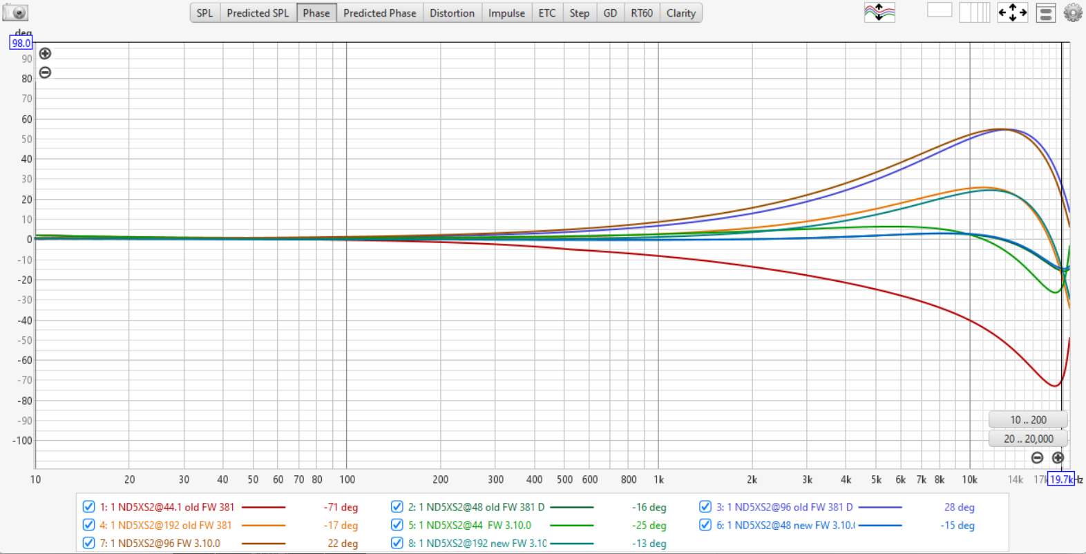

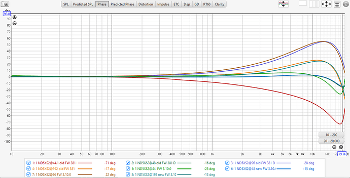

I’ve reviewed the phase shifts, and the only significant difference before and after the update is at 44.1kHz, where there’s a notable improvement in linearity. At 48kHz, there is no visible change, and at 96kHz and 192kHz, the change is minimal and hardly noticeable.
I did not test with or without a network cable, as I currently don’t have one available.

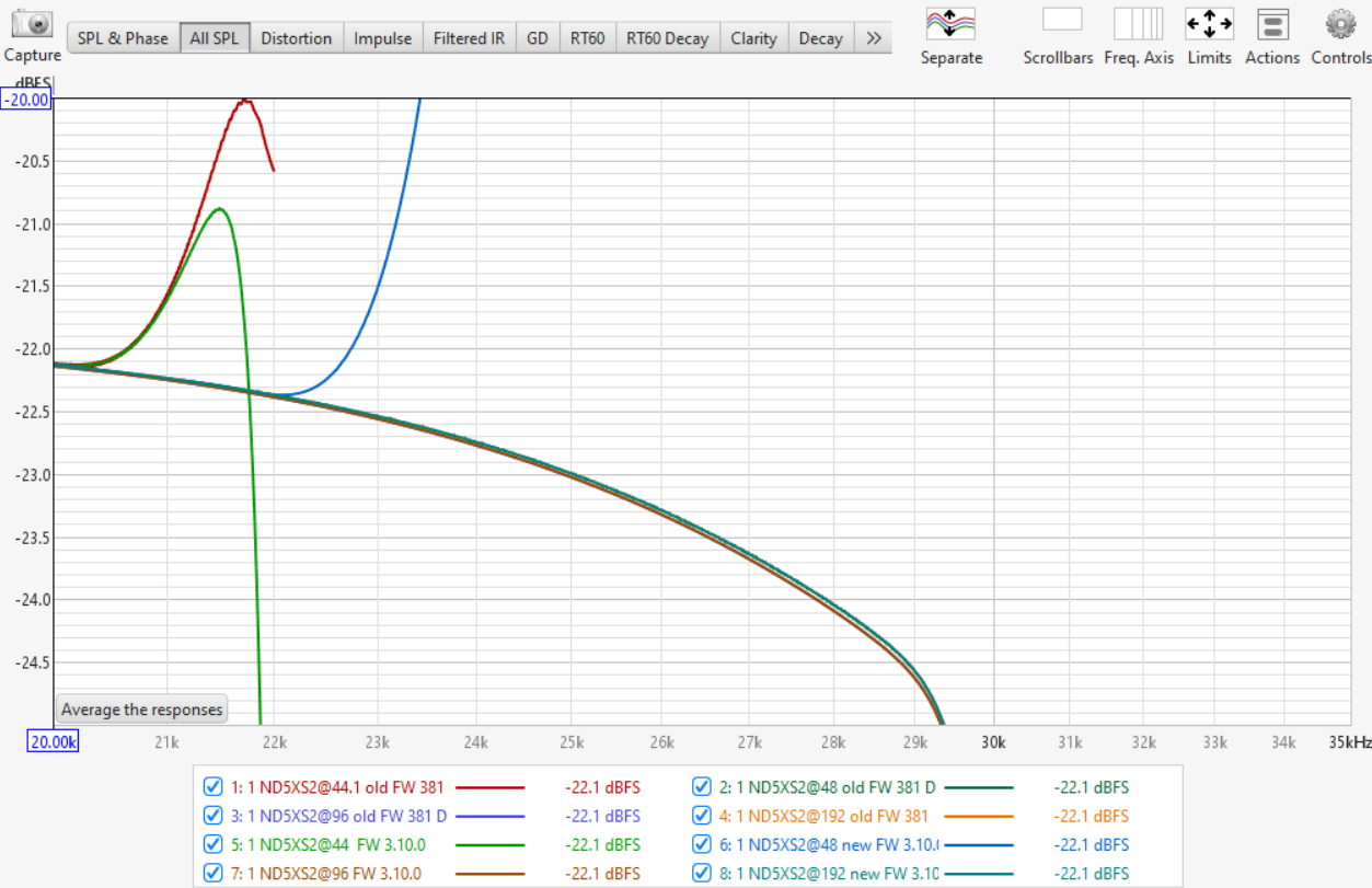

In the frequency domain, the only difference is at 44.1kHz, where there is a slightly lower cut-off frequency after the update. This is also evident in the impulse response comparison. The time difference between the apex of the first peak and the nadir of the following dip directly reflects the cut-off frequency.

Oscillation Changes in Impulse Response at 44.1 kHz
After the update, the oscillations observed in the impulse response at 44.1 kHz have become more pronounced and shifted closer to a frequency of 13,158 Hz. Prior to the update, the oscillations were at approximately 14,085 Hz, a less hearable frequency (I have recently tested my limits and cannot detect anything above 15kHz). The new frequency corresponds to the 7th harmonic of the musical note C#6, which is often considered dissonant or undesirable (anathema) due to its misalignment with the equal-tempered scale.
This change makes the oscillation more audible and potentially more bothersome, especially to individuals with more sensitive or better hearing, who may be more likely to notice the shift and its dissonant quality.
