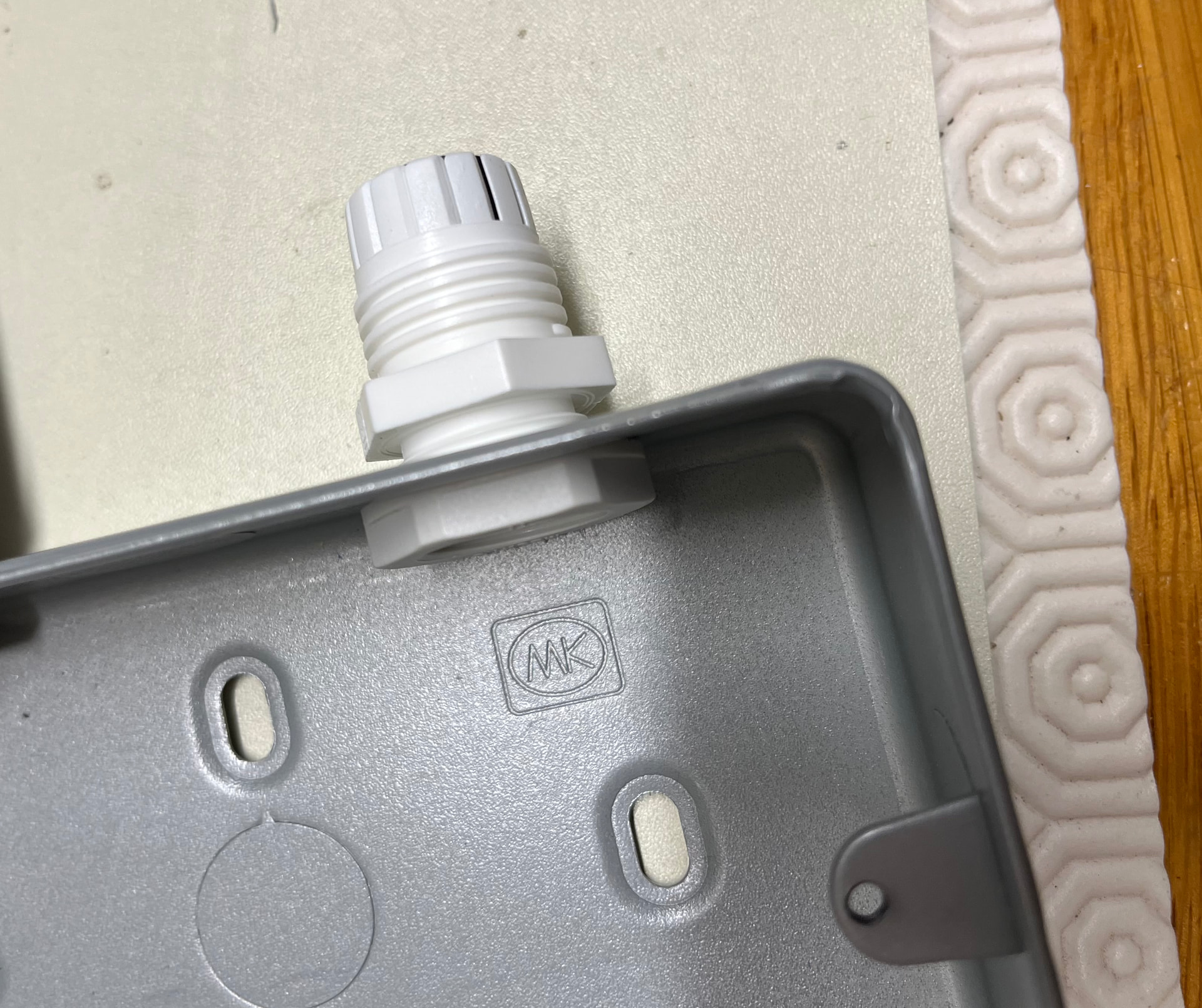

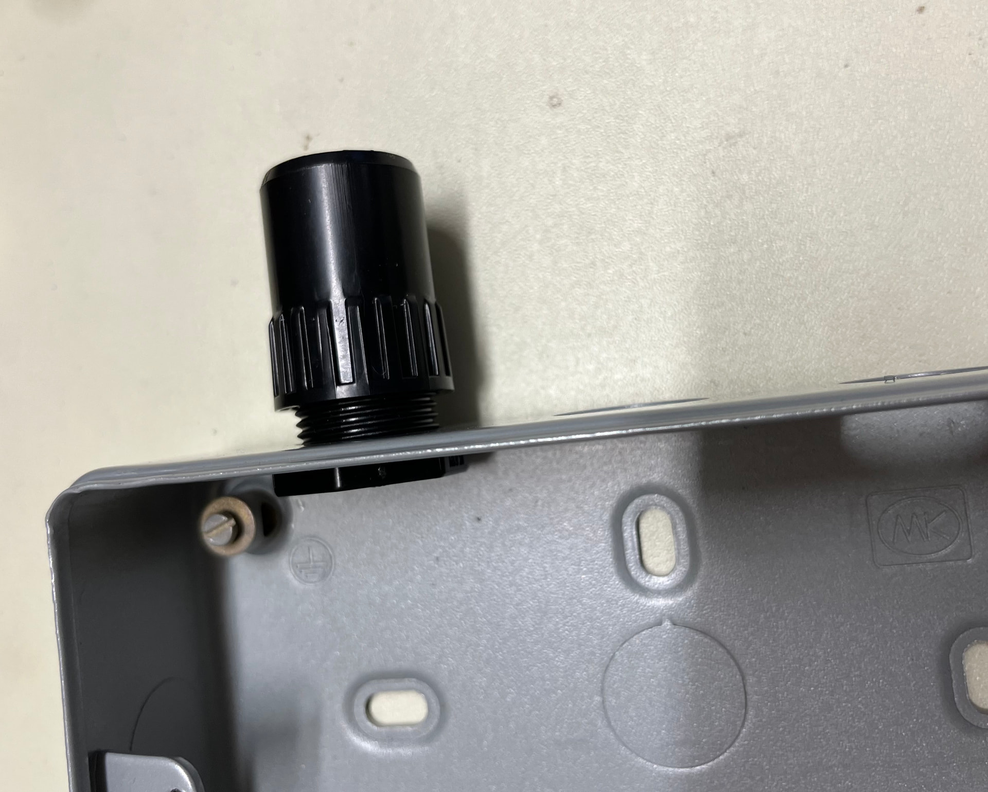

@What_Are_You_To_Me No photos of that one but after a rummage in the workshop I found some bits to do a mock up.
I put female conduit adapters between the boxes, using the two wider-spaced knockouts for stability. Cut down the sleeve to the knurled finger grip to give more space inside the box. I’ve also put 20mm rubber washers inbetween the boxes to allow for tolerance of the socket plates.
I also realised you could just use a gland without the compression bit on, again cutting down any excess.

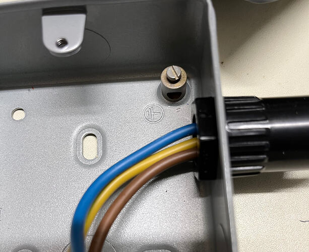

Finally, one thing you MUST do is keep all the wires threaded through the same hole, failing to do this (like having live and neutral in different holes) in metal boxes can create Eddy currents (heating) in the metal.
That’s standard practice in all electrical installations. But to cause any heating effect, even a 1’C temp rise, requires current (amps) and a lot more than any Naim box will draw.
More relevant in power supplies for audio is to twist the individual wires. This does a number of things the audio fraternity are concerned about, it reduces EMI, helps reject common-mode noise and lowers inductance.
