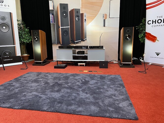

@mickdale I am not sure how relevant my experience is for you, but last week the local hifi store did a demo with Kudos 707, first powered passive and later switched to active. The difference in sound quality (and in price) was huge. I definitely preferred the active setup.
De demo started passive with an NDX2 powered by (I think) a SuperCap DR, NAC 552 and NAP 250DR. That played nice, but for the total system value I was not too impressed. This setup was around 60k Euro.
Then they switched to active, by adding the SNAXO powered by (I think) a SuperCap DR and the one NAP 250 DR was replaced by two NAP 250 DRs plus adequate cabling. The total extra cost was around 20k Euro, bringing the total system value up to 80k Euro.
Finally it sounded as open as I would expect from a setup with such a price tag. You could really hear the difference between the passive and the active filtering. I thought it was a huge difference. Of course the gain depends on the quality of the passive filter in the loudspeakers you are using. I would assume the filters in the Kudos 707 are of good quality.
Below you find a picture of the setup I listened to.
