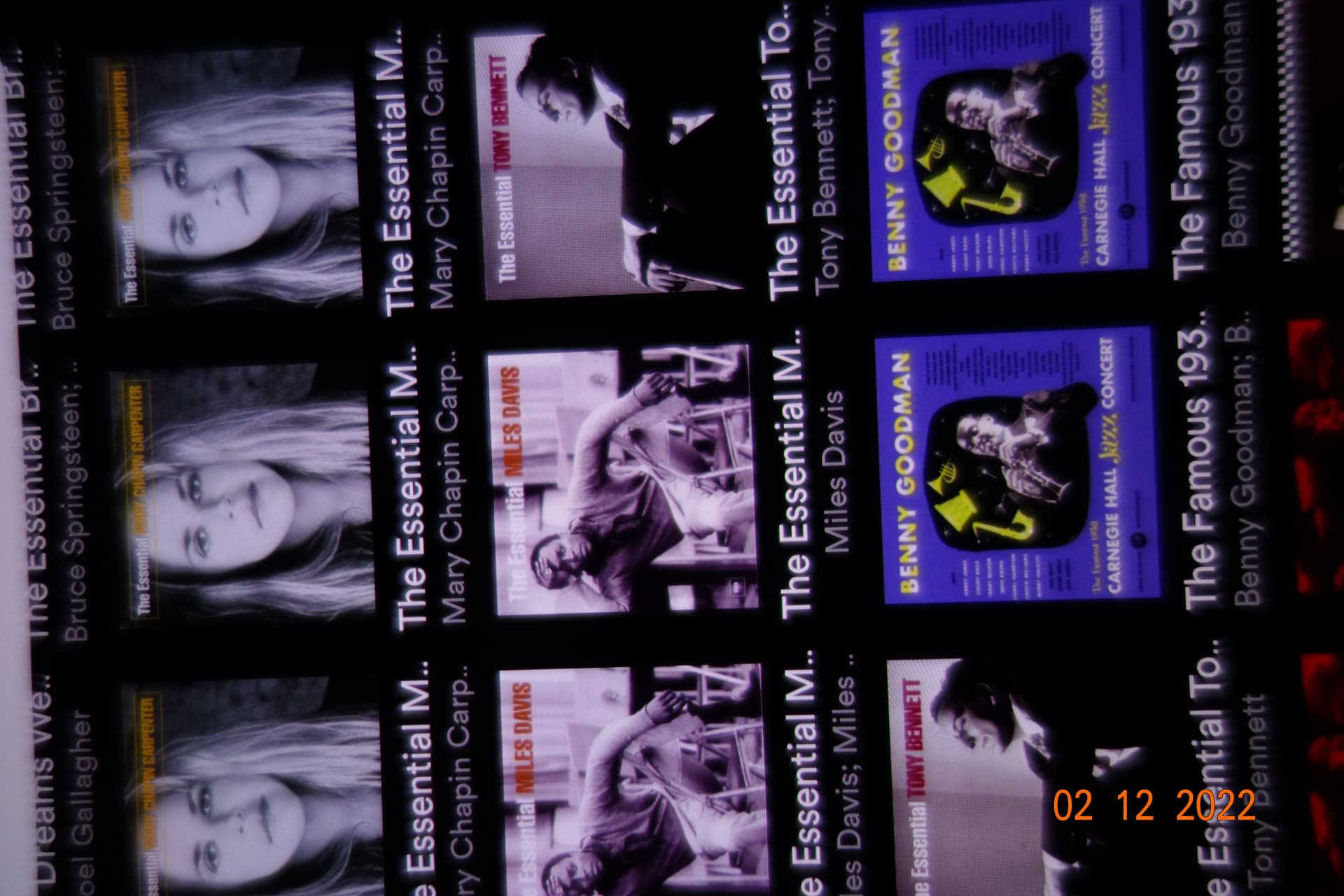

I have Asset installed on my Synology NAS with around 500 cd’s recorded on it. I stream these to an NDX2 using the Focal Naim app on my android phone. All software/hardware versions are up to date. Everything has been fine until a couple of weeks ago when I noticed that many of my cd’s had suddenly disappeared from my library on my focal/naim app.
I checked my music file on the NAS and all my music was still there. So, I asked Asset to clear the database and rescan all folders. When it had finished I looked on my focal/naim app and could see 1, 2 or 3 copies of each album. I have cleared and rescanned 3 times now but am still getting either 1, 2 or 3 copies of each album.

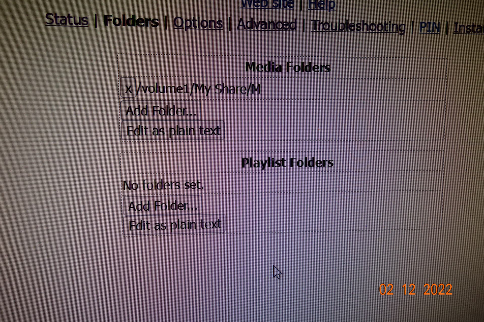

@philifa Asset will only include files in the folders you describe in the AssetUPnP configuration utility. I would check these settings and make sure they correspond with the specific NAS folders.

…for example, I list by all albums and Absolutely Free by Frank Zappa shows and Absolutely Free by Frank Zappa, Frank Zappa is also there. So albums are are showing 2 or 3 times because the artist’s name appears twice.

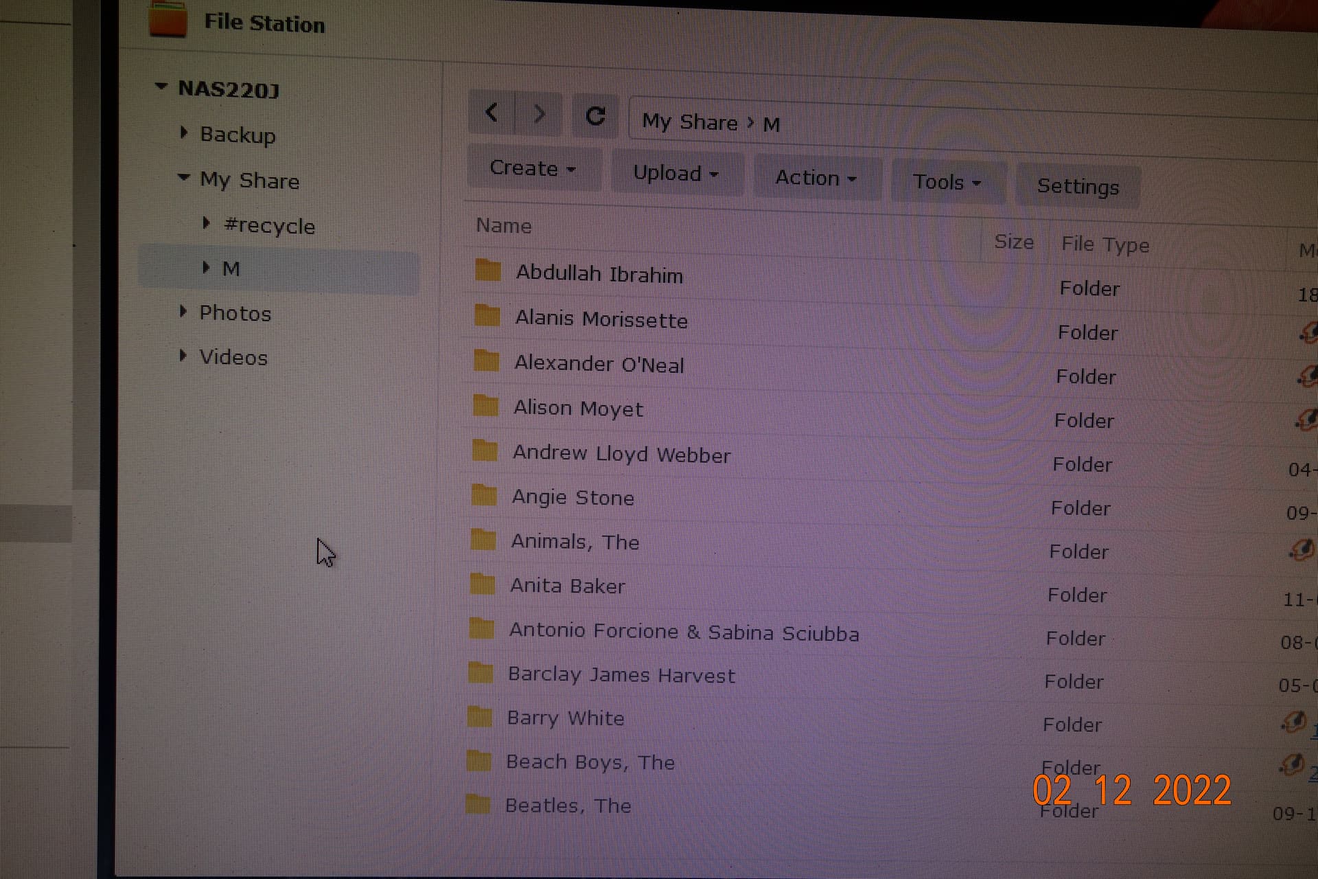

Did you check the music folders Asset is looking at in the Asset Configuration Utility (in Edit Advanced Settings) and whether these agree with your current NAS folder layout. Perhaps you can post a screenshot of that part of the configuration utility and the present NAS music folder structure.

Look into the NAS music tree over your laptop file explorer, if it is a just single file, with a single tree with artist or composer branches, then it should be OK.

I have cleared and rescanned many many times and it always comes up with the correct number of tracks and albums. There is defin itely only one file on the NAS that contains my music -
