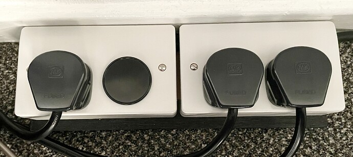

I don’t think they make them anymore but mine is an MK1 Powerigel (which was a lot cheaper) and mine was second hand.

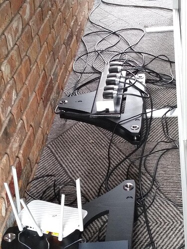

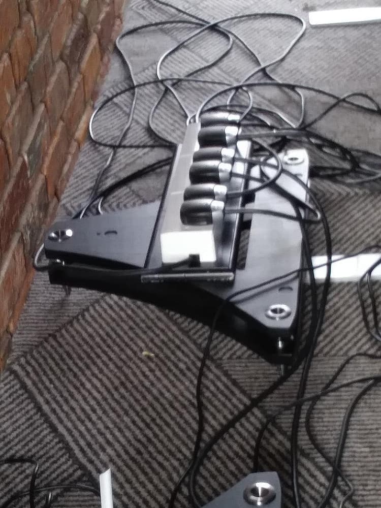

The (homemade) Naim Block used at Cranage hifi show 2018.
@Yorkshireman
Thanks for that picture. :+1:t2:
Looks pretty much the same as mine only more sockets. :partying_face: :+1:t2:
I don’t understand this. They put the block on a fraim to reduce vibrations. But have 14m of cable laying on the floor around it… They also seem to hook it up wirelessly. What a mess.
:thinking:
Wireless 230 has a bit left to go :smile: I was referring to the router :+1:
Oops sorry I only seen the bit I was interested in. :sunglasses:

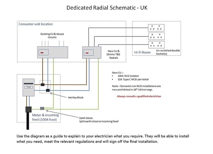

Does anyone know - is there a definitive guide on here regarding how to set up a dedicated supply, almost like a spec I could give to a sceptical sparky? Thanks
Just ask him to put in a seperate spur.
It’s the same as the new regs for CH boilers. :+1:t2:
Type Dedicated Radial into the search function and it will take you to multiple threads, some with diagrams.
How much benefit you get depends on doing it properly (earth back to meter or outside spike, Henly block, decent un-switched sockets), but also the state of the existing supply wiring, what else is on the circuit, how good or bad your mains is and so on.
This was put up by a member a while back and used many times. There are multiple discussions on this forum on whether to have multiple radials (as per diagram) or a single one, then use a block after that. I have a single one, but suggest if you dont get your specific questions answered in the other similar threads, then please start a new thread so it doesn’t distract from this thread
