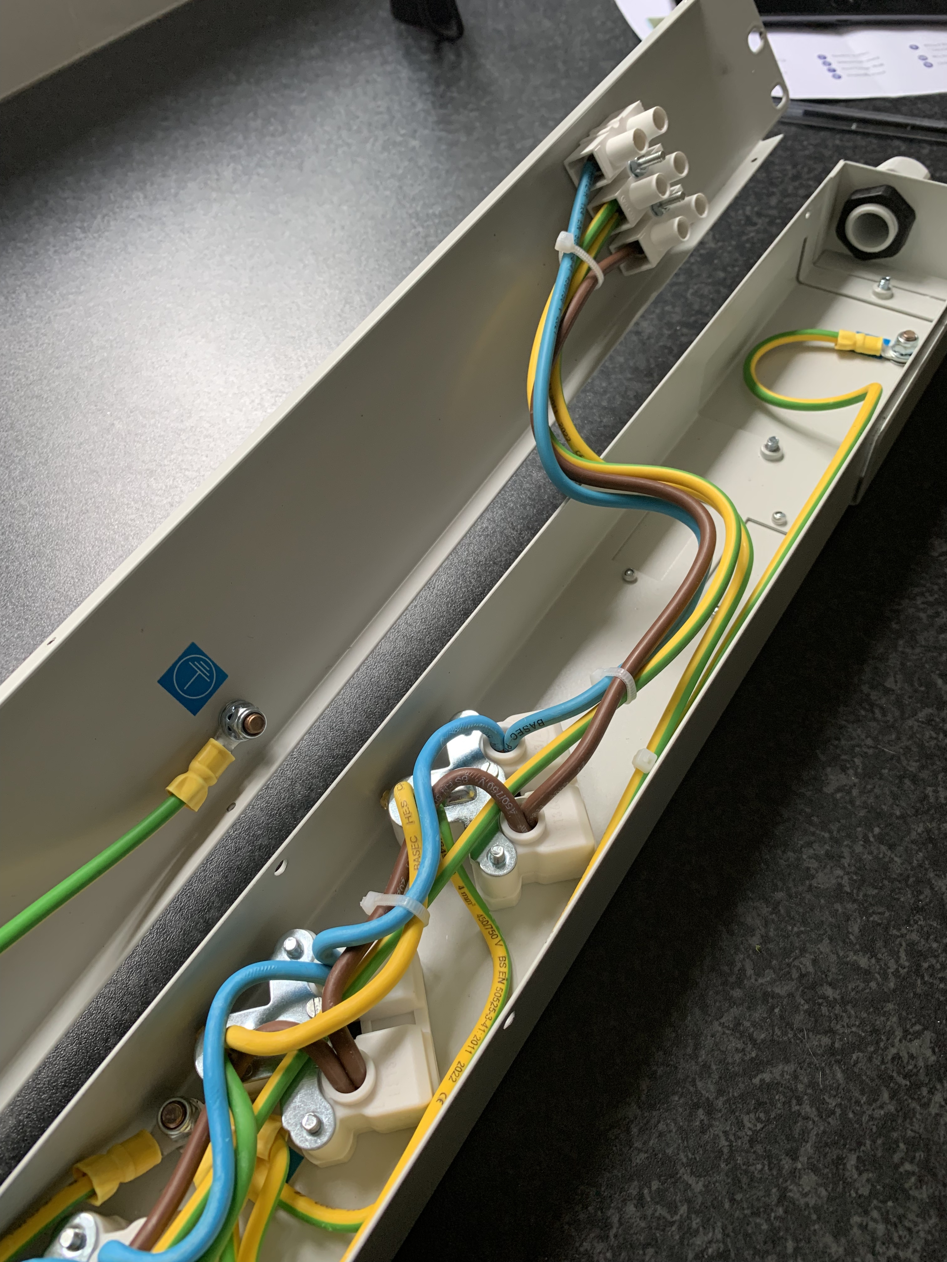

Wired up the Olson block this morning using a spare RA PowerMax cable I had knocking around in my spares box. Good quality build, 4mm2 internal wiring and every panel earth bonded.

I’m a huge fan of the Graham’s Hydra and also their mains blocks (I use both). Very nicely made, medical grade MK sockets, star earthed and they use Naim mains cable apparently in the Hydra.
I don’t know why on a limited budget people buy anything else actually! Much less faff than making your own too.

I don’t like using screw down terminals on multi-strand cable unless using ferrules. :+1:t2:
