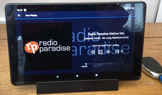

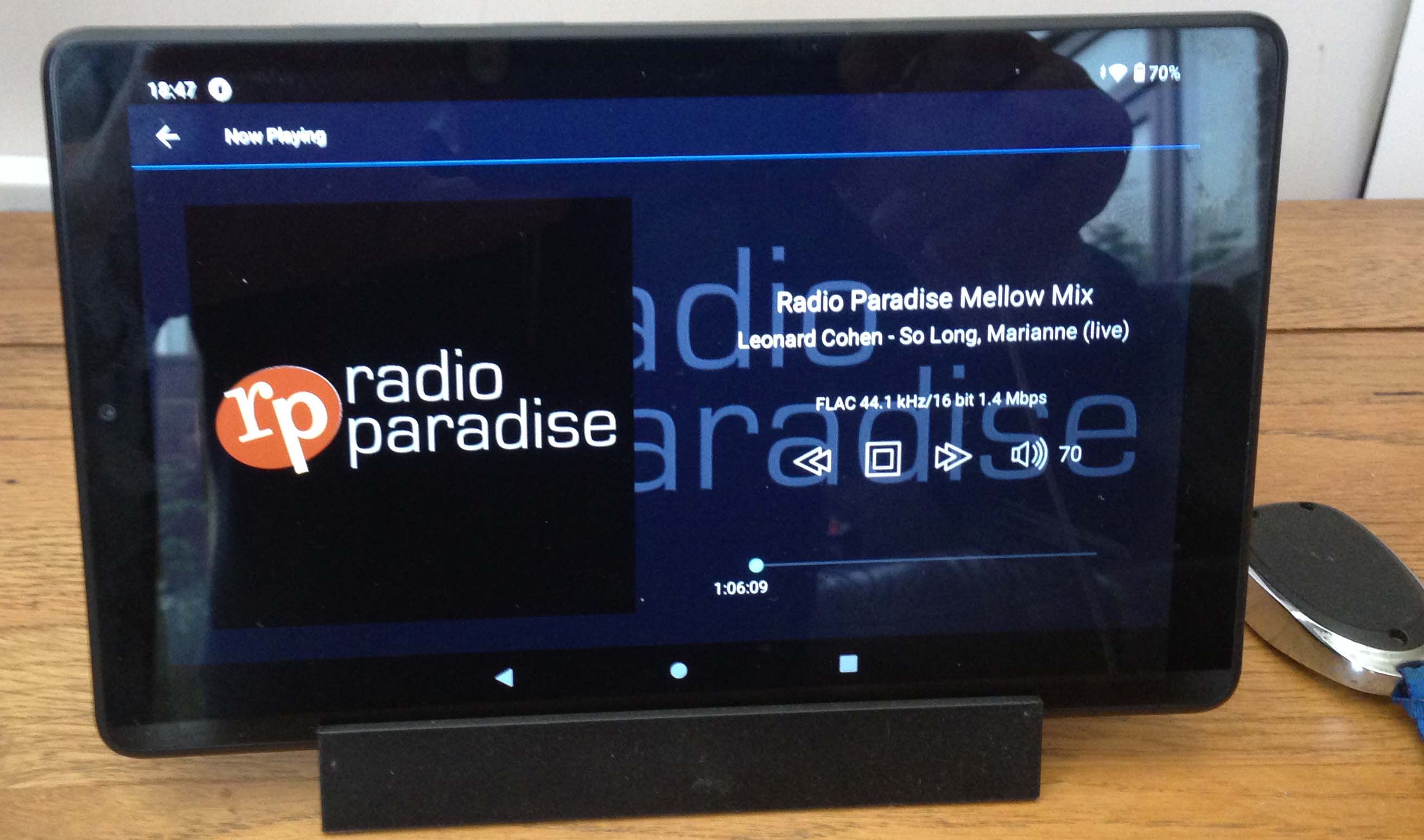

I did not know if it shows radio metadata or not so had a look. Had to turn display brightness up (as I had turned it down).
It is showing metadata on RP Mellow Mix flac channel.
Shut the cabinet again. Only look at the Control tablet - that shows me the metadata.
Ok, thanks for verifying that your Linn streamer handles meta data.
