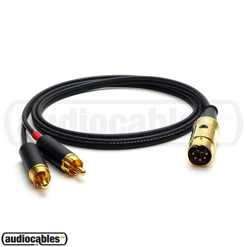

If the 0v of the left and right channel are combined close to the RCA end, (as shown in the photo Richard posted) it might be worth doing.
However, if the left and right 0v are simply combined at the Din plug (as photo below), it’s not worth doing if you’re using a SN3.
The cable I just got has the same type of construction as the one Richard posted, with the join close to the RCA end.
s-l300
