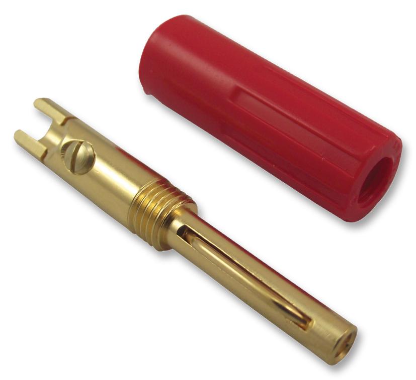

Currently on the speaker side the naca5 use this type of banana (first pic). Wonder if it might be worth changing to new Deltron in gold which I have on hand or if it is same same quality.

On the amp end it might but cannot fit them on the speaker end and the terminals is gold so I prefer to match metals in this case.
Itâs no problem using the Naim ones.
I would say that itâs more important how the Naim banana plug connects ( not being too tight),than having the same metal.
I use gold-plated Deltrons on the speaker end - Spendor A7s. All Naim at the 250 end. NACA5 of course
I use gold Deltrons at the speaker connects and Naim at the amp.
I prefer Deltron (the same design used with Naim) because they have a larger contact area in theory compared to some other designs, only bettered (maybe) by the BFA type.
I once used Naim nickel plated pins in gold plated speaker posts, the dissimilar metal mix developed an erosion problem, a grey dust/slime that looked to be nickel. The fix was completely new gold Deltrons and new gold speaker binding posts.

This is correct. But incomplete. The connection is more important. But the metal contact is not unimportant. And the Deltrons are very good quality. Easily as good as the Naim though a shame they donât do 90 degree solder on large bucket.
