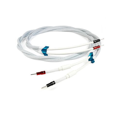

As I understand it the geometry of cables are what more than anything sets the specifications and that shot gun dual parallell design and slow twist ala Chord Music will give similar specs as say Naca5. At least within a range where you are in no trouble.

How would a litz design cable geometry look like that could potentially be dangerous causing high C? It’s not like this I assume (slow twist as Chord music)
