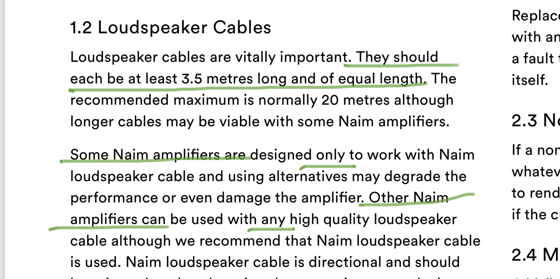

It might be more helpful if Naim would specify the requirements of the amps rather than providing the specifications of a couple of (their) cables that work. That would give people much clearer information to do their own homework rather than feeling the need to ask Naim.
Not sure why people keep talking about the amp design per se? As if accepting and liking it (and ultimately how it sounds - which we do!) also means accepting a poor job in explaining what it means for the user? So liking a brilliant design really isn’t the point. At all.

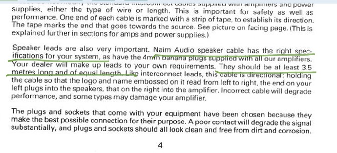

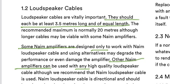

It’s what Naim provides as information and guidance to the user and the dealers as result of their specific design, and associated risks. I also notice people talk about THE Naim amp as if all Naim amps are the same … which they are not, and this seems to be acknowledged also in my SN3 manual - but it all bizarrely ends there, all for us to miraculously untangle and discover! I also know from my own humble experience that my Naim amps are not the same in this respect, for sure - yet they have pretty much the same guidance in their manuals, more than 30 years apart? Here:
My Nait2 manual:
My SN3 manual:
I wonder how difficult it is to improve on the above?
Btw can anyone tell me which Naim amp(s) can be used with any high quality speaker cable and what is a ā€œhigh quality speaker cableā€?
Should a forum be the place to expect to find the most important (and lacking!) accurate and clear manufacturer guidance information? If so, should this then not be mentioned in the manual? (unless I’ve missed it)
I agree that ā€œsomeā€ and ā€œanyā€ desperately need clarification. They can’t test every third-party cable but publishing the requirements and tolerances for each type of amplifier would help here.
