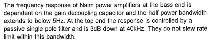

I’ve managed to find this Richard:
This relates to the CB & olive amps.

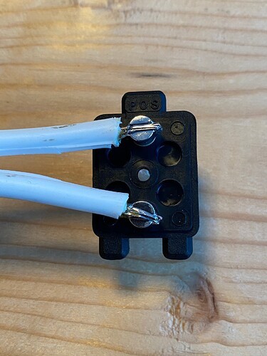

One step further in evaluating naca5. Clean cut on 6.8m wires and fresh solder on never used naim plugs. Drilled 4mm holes into a pcs of wood (the plastic cap was not on during soldering). Flux made it super easy for the solder to flush out. Took few seconds with a 100W solder iron. Most of the struggle went into getting the black back caps on again… I guess what one should do is to come in at an angle bending the copper wires to say 10 and 2 a clock.
Yep. As you say it makes it easier to get the cap back on.
Nice work though on the soldering :+1:

Peel them off some more .
It’s important that the soldering isn’t to high,if so it will touch the contact housing.
Your soldering looks pretty good, but there is very little room onside that black plactic box. I find it best to strip only about 10mm of the wire, and to not cut the web between them, so that after soldering you can bend the exposed copper out to fit in the holes. Then the remaining insulated cable still fits through the entry hole.
Also, you should ideally have the wires right down inside the slot. If they protrude above it, or if there’s a blob of solder on top, this can make it impossible to screw the box together.
This may all seem a bit OTT, but the black box should really be free of the cable, not clamping it at all.
Ah so when they twist to fit inside the back cap they turn and get closer to the sides yes. But I managed to close them and look correct so I guess this work is done anyway but thanks for the tip :+1:
As Chris SU described much better,the cable should not be clamped or touch…
