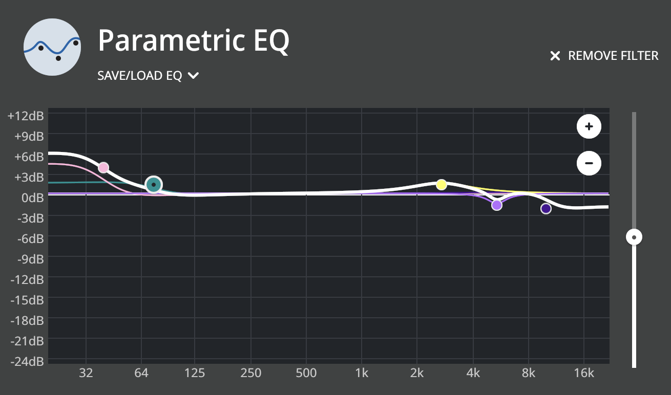

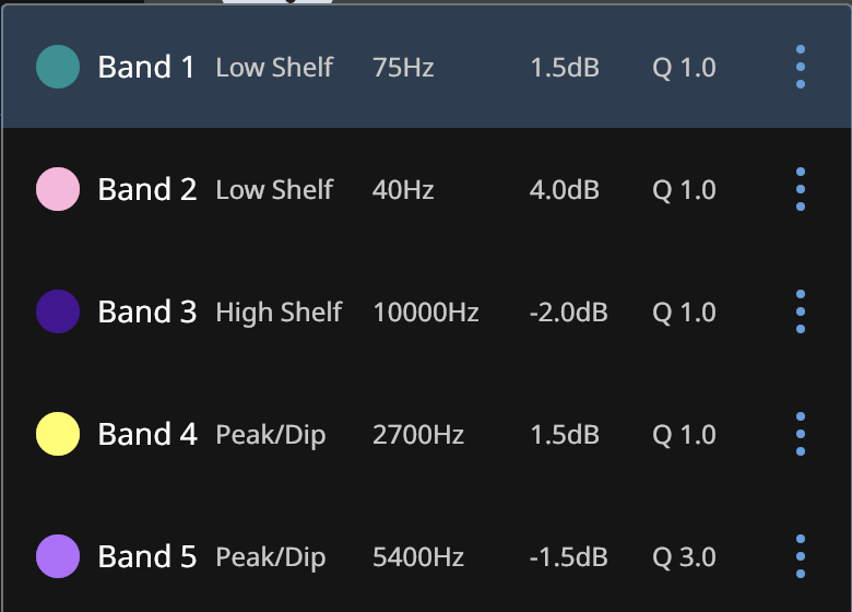

Here are my current EQ settings, which I tweaked based on ASR’s recent review of and EQ recommendation for the HD800s.
When you EQ headphones be careful with boosting frequencies too much as it can clip the preamp input. Looking at your graph I’d be tempted to drop the preamp input slider on the right so that the boosted frequencies are at 0db. You will get a drop in volume but just turn up your headphone amp. I suppose more noise might be introduced here but better that, than distortion.
Are you applying any headroom in Roon to compensate for the +in bass. ? Or as @adeypoos is saying you will get clipping.
Thanks for the tip, I haven’t noticed any clipping yet. My EQ adjustments to the HD800s followed recommendation by ASR’s review here:, but I turned everything one or two notches down, nothing exceeding ±6db.
I haven’t noticed any clipping yet, I did try with -3db in headroom, but there wasn’t any noticeable difference.
I would turn it on start at -3db and turn on the clipping indicator so you will notice in the Roon app if any is happening. It might be ok for some but you will likely get some that will clip the samples. I always needed it for any EQs I have made.

No problem - although recommendation from Crystal on starting with a -3db headroom adjustment is a wise one. That’s what I did as well (I actually started with -6db) but gradually reduced as I wasn’t experiencing any clipping to music.
