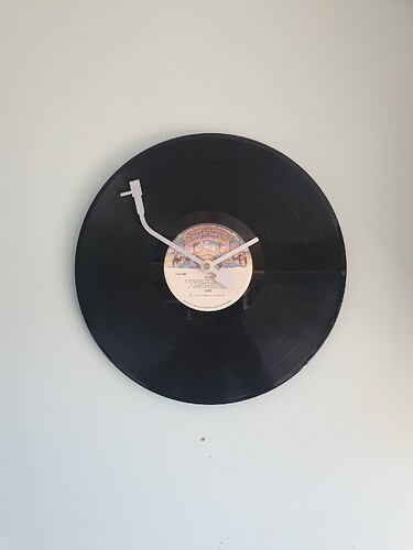

I’ve never thought of using records, even 78s, as room decorations - although I do see occasionally pictures of LPs being used as clockfaces - you just buy the hands and a mechanism that fix into place behind the record, which is then mounted on a wall.
PS I’ve just checked online. The thing is called ‘Vinyl Guru Clock Kit’. I’m sure that other brands are available.
I must admit that I’m intrigued, and may follow this up, if I can decide which LP to sacrifice - perhaps a very old LP of ‘Grace’?
AlieExpress is a good source of clock movements, this one has been working accurately for several years now.
