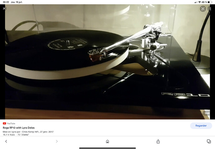

I would have said looking at your picture from the top, that the cartridge looks to far back, if the hole is for guidance on the stylus tip, but using the right set up guide is the only way to tell and its certainly what I would be getting to check it

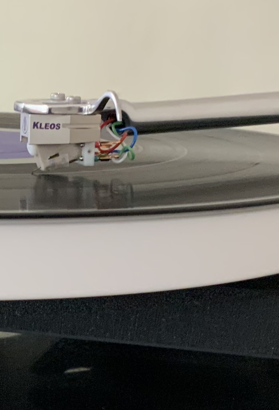

Lyra Kleos, set up by a dealer. Still on the back here. But on other pictures, it’s settled more on the front.

I can’t say if it’s make a real difference, but know now that it’s not correctly mounted.
I just could talk with the Lyra France guy. For him the arm seems not perfectly parallel ( on the picture) and I should see, through the little hole, the cantaliver. But I don’t see it.
I am embarrassed now. Have to find a solution. Maybe the Lyra guy will be able to come, but not sure.
I will have to ask the dealer to do a better job , if the Lyra guy won’t be able to come.
