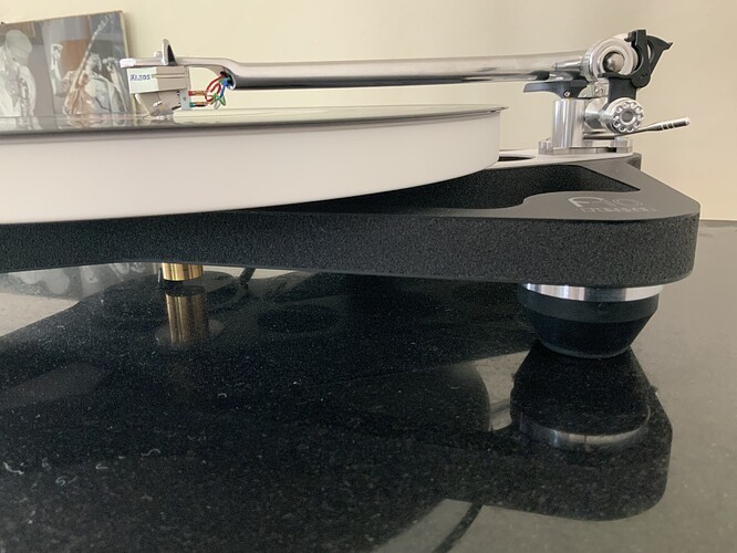

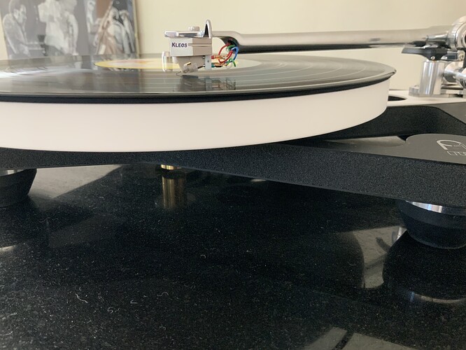

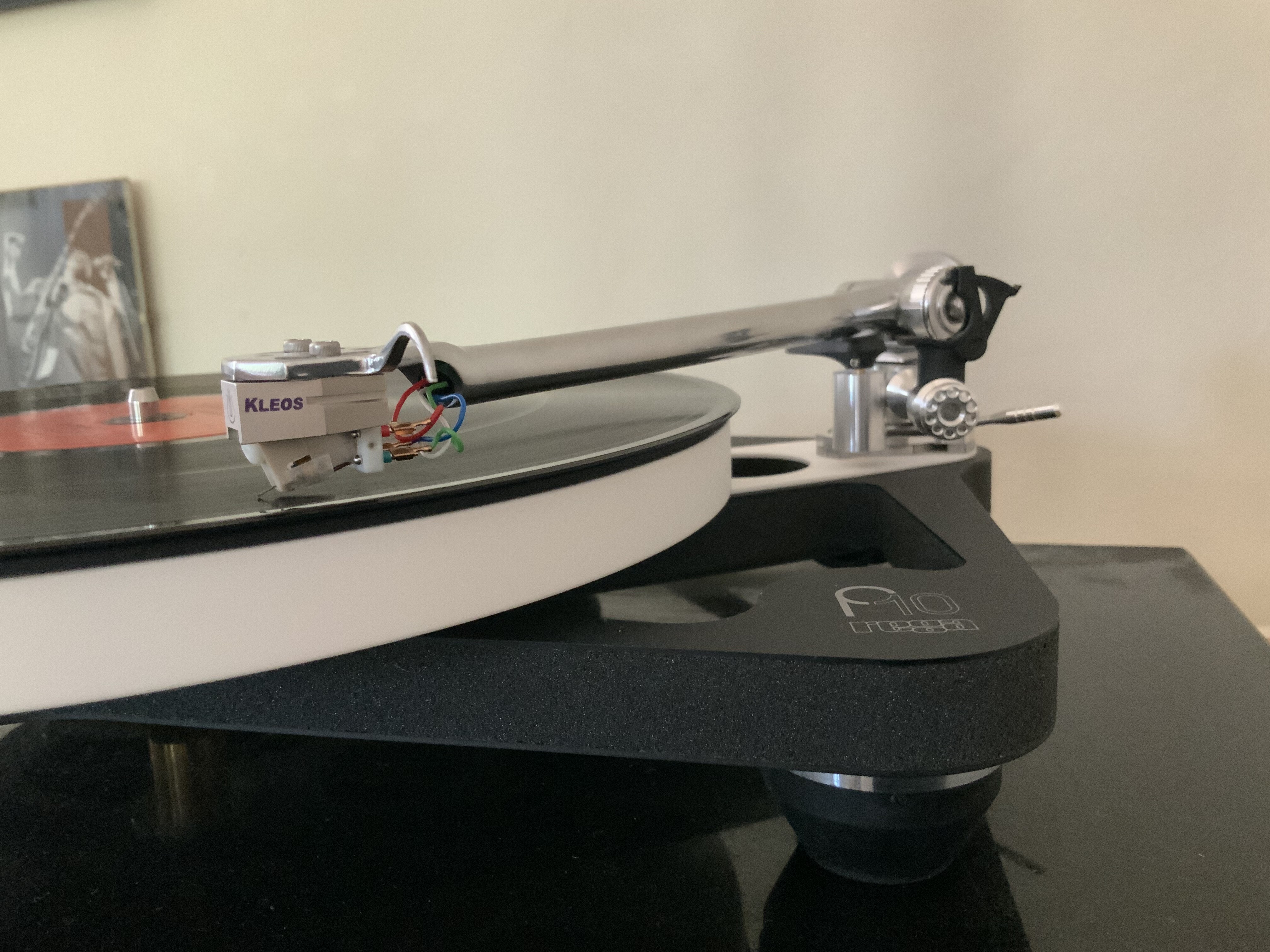

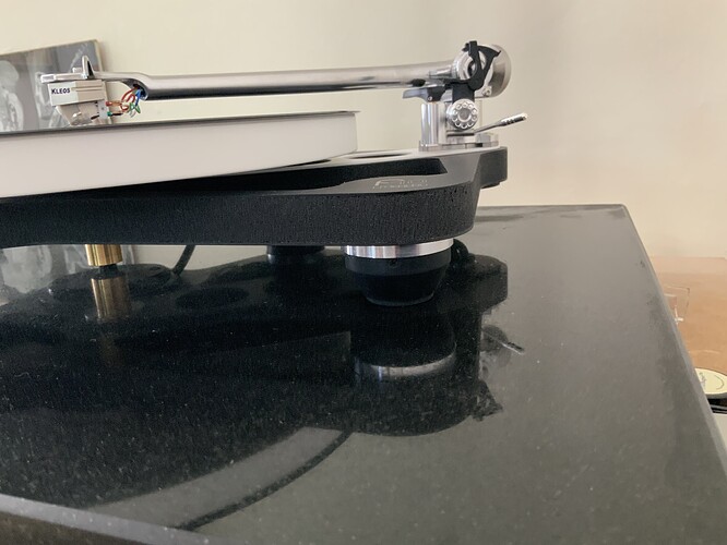

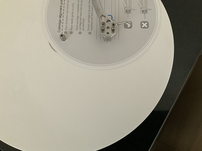

Does the arm looks parallel for you guys ?
Because with the Lyra, it should be completely parallel, due to the New Angle construction.
But it can give a bit better bass if slightly plunging.
I tried to balance it differently, setting VTF to zero and turning the counterweight. Maybe now it’s a bit better ?
The VTA of the arm depends on the height of the base (spacer), not on the VTF. However you set the VTF (just with counterweight or with dial), if the VTF it the same, the compliance of the stylus will be constant, and hence its contribution to the VTA.
- Ignore the arm height, at least…

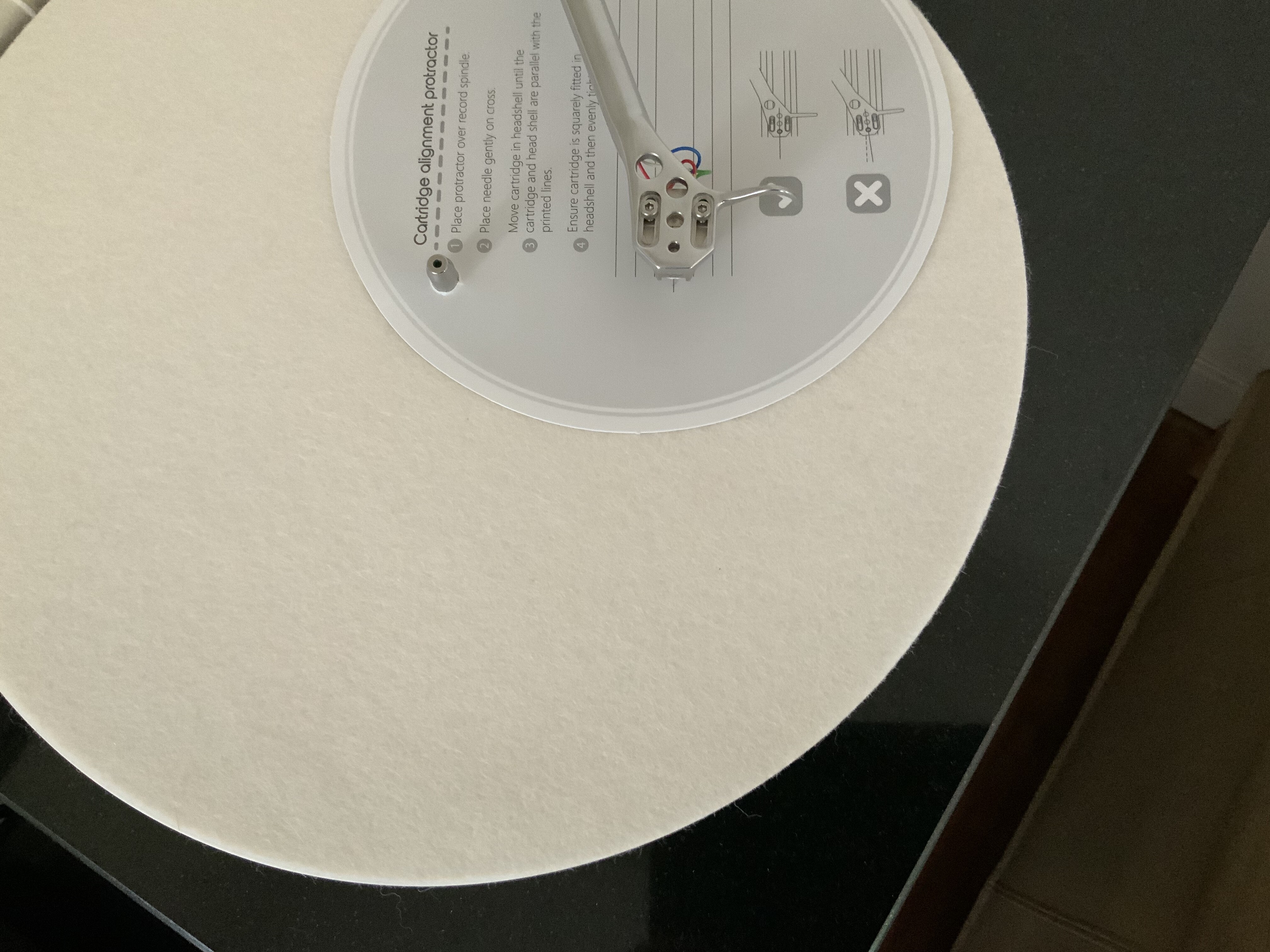

2…until the alignment is correct. It doesn’t look correct to me. The cartridge needs to be symmetrical in the headshell and the outer side of the headshell needs to be parallel with the lines on the protractor.
The outer side of the headshell does not seem to be parallel with the line on the protractor

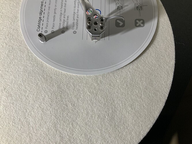

…better…I think that the cartridge needs to go back a tiny amount, and make sure that it is parallel in the headshell
Apparently a tiny on the front. I think I can’t do better.
Oooops, my mistake…I think that the cart needs to be a tiny bit more FORWARDS in the headshell…you are nearly there!
Now you’re just being cruel
That makes no sense. All alignments, on any arm, are only perfect for two points (arm travelling in an arc). The arm is actually irrelevant here, any alignment can be used. Arms do often have the headshell aligned for a specific one. In the case of Rega that’s Stevenson. As a consequence using another one will have the cartridge sitting not straight in the headshell, but that’s just visual with no effect on SQ. (Not technically true for S shaped arms BTW, but I doubt it would be audible)
@frenchrooster Well done for trying! But as mentioned, with your choice of music I’d consider trying Baerwald or Schon at some point. And now you’ll know how to revert if you don’t like it ![]()
Nearly there…remember, we are dealing with a precision device.

I will try nothing more my friend. I have done my best. But thanks however. If you want to play with different set up methods, you are my guest. You are invited at my home.
