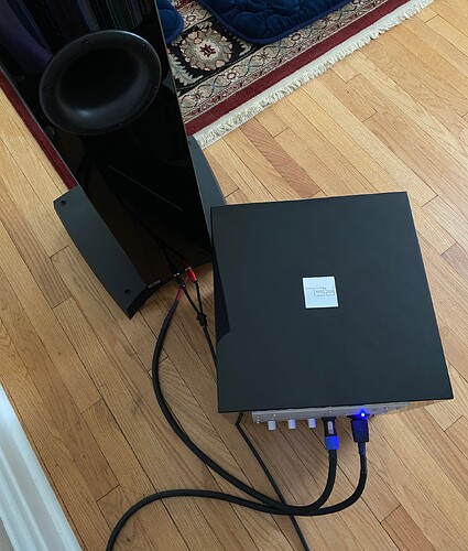

Rel Bassline Blue Naim Bannana Plug Connection?
Glad to help.
I haven’t ever used Bassline Blues. I have some Signal Cable high-level REL cables which are nice (you can get them as mono cables, and/or you can get them with spades). But otherwise, I either use the stock REL high-level cables, or my own custom made (mono) cables for dual subwoofer configurations.
The non-Naim Bassline Blues should work just fine connected at the speaker ends. However, in a dual mono subwoofer configuration, you don’t need the two separate positive leads (Red & Yellow), which are summed by a single, stereo REL subwoofer in single subwoofer configurations. The choices are:
  1. Connect both the Red & Yellow leads, of each high-level cable, to the corresponding speaker’s positive binding post. This may be doable with spades if your speaker’s binding post can accomodate a pair of stacked spades.
  2. Use only the Red OR Yellow lead, of each high-level cable, to the corresponding speaker’s positive binding post. This is fine because you don’t need to sum both the left & right signals to a single subwoofer, when you use a dedicated subwoofer for each channel. The input to the subwoofer will be a few dB less when using just the Red or just the Yellow lead, but that should be fine. There is one possible minor disadvantage, as explained to me by REL Support, in that the floating positive lead can act like an antenna into the REL amplifier. They advised that it is best to disconnect the unused positive lead at the speakOn connector side (trim or tape the disconnected lead to avoid shorts). Not something that you should mess with unless you are comfortable doing so.

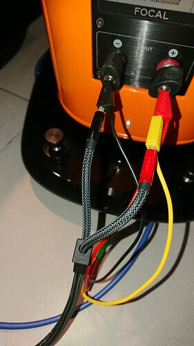

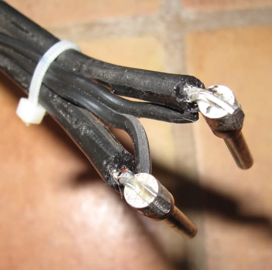

An ideal might be a solder-on 4mm plug with a side entry available for the non-critical sub connection.
When I had A5 and a sub I just ran some QED 42 strand (or similar) piggybacked at the speaker end.
Not sure how proud I am of this but:
Fortunately, my speakers feature WBT cable connectors that have both banana and spade receivers. I use the bananas for my speaker cable, and spades for my REL cables.
I would just use spades on speakers that give you both options, as those Focals do. Worked well on my Kudos speakers too with an N-Sub. Failing that your soldered solution would be my first choice. It doesn’t mater what it looks like if you can’t see it, although I can see that hacking into a pair of Super Lumina cables to do that might be a step too far for some.
