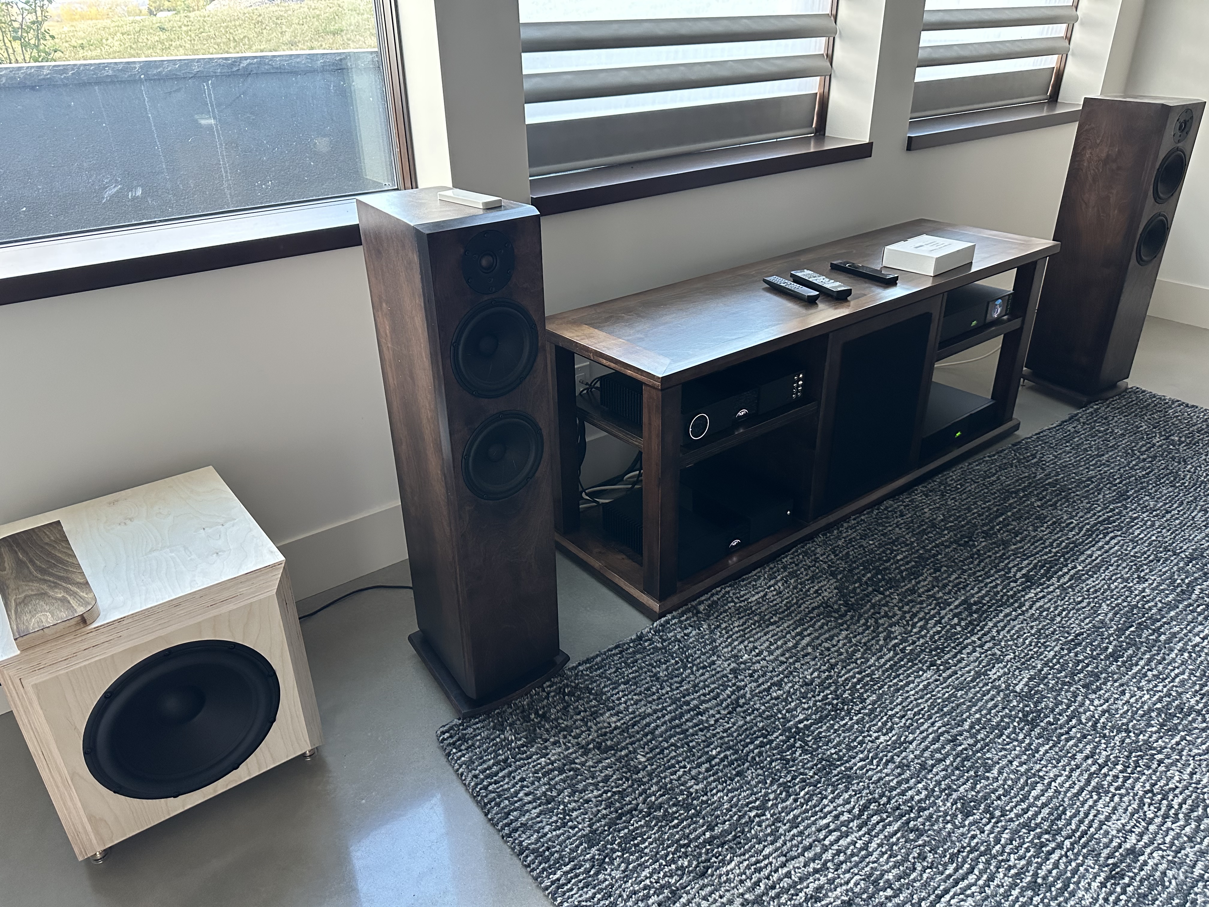

Hi Dan, I can only imagine how good the subwoofers sound on your system. I wish I could hear them. What are you crossing them over at? I recently had the urge to get some high end subs so I got back into DIY and I’m just testing out my newly built scan-speak revelator 13” sub. I have one built and working on the second. Considering the success I had with the sound quality of my homemade speakers I built 10 years ago I figured I might as well build the matching subs. I have some new found respect for how good these old scan-speak speakers sound. They might even be better then my PMC twenty5 24i. The new sub is very impressive as well. They blend together very well. My main speakers are sealed 2.5 way with a very flat frequency response down to 50hz, so I have the low pass on the subs at 60hz. I cannot wait to get the second one hooked up.
Cost wise it would have been cheaper for me to get the REL’s but then I’d always be wondering about the scan-speaks.
It wasn’t until after I bought the sub amps though that I read that Naim doesn’t recommend using the RCA preout at the same time as the balanced output on the NAC 332 due to reduced sound quantity. My 1000W sub amps have only balanced inputs and RCA, no speaker level input. I’m using the RCA pre-out so hopefully I’m not sacrificing sound quality too much. I’ll try not to worry about that too much as it sounds pretty darn good.
Nice job, your speakers kind of remind me of Dynaudio I once owned, is that what you based them on?
Yes, the Dynaudio Focus speakers are a very similar shape. The sides are tapered towards the back of the speakers. They are a very warm, detailed snd smooth sounding speaker and the Naim amps add the right amount of excitement to them. The PMC’s can be a bit to much on some songs in comparison especially with female vocals sounding somewhat artificially bright in comparison.
These same Scan-speaks are used in Wilson Audio speakers.
