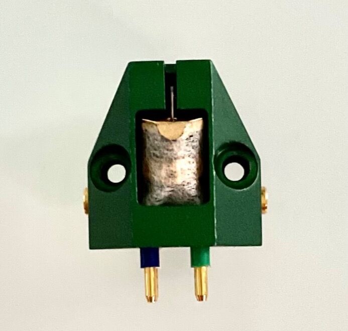

Replacing Washi paper with Lyra Lydian
Many owners of Lyra heads are faced with an unpleasant moment, or rather, with contamination and wear of Japanese Washi paper, which is installed at the factory and acts as a boot.
This problem also affected my Lyra Lydian. Decided to figure it out. Since this paper comes in various types, textures and densities, and there is absolutely no information on the Internet, I had to turn on the deductive method and look for the right one, the one that was on my head from the factory, fortunately there were small fragments thereof on the cartridge. In general, paper of various textures was put on Lyra, which can be seen in numerous photos on the net, therefore they did not adhere to any strict standard.

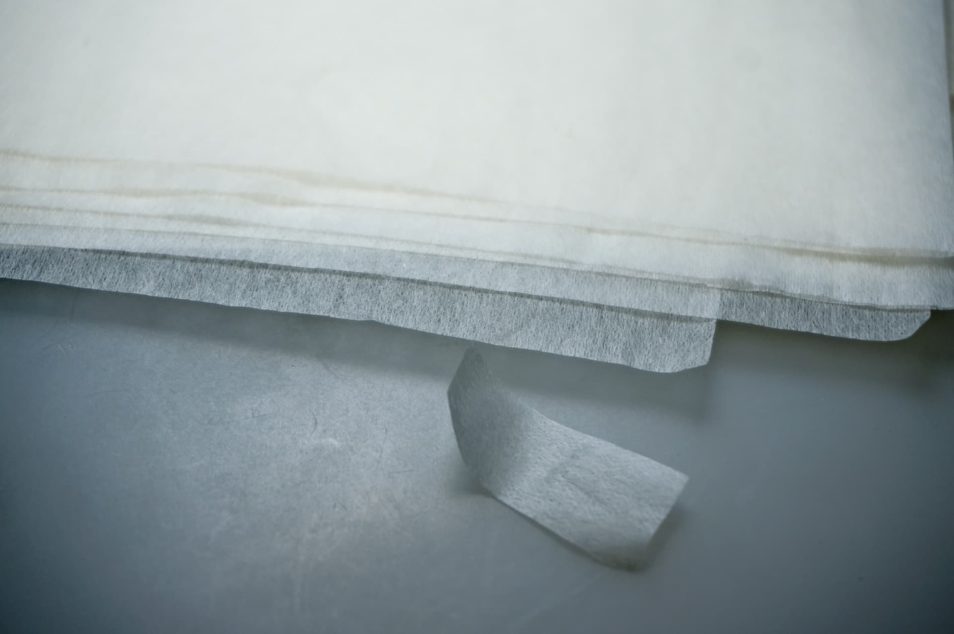

Japanese Maruishi silk paper, a high-quality hand-cast restoration paper from Japico, was selected.
Ingredients: 100% manila.
Density 9 g/m2.
The texture and density are exactly the same. Kuranai natur (9 g / m2) was also suitable, but it is a little yellow, not bleached. For gluing, I chose and used a non-toxic glue stick for paper and fabric. You need an invisible amount on the tip of a toothpick. I applied it to the old places of gluing. It is important to use only non-magnetic tools.
In general, the work is not very difficult, but it requires a certain restraint and maximum accuracy.

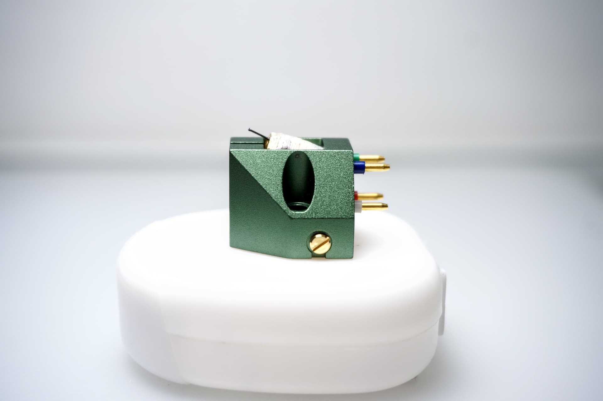

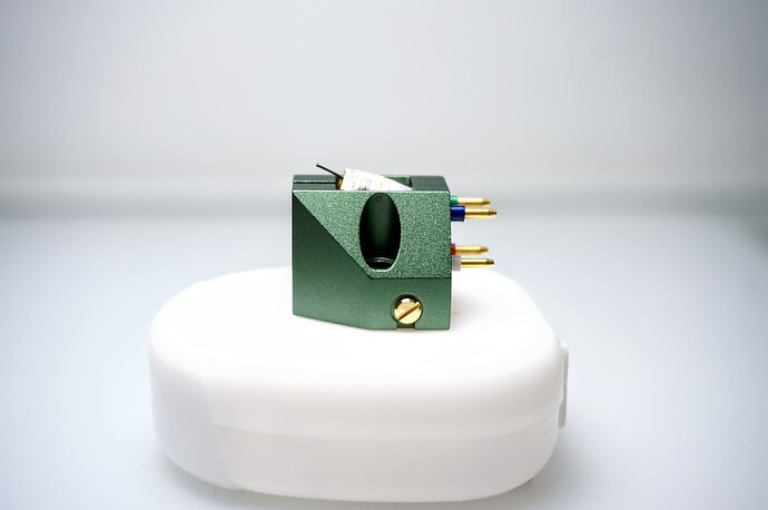

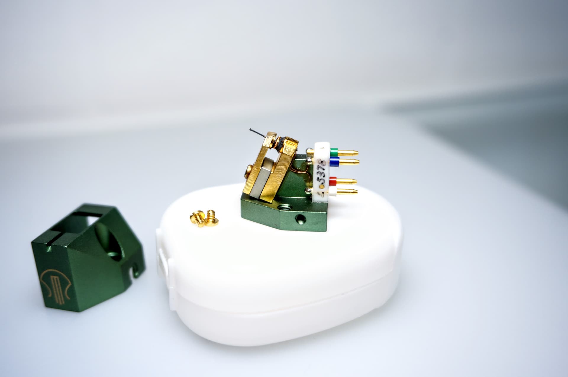

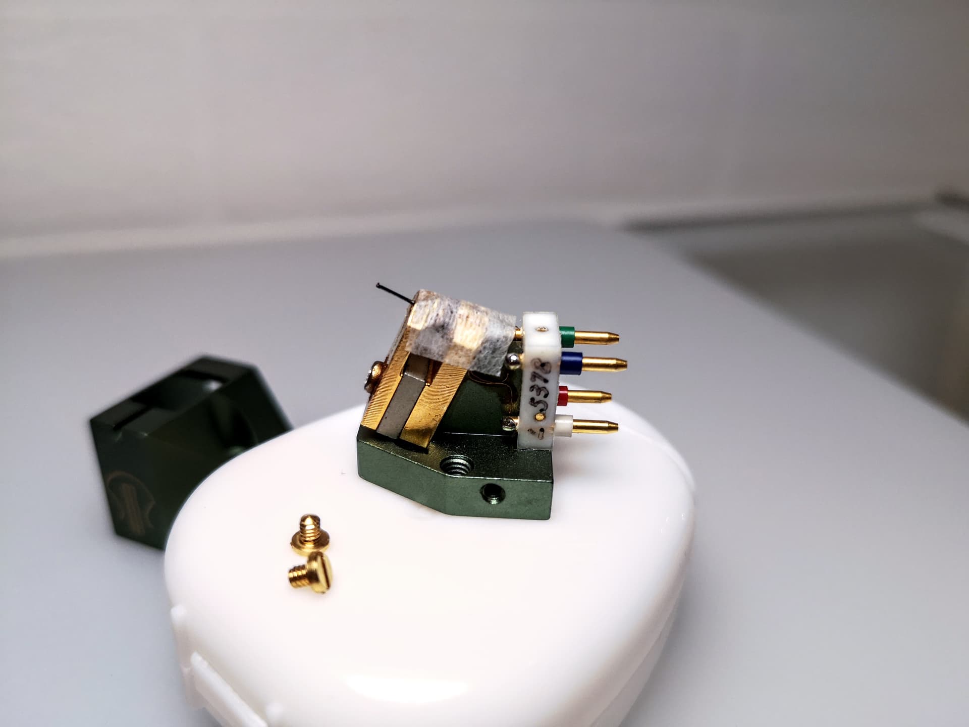

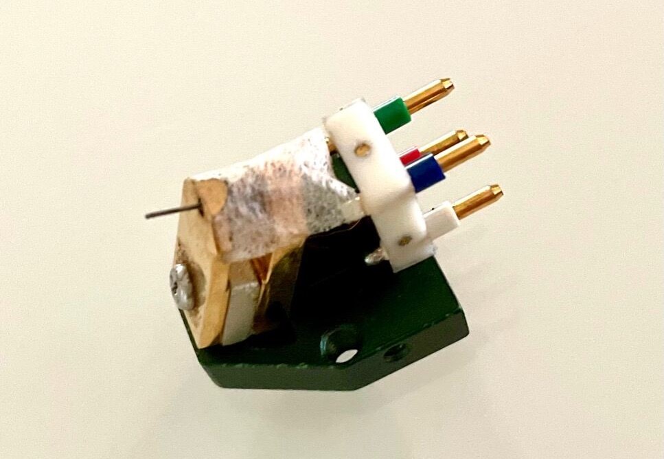

I hope that this information will be interesting and somewhat useful. Photo:

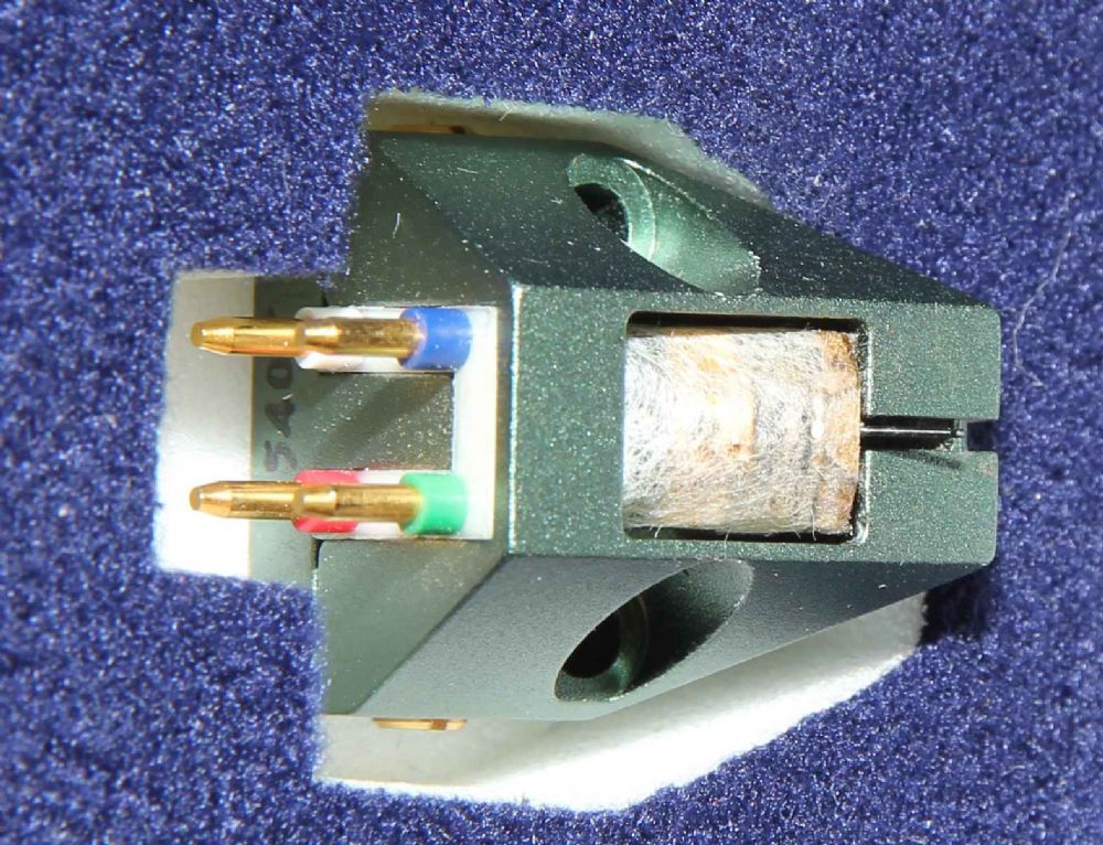

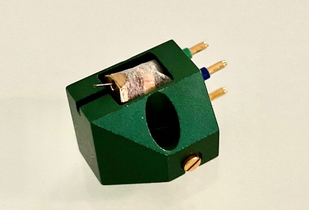

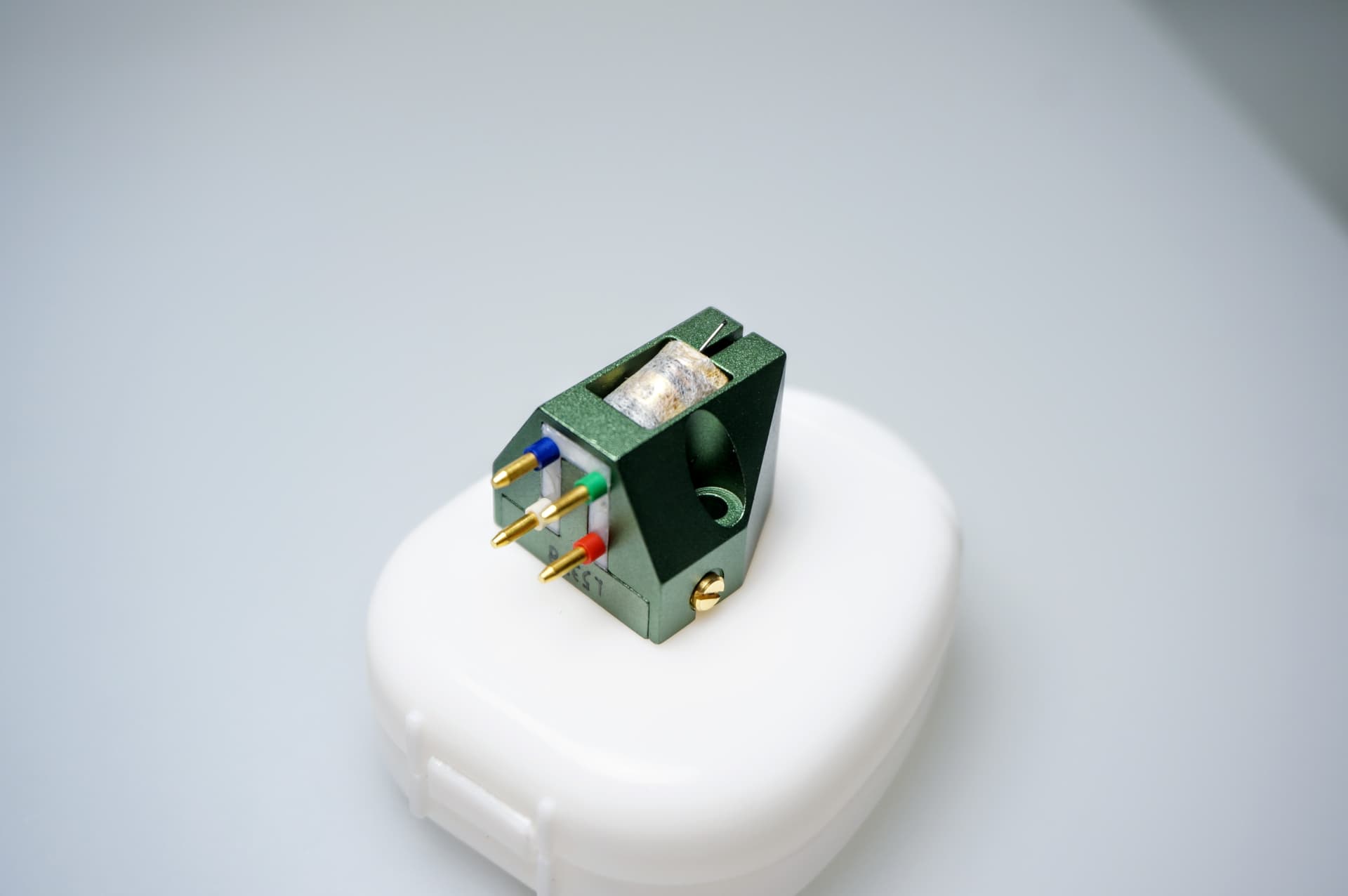

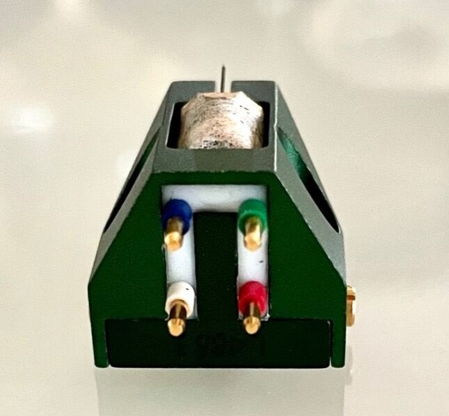

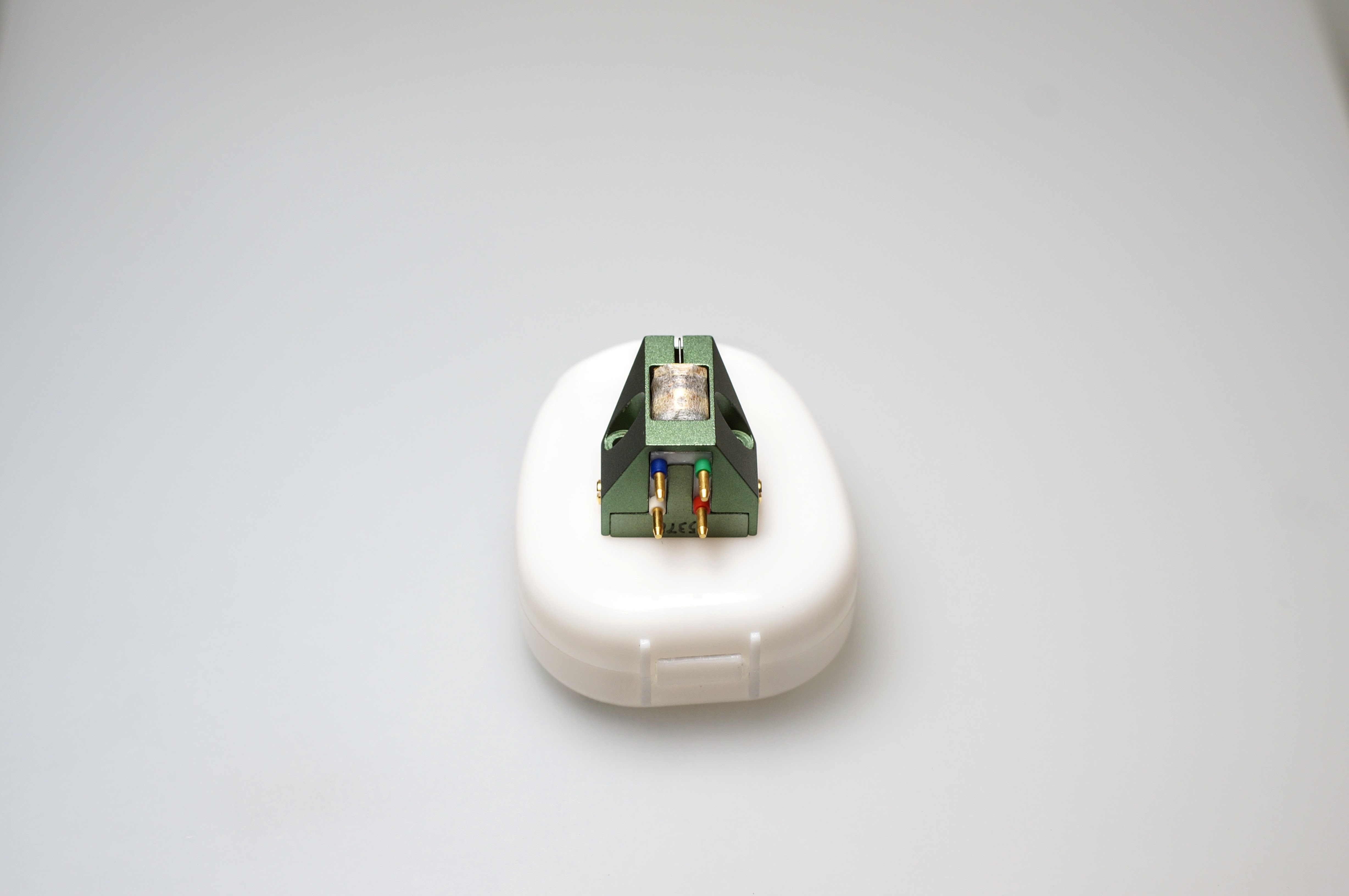

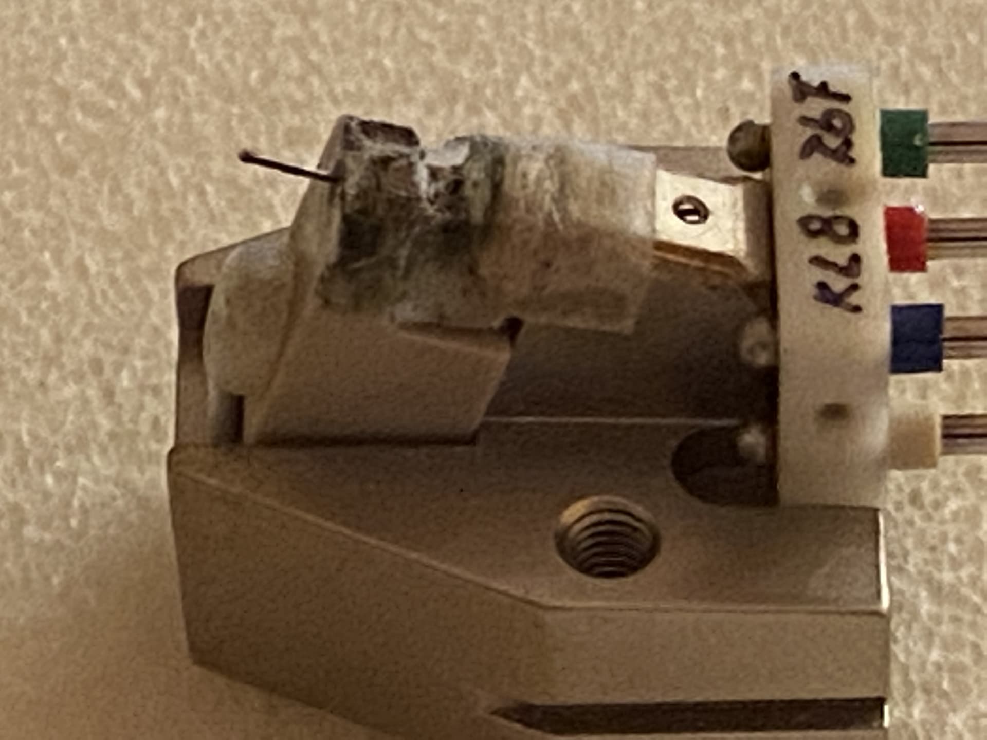

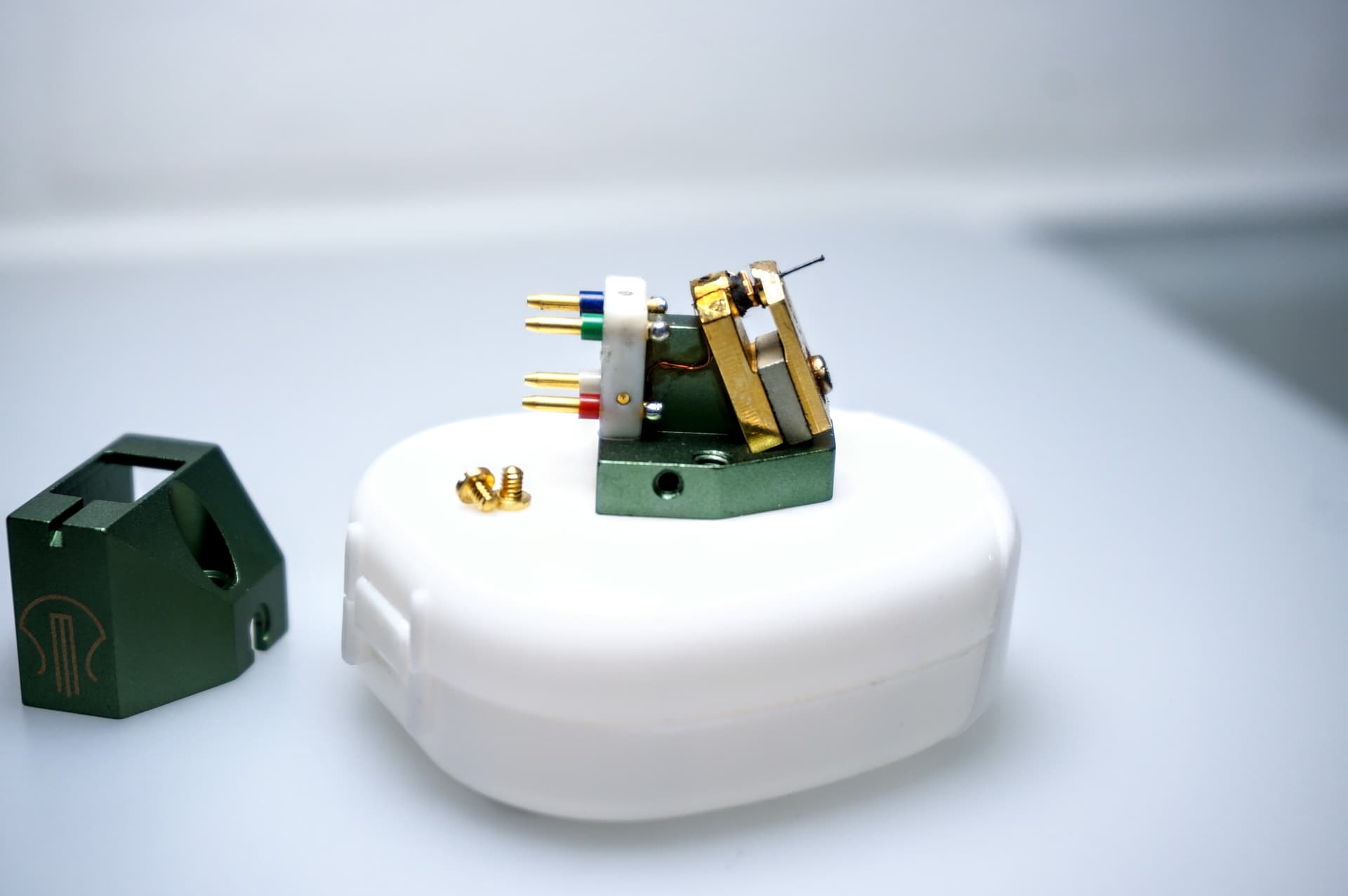

Old Washi removed…

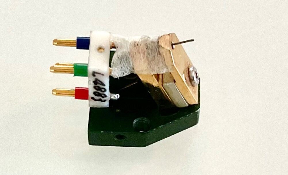

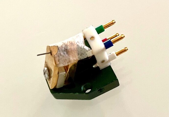

New paper installed…

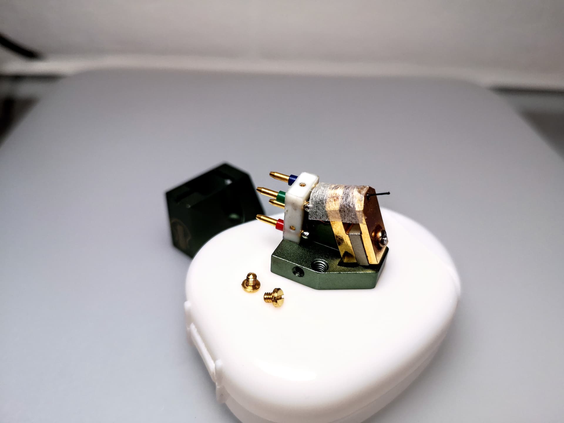

With casing…

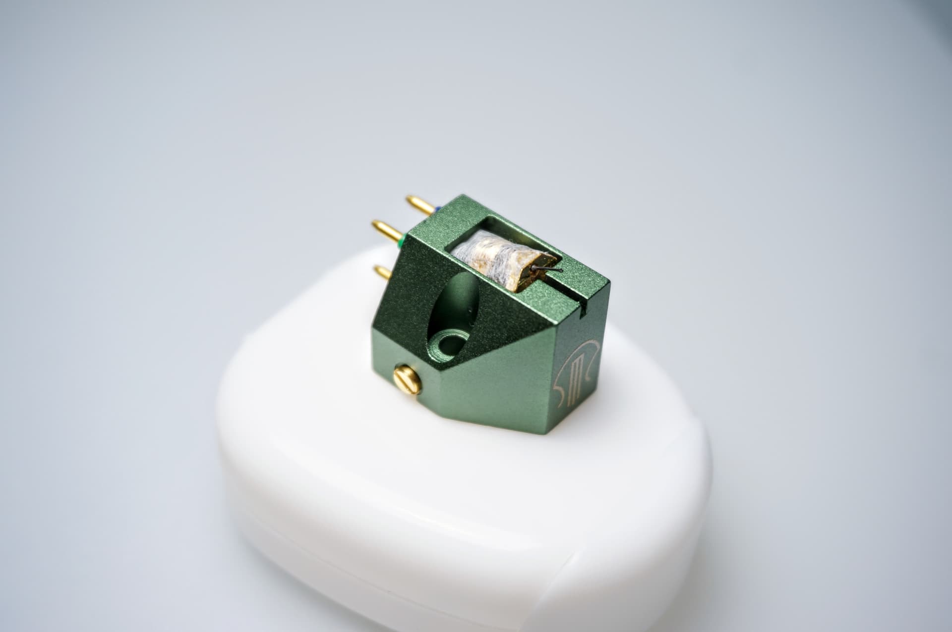

In its place…

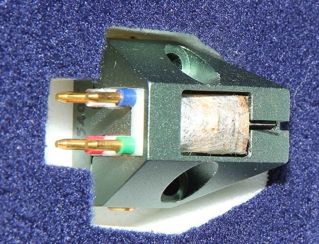

For factory comparison
Sorry for my English, I used a translator :wink:

Thanks. I didn’t notice any obvious difference. The weight remained the same.

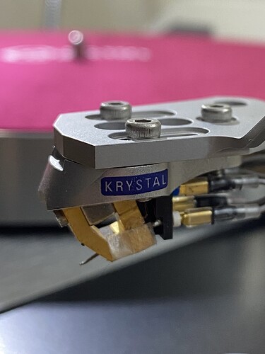

Does the Linn Krystal cartridge have the same as it does look very similar?
Agree your comments about the job/neatness.
Don’t know about the Krystal but my Kandid certainly appears to have Washi (or similar) paper fitted.
