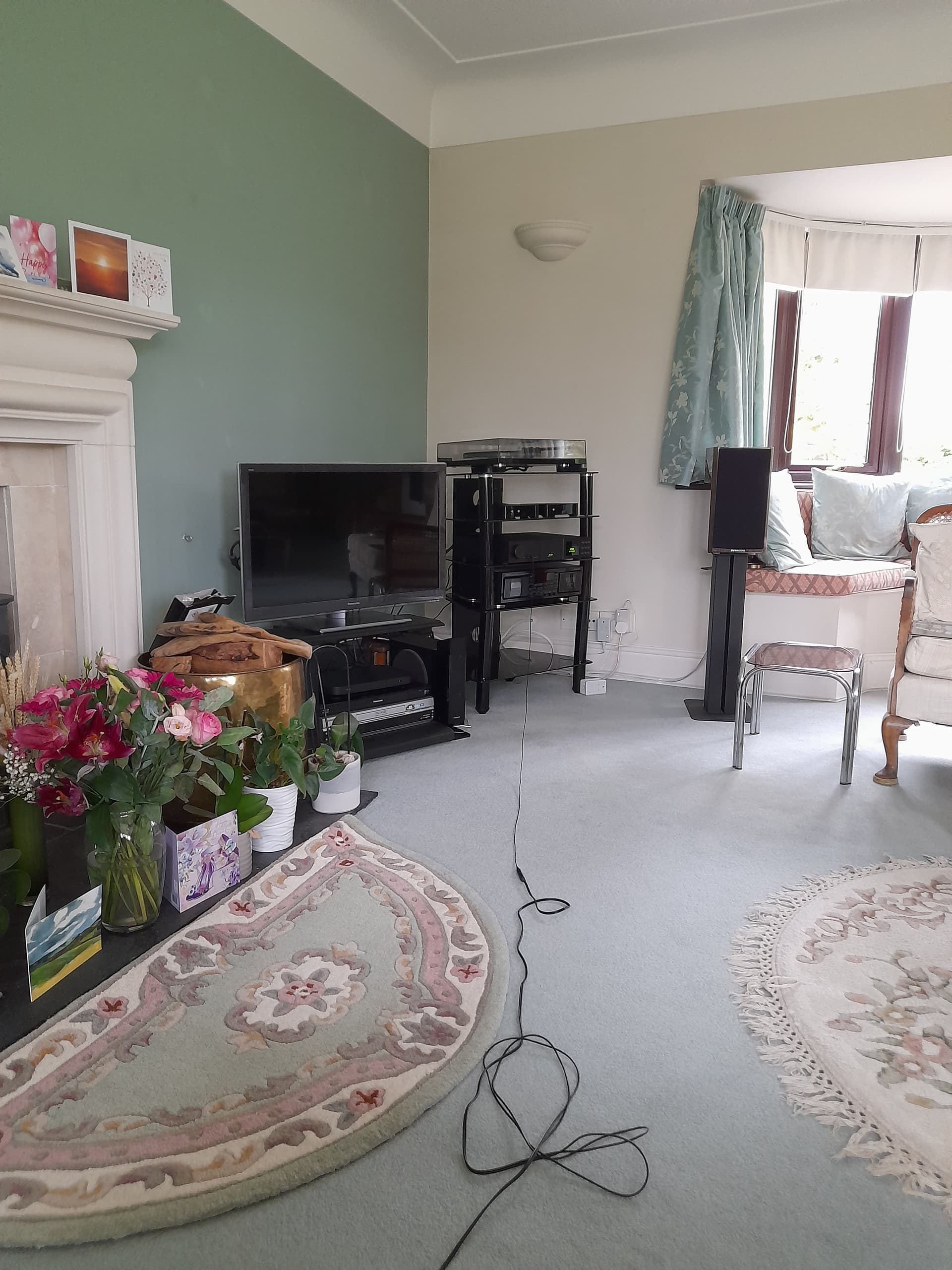

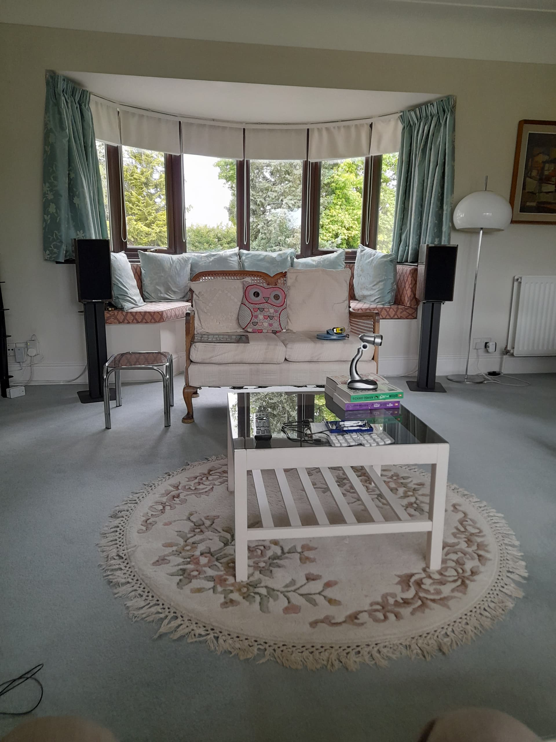

I agree with some comments already made, given the layout of room and distance from some of the listening areas, larger speakers may be required… also slightly curious of the concave window between the speakers and what that might be doing to the sound… does the sound change much if a tick curtain is (temporarily) draped across that window bay? Concave structures can amplify … and is that concentrating certain frequencies ?
Maybe all of the soft furnishings between & behind the speakers are absorbing all of the low energy and warmth from the presentation. I’d be inclined to completely re-site the speakers or maybe introduce a sub near to the listening position.

As Simon mentioned, I too was wondering what limits the current speaker location may be having - I’m not entirely sure from the curtains if there is solid wall behind them, but there is certainly a large void created by the bay window arrangement.
This may not be helpful long term but I would be very tempted to temporarily place the speakers along a solid wall - I emphasise temporary!! Then check out the manufacturer’s guide on their speaker optimal location - from walls, seating location and between the speakers themselves. Whilst maybe not a permitted location, it would at least allow you to understand what your system is capable off. It may sound how you would want it or it may still sound relatively ‘weedy’ and at least you will have confirmed if an inadequacy exists in your system.
Too many words but the exercise I’m alluding to would take no more than an hour, provided your speaker cable length permits.
If you can’t for whatever reason do this, I would strongly suggest not to take punts on new components until you have had a good opportunity to listen to them in your room before purchase. This could save you a considerable ££ by avoiding components which may not improve your system in your room.

My guess is that your speakers are too small for your room, and you’re also facing suboptimal speaker placement and listening position.
Assuming your chimney is centered in your room, I would start with placing your speakers on each side of the chimney, 3 ft away from the rear wall where the chimney is, and each speaker placed 4.8 ft away from the side wall (Golden ratio: distance from side walls = 1.62* distance from rear wall). It should give you more warmth and it should even bass response in your room. It has worked wonders in my room…
If it’s still not warm enough to your taste, maybe try small floorstanders. Neat sx2 (but maybe slightly too small), Dynaudio Evoke 30 or Sonus Faber Sonetto III come to mind.
Thank you for this Glen. Reorientation of the listening space is a non starter, but I think repositioning of the speakers could bear fruit. I’ve just been reading the on-line user manual for the s40s. They recommend not less than 0.5m from back and side walls, with no upper limit. I can achieve that, but I’m waiting for some new Chord speaker cables, which will give me the flexibility to experiment. They also state 2m as being the optimal speaker separation distance, which I already have.
These speakers have had rave reviews and I doubt that I need bigger cabinets.

I tend to think the same as said above. The room is too big for these bookshelves.
The consequences are a sound lacking meat on the bones, textures, bass. These later give density and richness to the sound.
Maybe listening much closer, as at the place where sits the table, could give a richer sound.
Or change the speakers for floorstanders.

Oh, with a room that big, you should try the speakers further out in the room. And listen closer.
The sub most possibly wasn’t in the right place then.
Your dyno’s may go down to 41hz but they are probably not doing that IN YOUR ROOM. You’re going to need to experiment and move them around.
