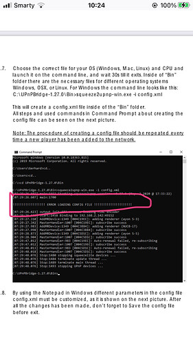

From what I’ve seen, it says “error loading config file” regardless. Did it actually make a config file for you?
Eg instructions provided by Ayon
Yes it did. I then change the parameters as suggested, I still can’t locate my NDS.

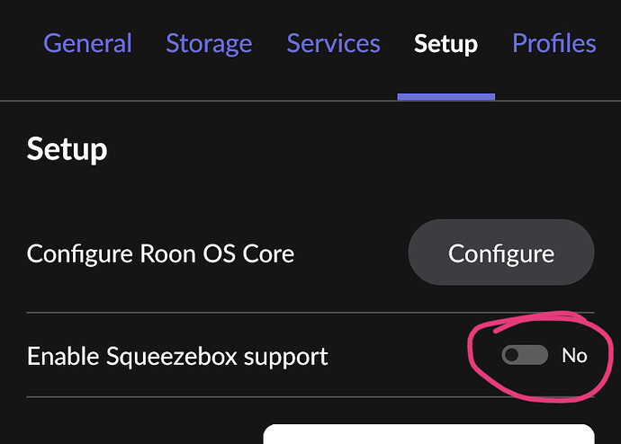

Did you enable squeezebox support in roon?
Double check the instructions listed here

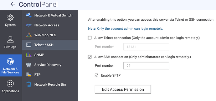

    You need to enable SSH access on your QNAP from the control panel
  • Use WinSCP to connect to the QNAP (use your admin login, same as you use to administer the QNAP in a browser).

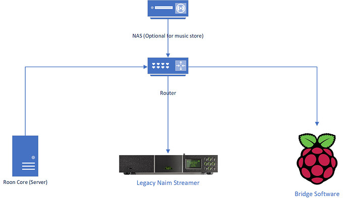

I suppose what I looking for are simple line suggestions of what inputs into what & how, either physically or via the network.
In the bridge configuration the Pi is receiving the music from the Roon server and bridging or transmitting it on to the Naim streamer. This overcomes the limitation that Roon cannot communicate with UPNP devices, only ones that directly support Roon.
To bridge you can either use
  • Dedicated hardware bridge - e.g. Sonore UPNP Bridge
  • Bridge software running on a computer or Raspberry Pi
To serve Roon you need a Roon Core. This is a bit like a UPNP Server and would take the place of say Asset or Minimserver if you currently use these.
You can run Roon Core on a variety of devices, e.g. Mac, Linux computer, Windows Computer, some NAS devices (not recommended by Roon), a Roon Nucleus or a Roon Rock which is a dedicated device that you can put together. There are some other devices you can use so this isn’t a complete list. Note: You cannot run Roon Core on a Raspberry Pi.
To use a bridge a typical setup is shown below, obviously you would have other devices on your network and a device like an iPad that you would use to select your music.
You can see that everything is interconnected on your network. Nothing connects directly to the Naim Streamer except for a network connection.
There are means to use a Raspberry Pi as a Roon endpoint. A Roon endpoint is just a fancy name for a streamer. You could for example but an end point with a digital output that feeds into the DAC in the Naim streamer.
Personally I would use a bridge solution as the performance of the Naim streamer is left untouched as it is unaware that Roon is sending the music to it so it will perform as it does now from a sound quality perspective.
Hope this helps
Hi thank you so much for the schematic, it was exactly what I was looking for, and clearly explains how it is all set up.
