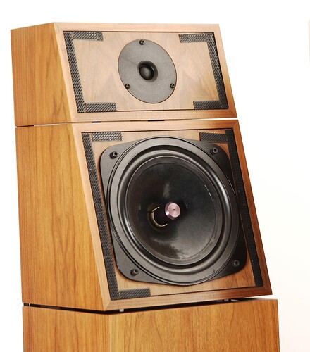

The later Naim-built drivers can be easily distinguished from the earlier Mordaunt-Short units by the basket surround. The M-S drivers used a pressed steel basket with curved edges and a thin lip. The Naim drivers used a cast alloy basket with a flat outer face and with two of the four sides being straight edged (there are other differences under the skin too, such as the phase plug being used as a heat sink for the coil on the Naim unit)
This image from the 'net (courtesy of Springair) shows the later Naim mid/bass drive unit;
