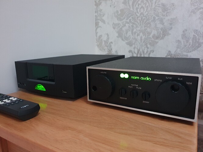

Just found this. They look good together imo. I think the opportunity to upgrade with some classic Naim units and have all the functionality of Tidal streaming is very appealing.
Height might be different but I think width is the same. Sure I’ve seen a photo of uq2 plus nait2 somewhere…
Found!
Borrowing:

That system looks familiar! Both still in use, and UQ2 on (local) streaming duties feeding my freshly serviced Nait2.
Agree with Chris’s comment, if you plump for a used UQ, then I’d budget for a NAP100 to power ATC speakers.
Yeah I found and linked your post, I think it looks very smart together. The UQ2 might be my favourite naim box.
Many thanks. Agree, I like the visual contrast of the pairing, and they both sound rather good together - the UQ makes a surprisingly good transport.
Yes, the UQ, it is a superb little box of tricks, and after owning quite a few Naim items over the years, the Nait2 and UQ2 are two firm favourites.
