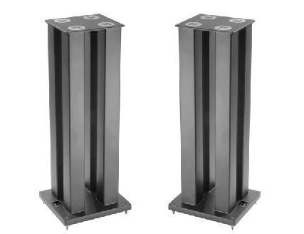

I used some custom made open frame stands with T10s and they worked really well. They were fixed with tiny blobs of blu tack, and came off after two years with no marks whatsoever. I rather like the look of the Atacama NeXXus 600. You can get them with a bigger front tube, and a horizontal top place designed specifically for the T10. I really wouldn’t worry about the IsoAcoustics, which are hardly essential. With the Atacama you can get a lot of Atabites in the larger tube, which is useful for the T10.

Thank you. In my country the importer only has the atacama nexxus 600, and not the other stands like HMS. I dont think we have the larger front tubes as well. Would there be a significant difference between the nexxus 600 and something like the HMS assuming they are both filled with atabites?

There is also the « Foundation Designer mkII » stand

Thank you all. I mightjust go with the nexxus 600 and atabites as my dealer does not have the HMS. Would i just expect the bass quantity to be lesser? Also would i need the custom top plate or is this just for aesthetics?

The HMS with the correct top plate was discontinued ages ago. The next best thing is the Nexxus. It comes in three versions, normal tubes, thick front tube, thick both tubes. You absolutely need the correct top plate, as it’s wider but less deep, sized to fit the speaker. It is not possible to fit this top plate if you have two thick tubes, but it fits either of the others.
The one you want is what Atacama call Hifi Audio, with the 180mm wide and 160mm deep top plate. You can screw the supplied top place to the underside of the base plate for extra mass.
I’d suggest filling the stands about two thirds. If you add too much mass you can deaden the sound.

Now I have a choice of either getting the Nexxus hifi with the proper top plate, or getting the heavier nexxus PRO, but the top place will be incorrectly sized for the tablette 10. The extreme would be to get the HMS2X with an even bigger top plate.
Now considering everyone says the proacs need very heavy stands, I would like to know which is a better choice?
You want the Hifi with the proper sideways top plate. The Pro simply won’t work. The T10 isn’t the same as the earlier Tabs, as it has thinner walls that do flex a bit. So the Hifi stand with the little pads in each corner will be fine. You’ll have one fat column which will take loads of Atabites, so it will be fine.
Thank you, i shall heed your advice. Would you also recommend I remove the pre installed rubber on the stands, and use blu tack instead?
I’d ask for the rubber not to be attached. Then try blu tack, then try the pads without sticking them on. See which you prefer. You can also ask for the Atacama labels not to be attached, if you prefer the cleaner look. If you buy from Atacama direct they are really helpful.
