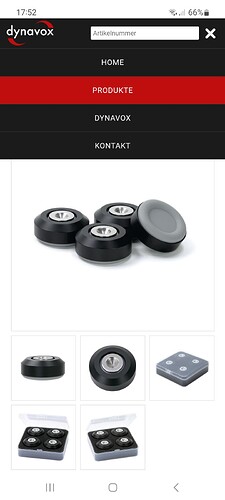

Ok fellows here’s my situation. My speakers are on stands. They are on top of a vintage Bokhara rug . I’m not using the spikes, because I don’t want to damage the rug. I’ve thought of some kind of cup like these:
Ultimately try the options and see what works best for you and your system.

Surely these would damage the rug far more than spikes, which would ease their way through the weave ?
Those look like Herbie’s small gliders and they’re great when you’re experimenting with positioning. I used them on a tiled floor intending to replace with Fraim chips once I had the positions but they’ve to stayed in place and I think to no ill effect. I’ve used the brass and titanium versions of which I prefer the latter with my NBLs. I probably would remove them on carpet but they’re not that dear and very convenient for making millimetric adjustments. I’m wary of the thicker ones, the non gliding bases I tried under my unsuspended turntable did in no favours.
I use Herbie’s decoupling gliders (standard size and brass) beneath the spikes on my rack that sits on a vinyl covering on top of a suspended wooden floor. Well worth a punt for £83 including shipping.
