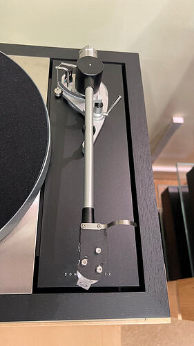

Probably the reason the arm housing is now a separate item. Easier to machine and less costly if they cockup the machining.
As soon as I saw it, I thought, that’s going to be more stable.
I once bought a carbon bicycle frame to build up a custom bike. The head tube looked like that, and was never going to accept a headset properly. The frame was replaced under warranty immediately.

Its unlikely Skeptikal would know as he’s not inhabit of removing the arm by himself to see what’s beneath. The collar is circular and then there is an additional machining made as you can see and if you think about it when the circular arm pillar now is retained within the collar and secured by the locking Allen bolt, then the arm pillow will be supported on three points. Not the entire circumference or even half of the circumference with the Bolt pushing it! Three-point mounting is a good engineering solution to guarantee uniform connection. I don’t think I need to go further on this one as I’m on holiday at the moment, but was asked to post here!
The removal of the machining of the collar serves two purposes, firstly it allows Linn Products Ltd to achieve a far higher quality of analysing and if anyone wants to compare the new SE against the original you will see what I mean. Secondly, it allows for the fitment of other arms on the flat surface now such as the Bool Audio and possibly the ARO, if I’m able to organise an adapter from the ARO fitting that could be mounted on a standard Linn fitting .
Food for thought! And remember Linn Products generally always have a very good reason for doing things when it comes to design.
Regards, Peter
I know. I pointed this out yesterday.
It’s obvious to anybody with engineering design knowledge what’s going on. :smiling_face_with_sunglasses:

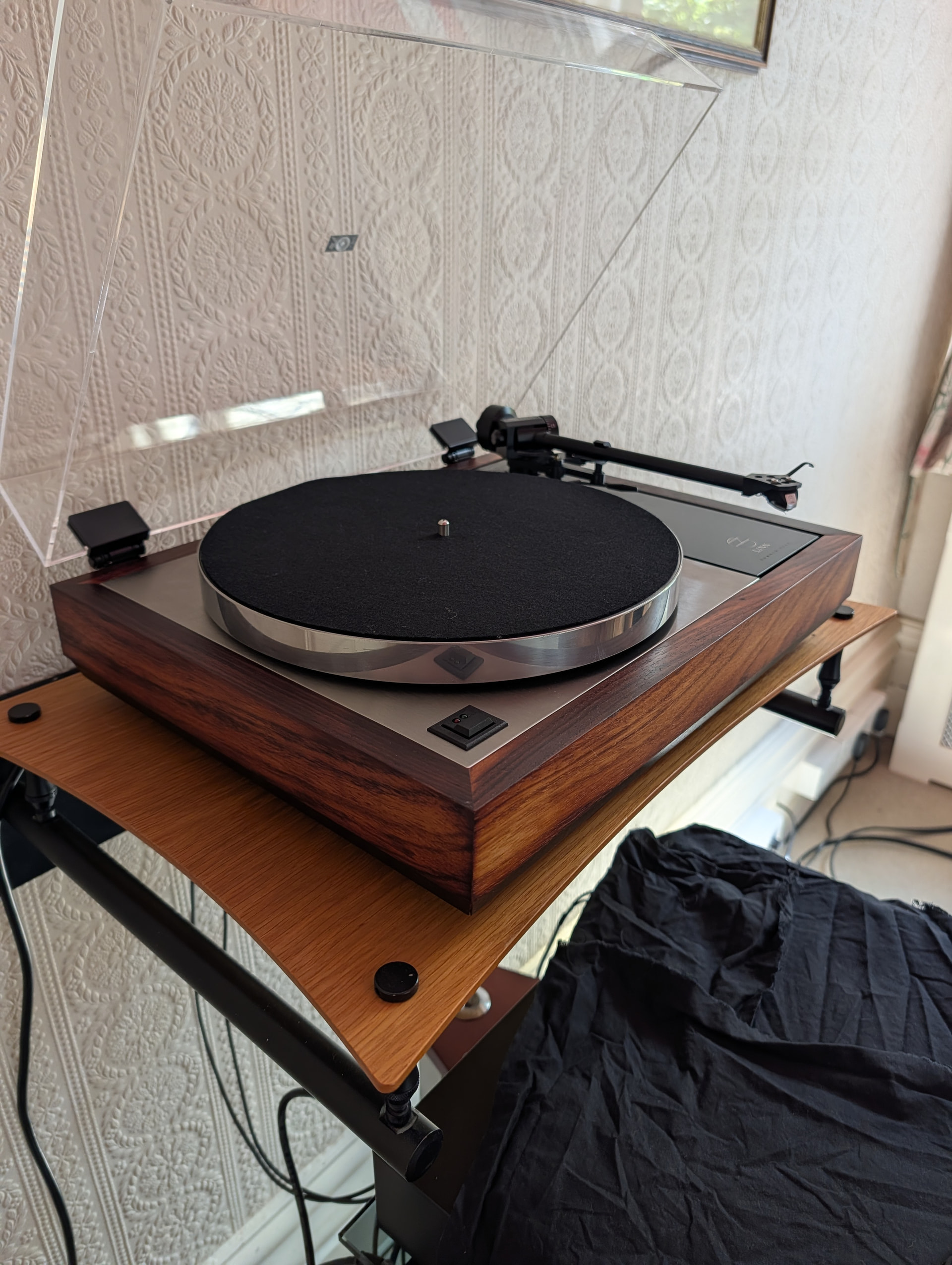

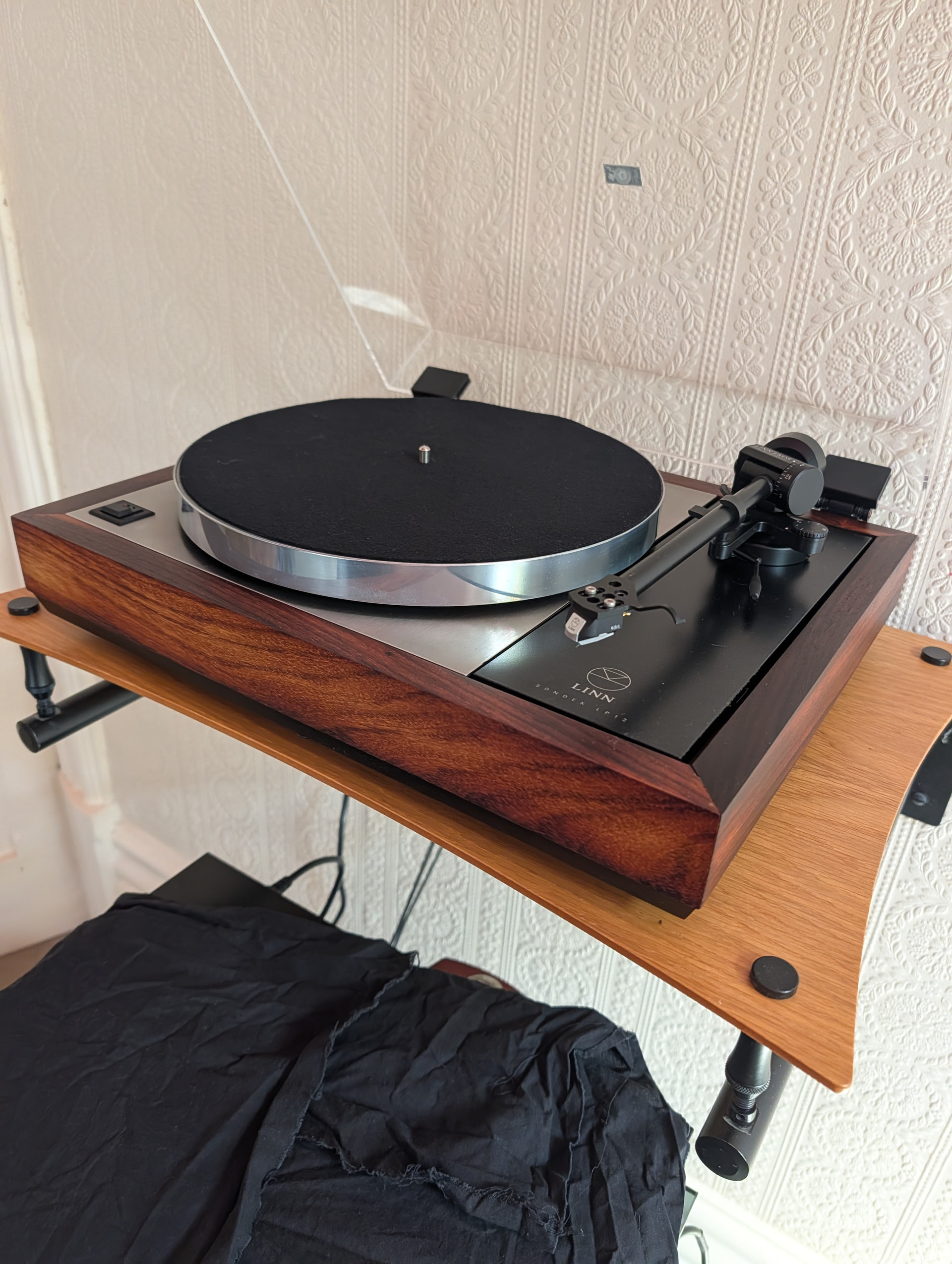

Linn lp 12/ Kore/ Ekos mk2/ Koil
Minions power supply
On a Bamboo Quadraspire
What a beauty!!!
What’s the plinth?

It’s a very old rosenut……pre corner braced
Rubbed down and the danish oil
Moorgate acoustics have braced it and done the kore Karousel
