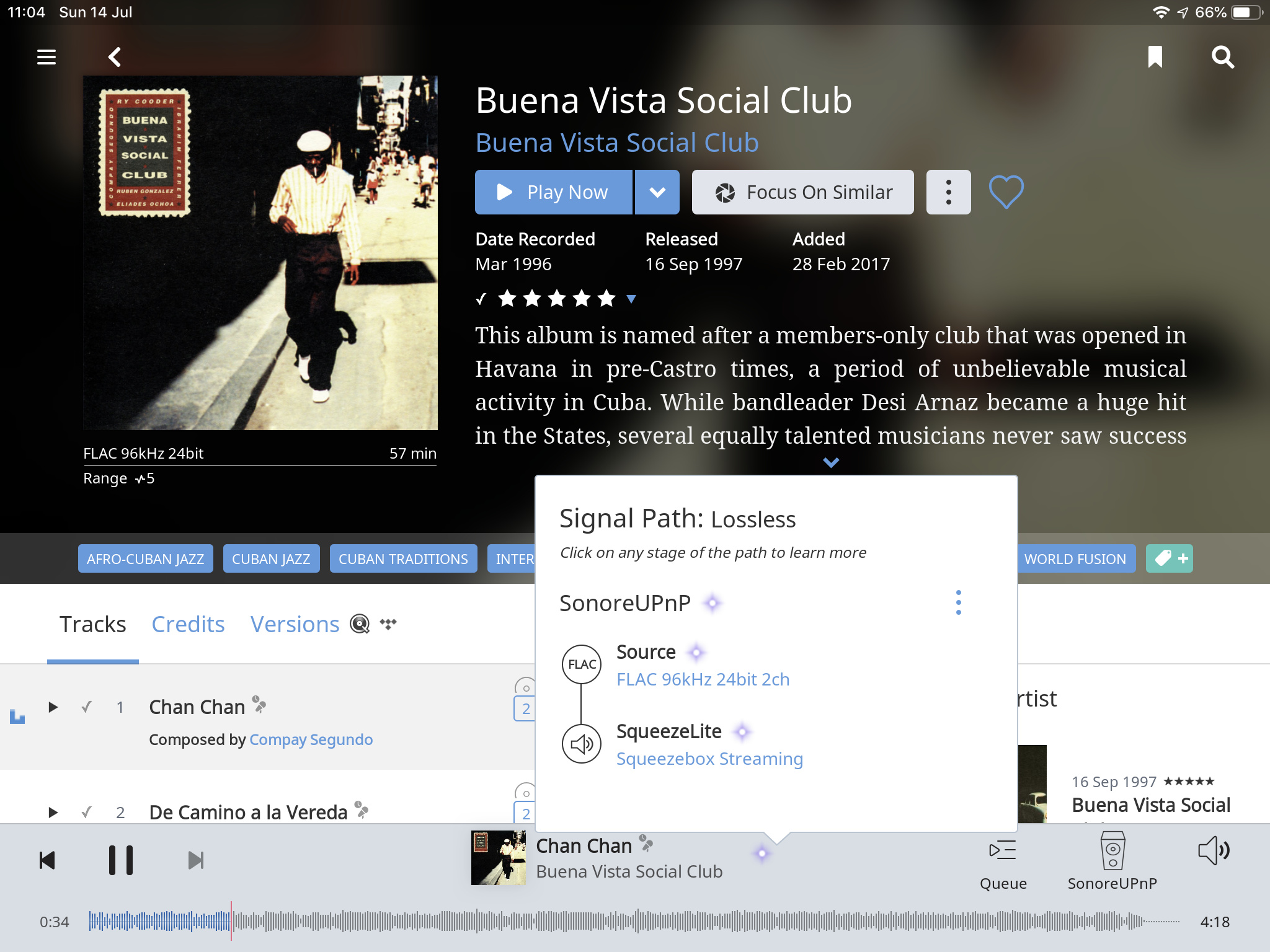

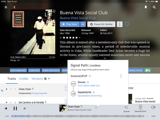

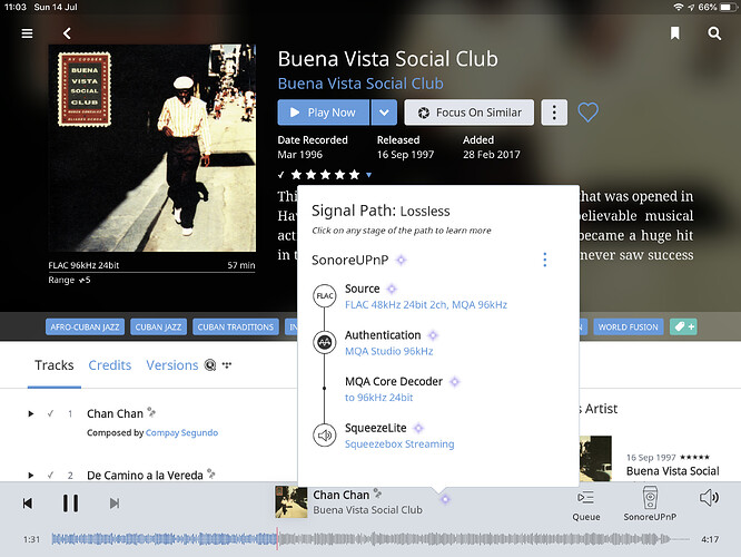

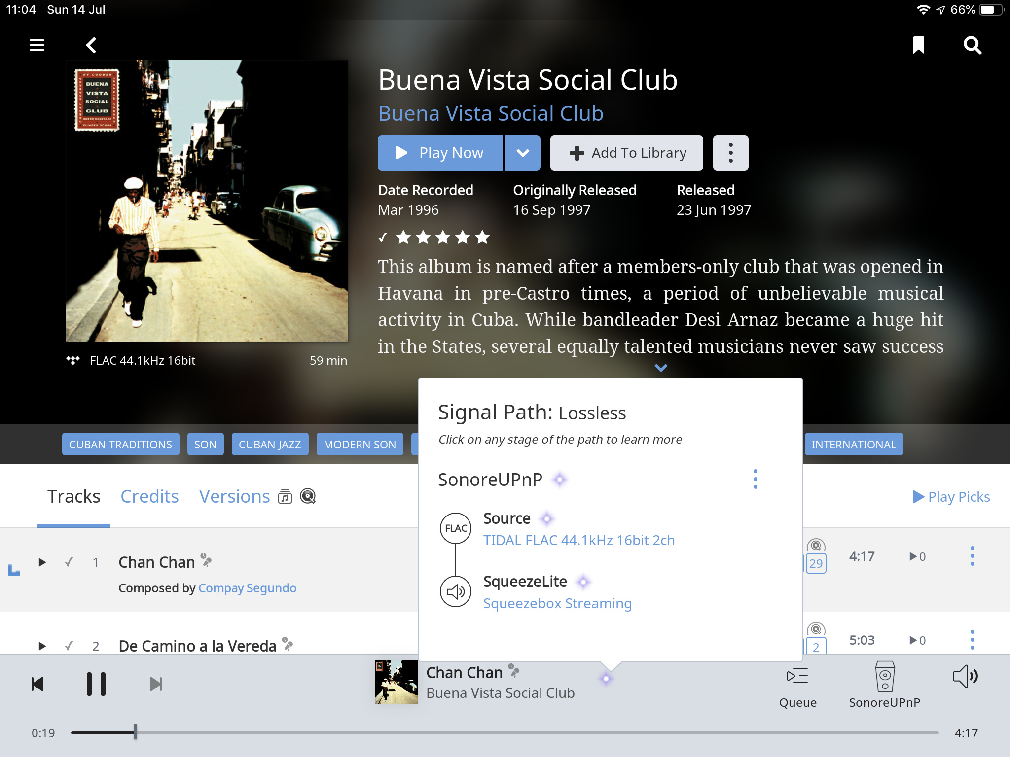

So Buenaventuraâs Vista Social Club in MQA 96 (locally streamed)
to same track in PCM 24/96 - this is hard to tell, but are different.
However verses the same track in std Redbook (from Tidal) - yes

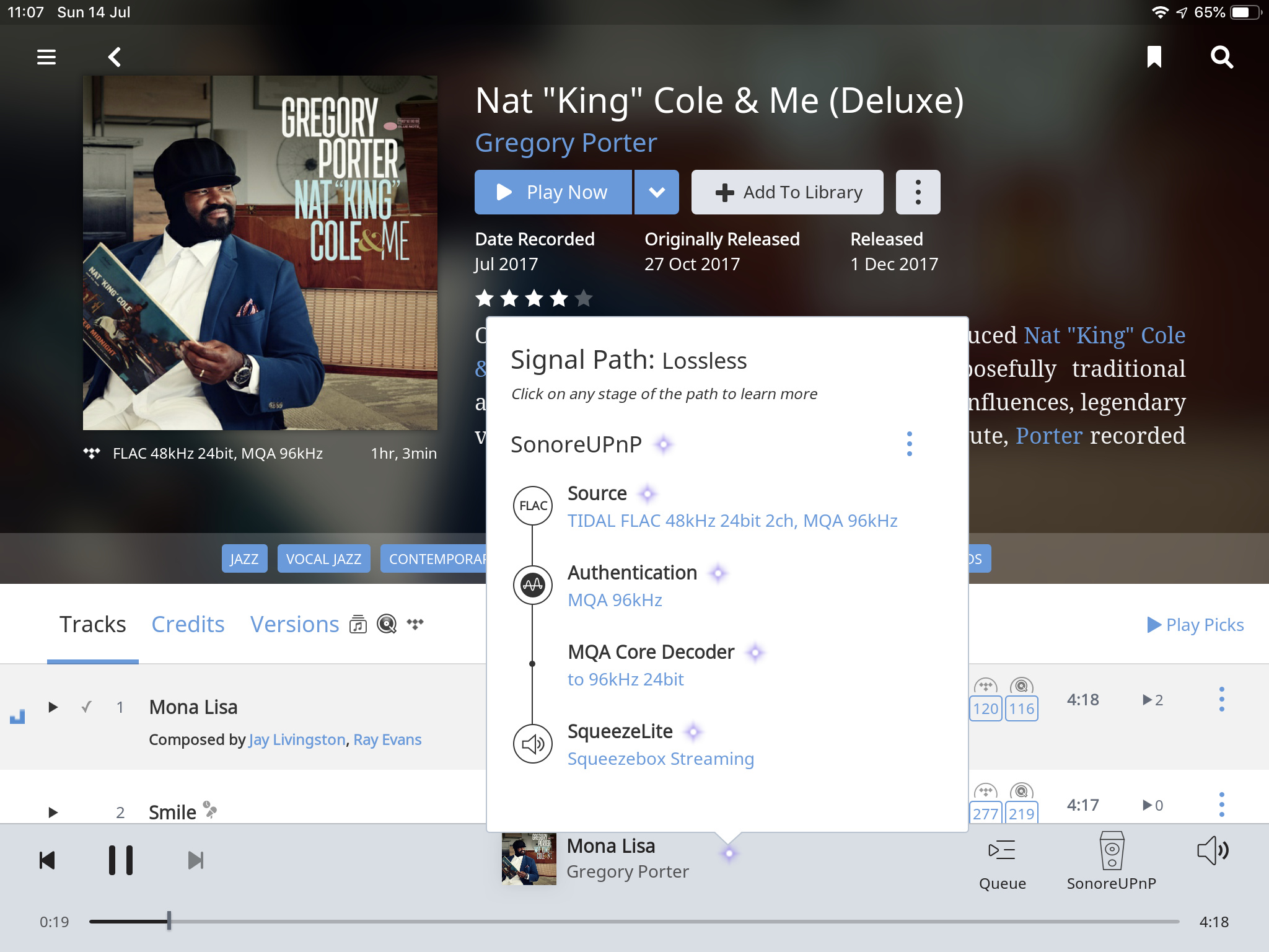

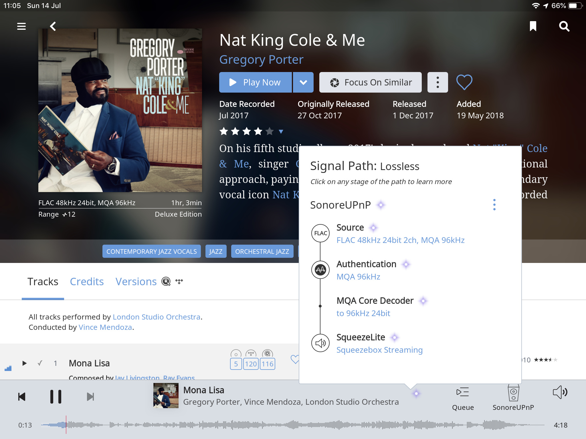

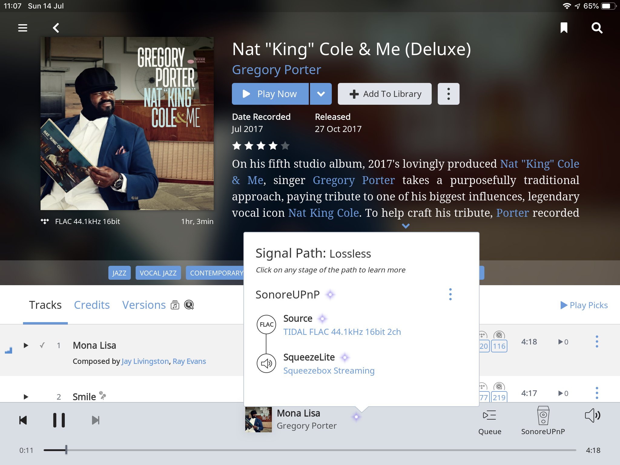

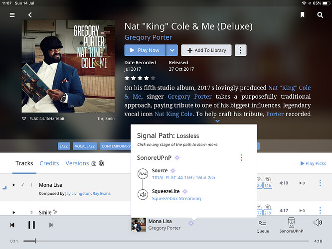

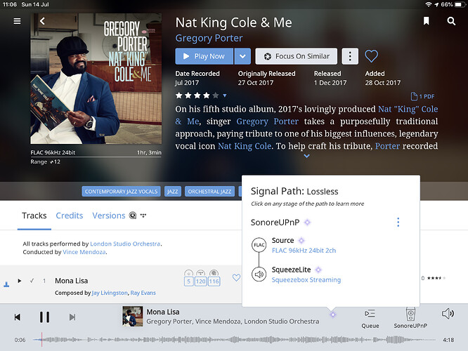

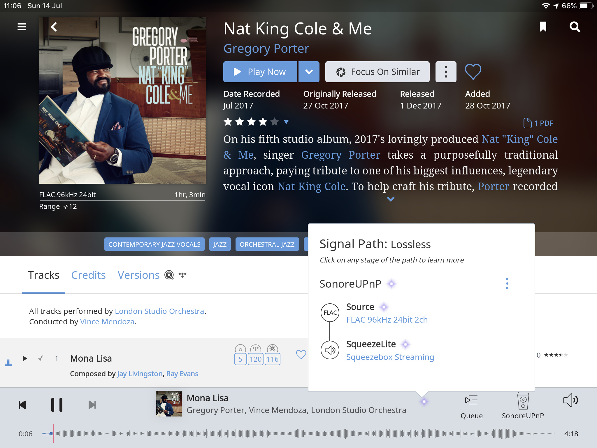

Then Gregory Porter in MQA 96 (locally streamed)
verses PCM 24/96
verses Tidal Master (MQA 96)
verse Tidal Redbook
The locally streamed versions have the better SQ and there is a difference between the MQA 96 and the PCM 24/96
However to answer your original question Tidal Master over Tidal Redbook - yes
