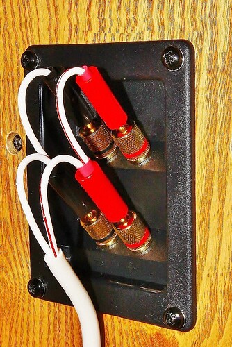

A) Connect + & - to the high-frequency terminals
B) Connect + & - to the mid/bass terminals
C) Connect + to high-frequency and - to mid/bass
D) Other configuration
I’ve changed to one of these options (A-C) and am pleased I experimented.
Anyone care to share?
In my tests (in no way exhaustive, but I was curious) from many years ago I found that it did depend on the speakers in question; some liked A best, others C, sometimes D (such as F configuration). In all cases I found dispensing with any metal links to be beneficial.
I usually use the C configuration, which was recommended to me by a local hi-fi guru many years ago, But Richard is right, it depends upon the speaker. It’s quite disappointing that so many speakers these days are still designed for bi- or even tri-wiring (or -amping, of course)… I never found any benefit, and it makes it so much more difficult for the great majority who have no interest in such arrangements.

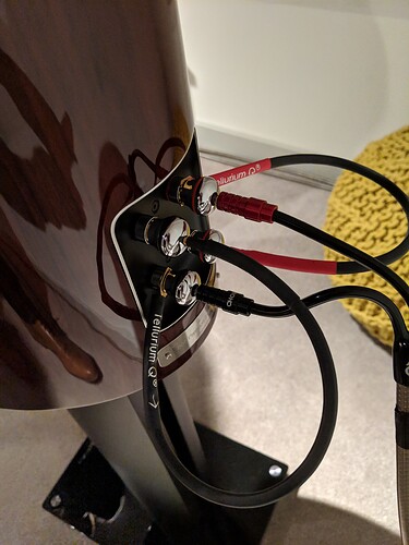

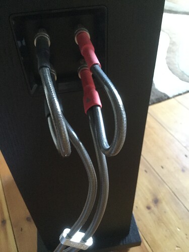

Positive to bass and then negative to treble in a diagonal configuration.
I found that I liked, having tried all possible permutations, the following connection most:
  • Speaker cables to bass terminals
  • Links to treble
Improvement also came from obtaining decent jumpers to complement SuperLuminas.
Having tried all the combo’s going, little to nothing between them
I’ve been on the same ever since - F connection, into bass first, F linked to treble
Me too.
