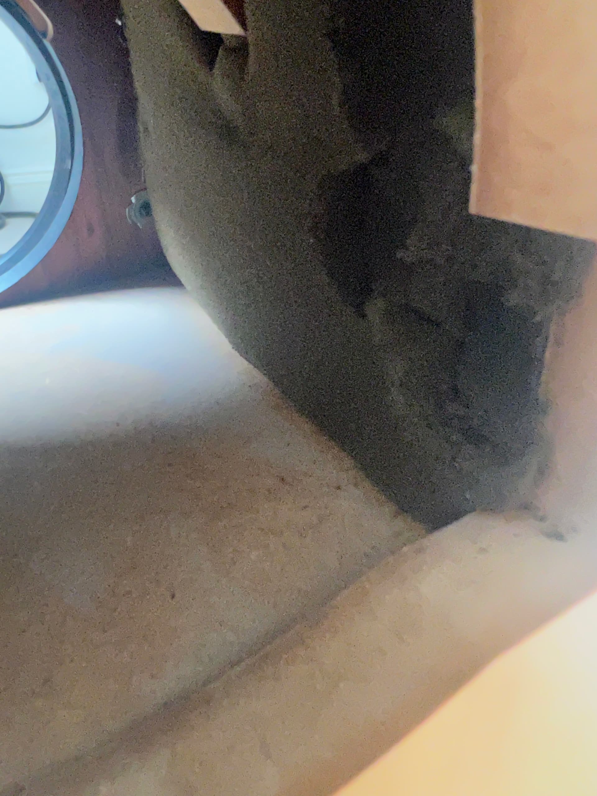

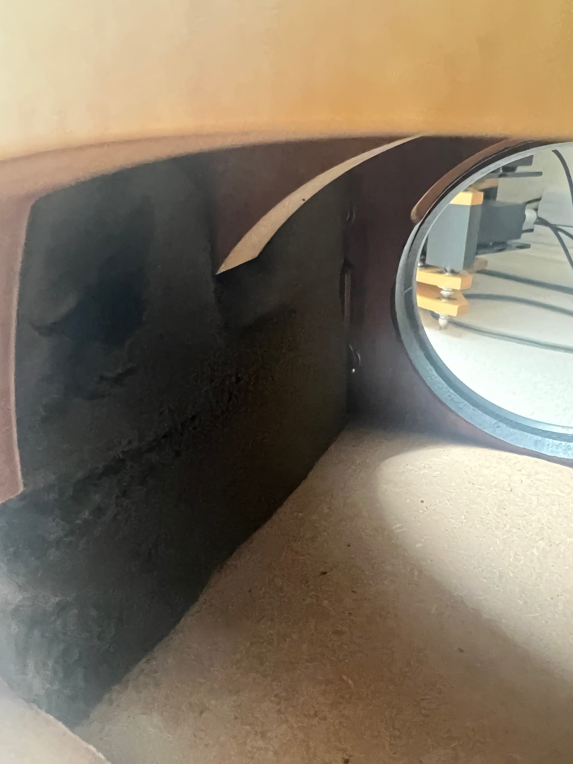

I checked mine earlier today.
The foam is not in great shape (20 years old)
so I’ve ordered some of the Wilmslow foam and will fit next week.

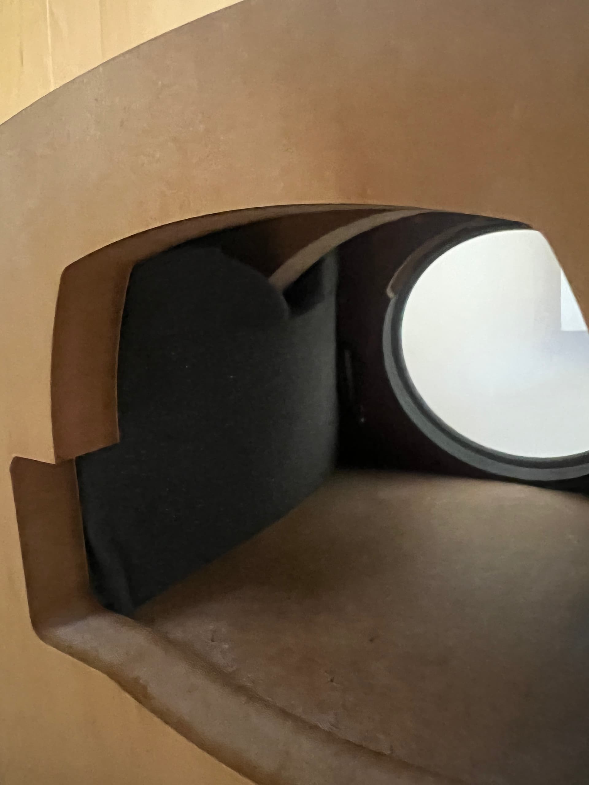

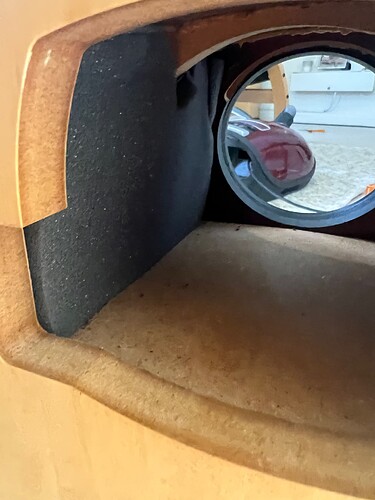

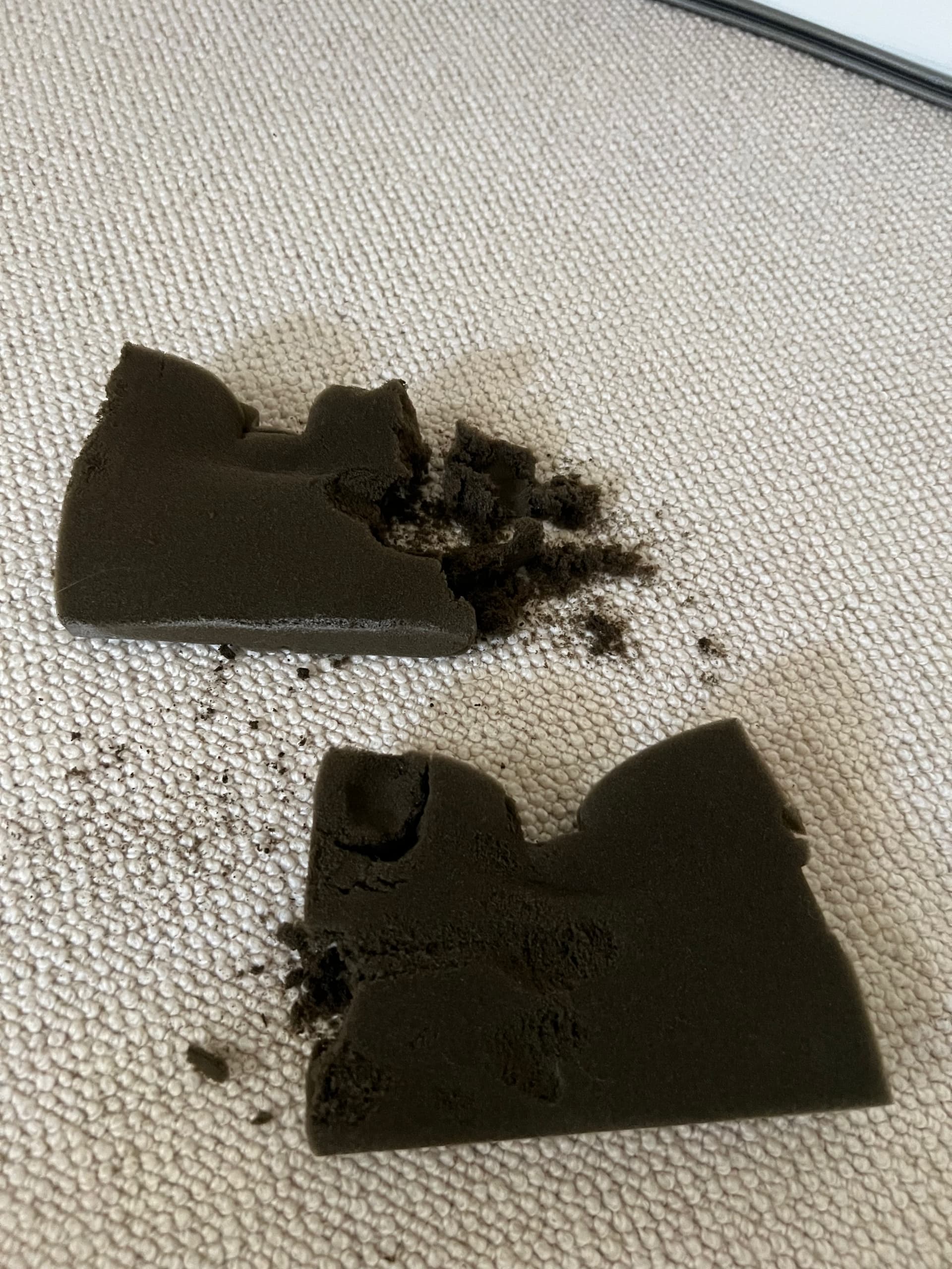

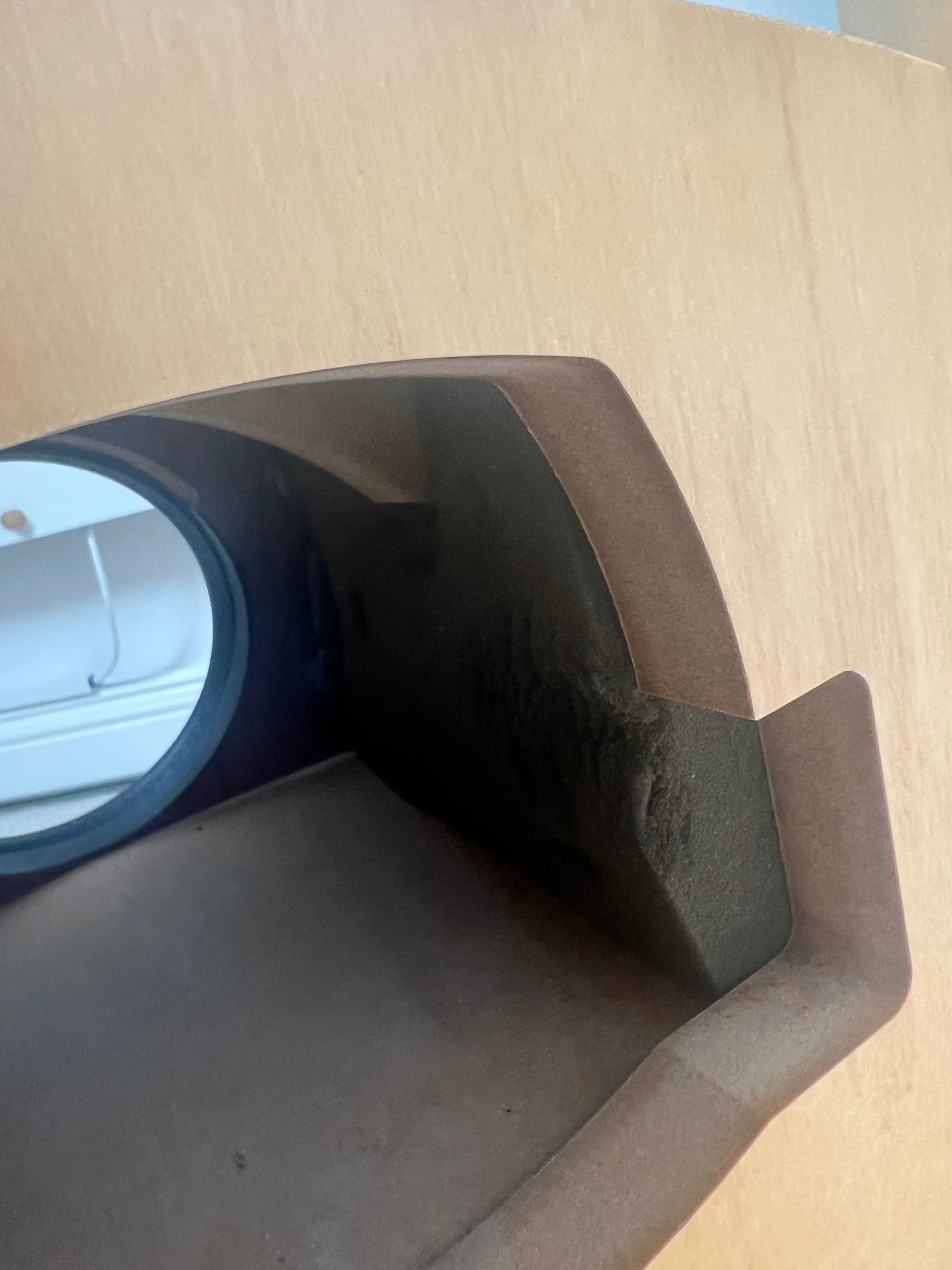

So I received the Wilmslow foam and replaced the crumbling original foam in the tweeter cabinets.
The old foam just disintegrated in my hands as I removed it:

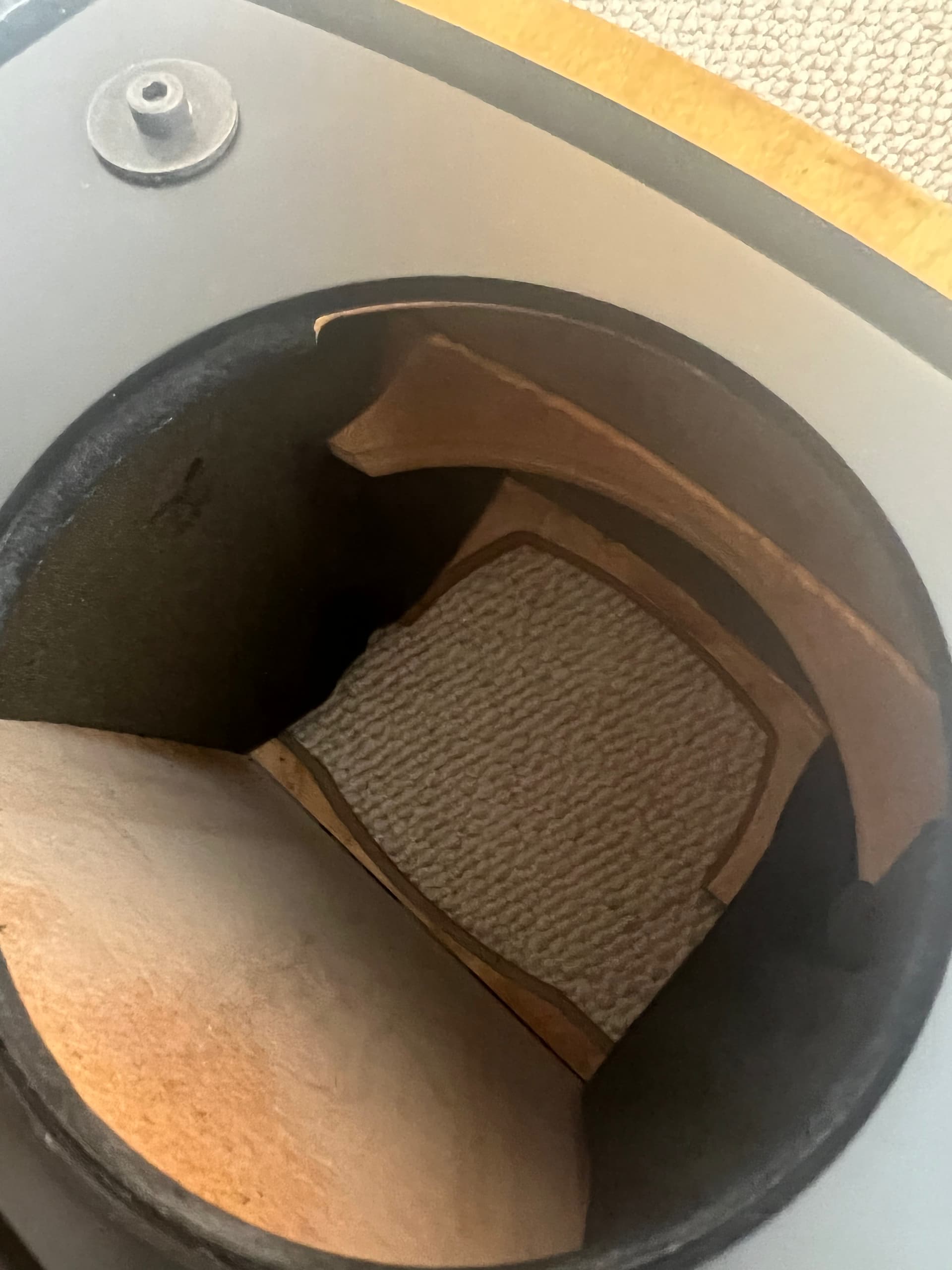

I wanted to replicate the depth of the original foam (25mm) as close as possible so I decided to cut two templates of the Wilmslow (12mm) for each side and then stick the two pieces together (each adhesive side stuck to the other) so that the total depth was near to 25mm. This also enabled each piece to be easily removable as required.
I also took the opportunity to replace the SL-2 interface spacers with new ones (including washers) from TomTom.
Regarding the sound when completed I won’t bore folks with hifi metaphors etc but with the foam installed I concur with @mjkent in terms of improvement.
