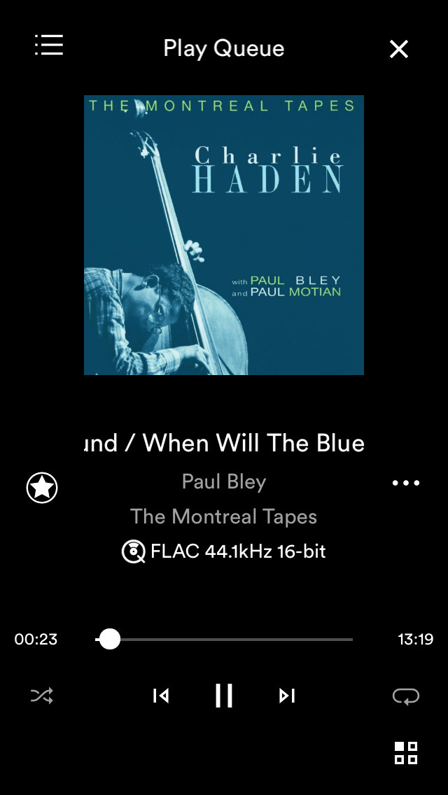

The Paul Motian drum solo on ‘Turnaround/When Will the Blues Leave’ sounds definitively better than ever.
‘Crisp’ is the word that springs to mind.

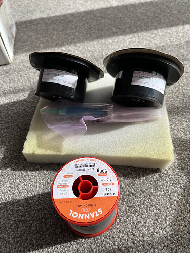

I brought some matched tweeters from Naim last year (yet to be installed) and have just ordered some solder…OMG as I write it arrived!! @Richard.Dane i think this is the solder you said to use at the time. Even though post 06’ Naim stopped using it Naim customer services confirmed with my set (08’) it will be fine. I’ll be getting a competent friend to do the work. My foam is still fine but I get some in anyway.
If you don’t know and I’m sure you do Torquing mid driver bolts and face plates to 3.6Nm is a good thing too.
Naim used Multicore Crystal 505. Is that Stannol Kristall 505 similar?

Wow I’ve had to do a bit of research in the last couple of hours. It would seem they have very similar properties, as far as I can tell the “Crystal/Kristall” is a clean finish and the “505” %0.5 Halide content. Bit confusing to me, I guess best practice would be to hunt down the Muliticore Crystal 505.
I really thought it was going to be Crystal 505 coming :upside_down_face:
