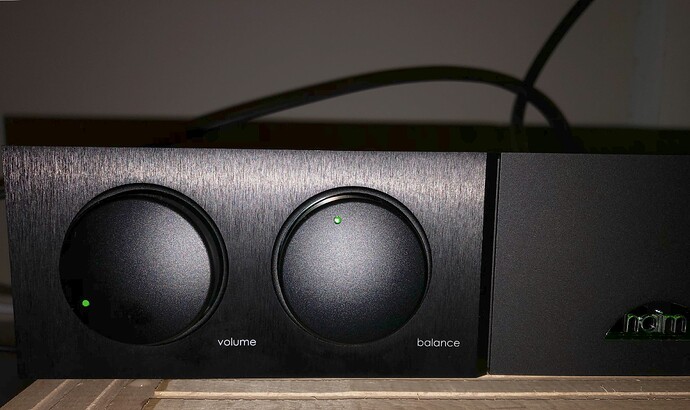

I thought this was due to burn in period of my sn2, but reading so far other comments with regards to the issue, seems something is really wrong there, and continues with sn3 as well apparently. As much as I tried to convince myself in beginning that everything was ok and probably my ears were somehow adapting to the sound while the unit was settling, I simply could not resist and had to adjust slightly to the left, this is the position in which the balance is in the perfect middle sound wise, probably 5 degrees or so to the left. Simply cannot understand how is this possible with such a high end amp. Nothing bad, just an odd position of channel balance.
Mine is in exactly the same position, but I think it is my ears!

I carried out another test - I switched preamps from the one in v1 dac (sn2 in av bypass mode) and then back to sn2’s own preamp, it was very clear it needed an adjustment when back to the latter option.
Hi @realdpg, don’t worry, your amp is not faulty. The fact that you have to adjust slightly to the left as opposed to directly North or 12 o’clock does not matter. The balance control is developed to allow compensation for the ALPs volume control.
Providing that the sound is in the centre, according to your ears, at all volumes means the amp is OK.
In my case, at very low volume my balance control would be at 5 o’clock! As the volume is increased my balance control would need to be 4 o’clock, then 3 o’clock etc. A faulty amp (like mine) requires balance adjustment for each change in volume.

Thanks for your comments Bjm, this sounds bad. Balance is constantly in this position on my sn2, regardless of volume control position.
