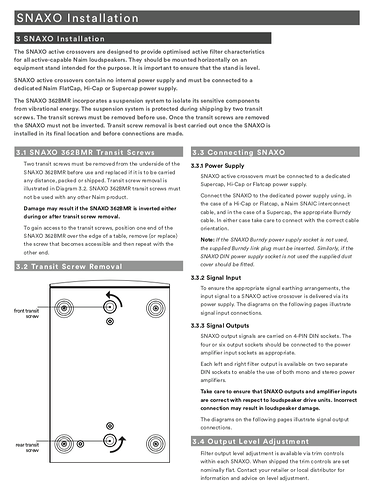

As shown in my pictures at the beginning of the thread there are no dots marked on the pots.
That practice must have changed at some point.

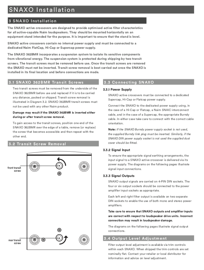

Assuming I can post this screengrab the manual suggests pot are currently set to minimum, see Output Level Adjustment:
