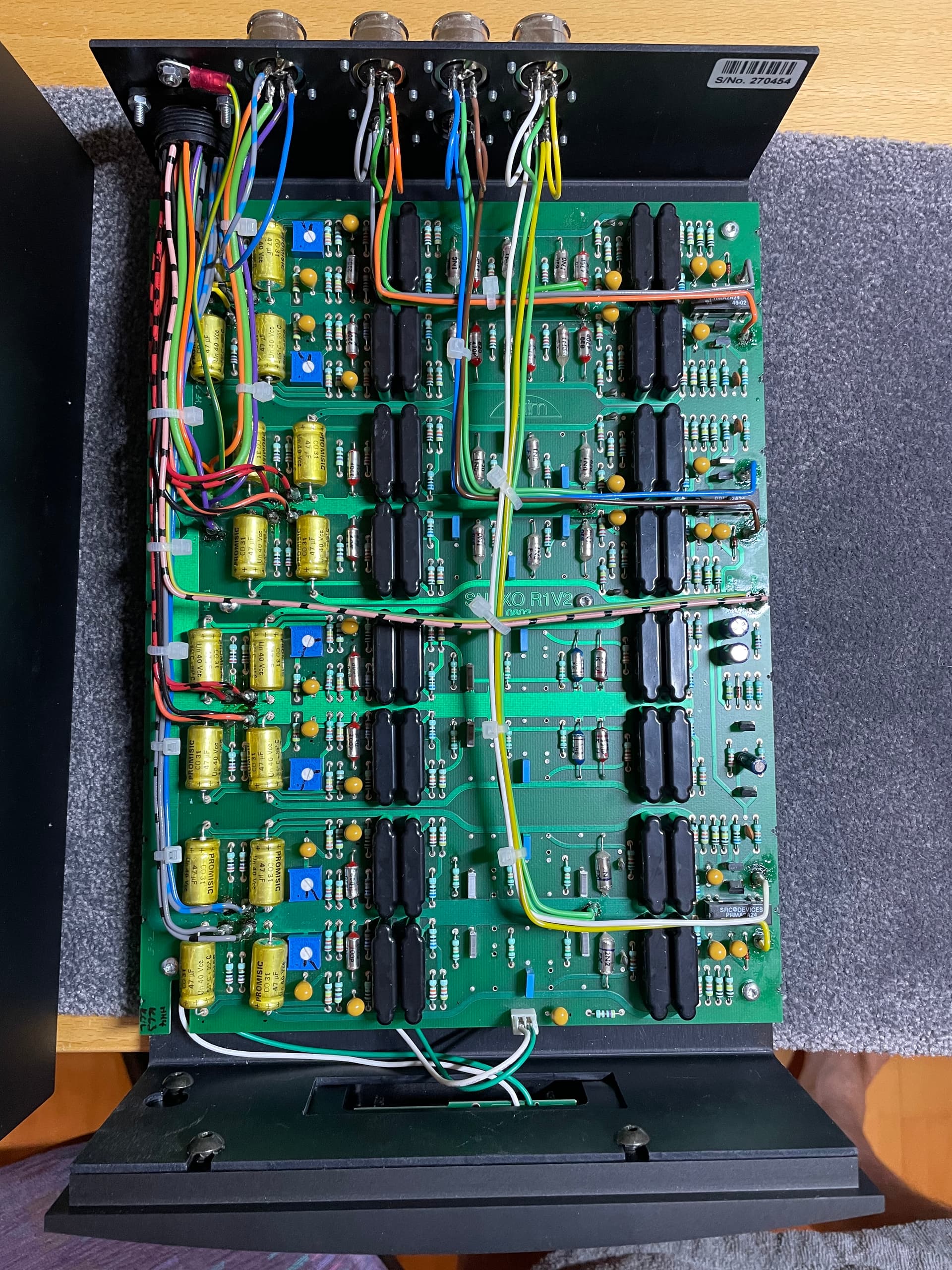

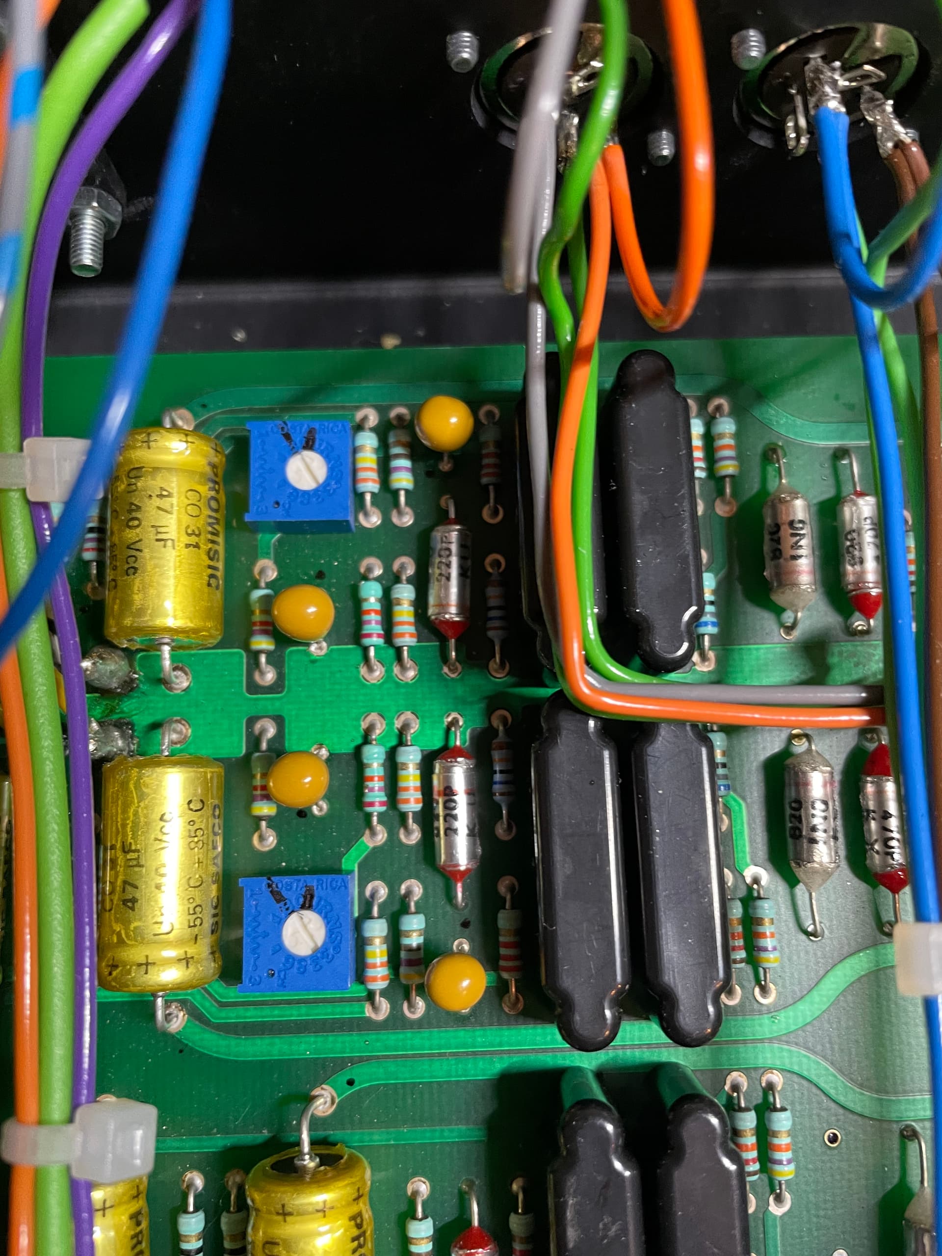

Seems at naim the left hand doesn’t quite know what the right one is doing at the moment. The pictures I posted are taken from a brand new Snaxo 362 for DBLs, out of the box in Oct 21. As you can see the pots are not set at their minimum but clearly adjusted to a specific setting.
In contrast to my own 362 for DBLs bought in Oct 2018 it came with their pots set at their minimum which I only found out much later …:pleading_face:
I think it’s likely that there are only a few staff at Naim who are still au fait with the intricacies of older equipment/designs from several decades ago and if production of items such as SNAXOs is comparatively tiny then efforts to train newer techs is likely to be better spent elsewhere on more popular products. I would however hope that somehow the older knowledge can still be handed down.
From what I’ve been led to believe, as Richard says they were set up in the factory by listening and the pots marked
I’ve had 7 of these, including 4 362’s all originally set for DBLs and all had slightly different pot markings
The original Naxo pots made huge changes whereas the Snaxos are fine tuning
In your shoes and from experience I’d start at everything at either a quarter or half turn, this gives you the option of taking away, rather than starting all at min
I’d do a session to initially sort this out, so remove the cover completely, find a starting point, get a wide variety of albums together and go for it
Only make one adjustment at a time as an adjustment of one driver on the Snaxo, can impact all 3 on the speaker
Once happy get pics cos you’re sure to tinker with it later with different albums and even more so after upgrading
For the record my actual settings are a long way from the pot markings and I’ve consistently found that to be the case

Here You can see the difference between Isobarik and DBL.
Isobarik is configured now.

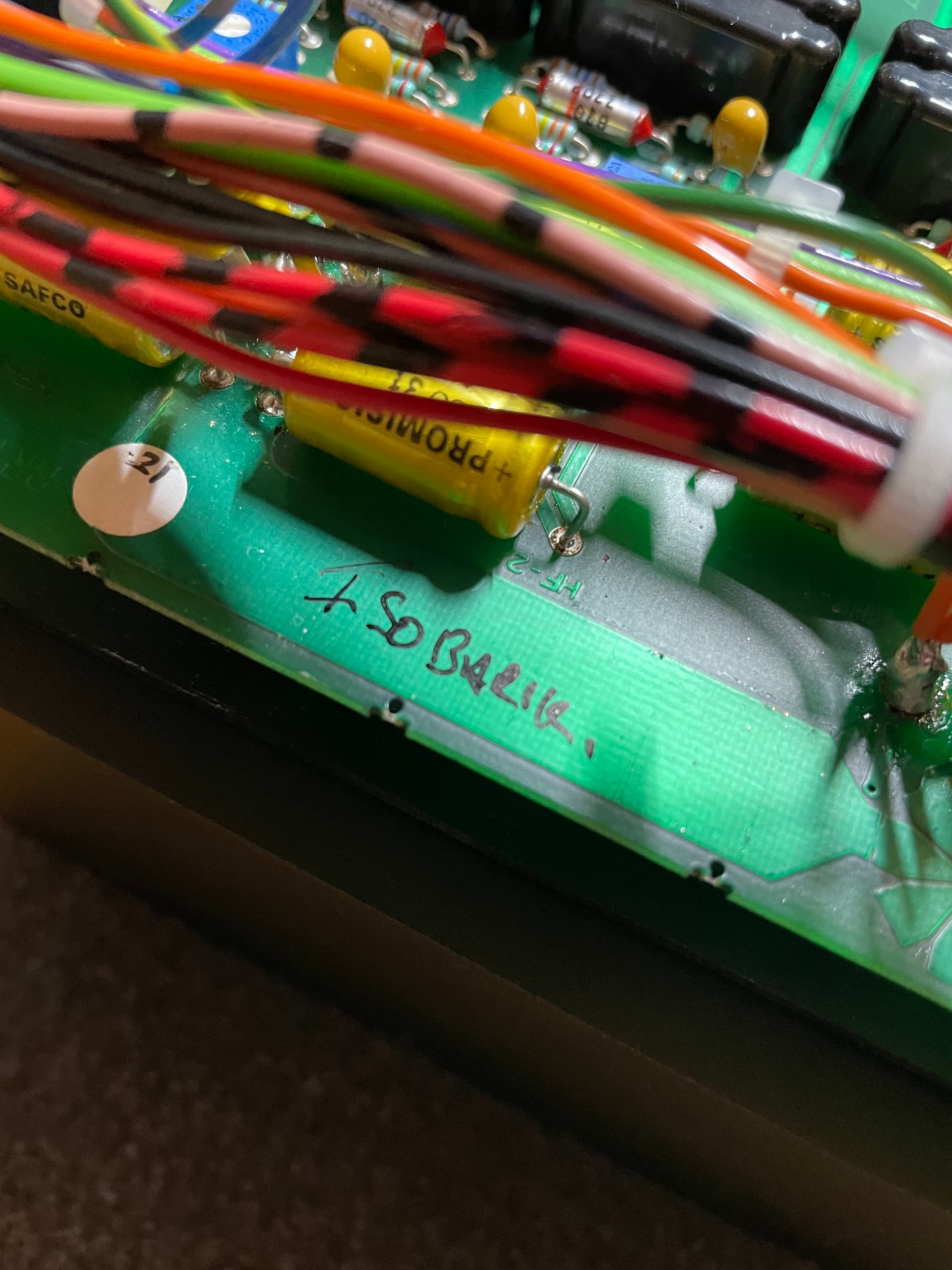

This is the ā€œdefaultā€ setting from Naim.
Note that it has been rebuilt for Isobarik as well.
