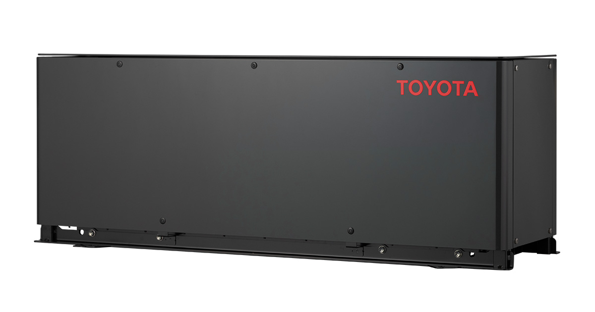

Toyota’s rival toTeslas Power Wall maybe of interest, although it looks like it will not be available outside Asia until next year.
That’s quite an interesting development. I was talking with my solar provider the other day and he mentioned that the emerging technology would also enable car batteries to power home appliances as a back up.
