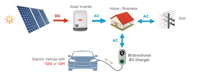

Found this statement
Only a few EVs currently feature V2H technology, including the later model Nissan Leaf and Mitsubishi Outlander PHEV, which both use the older-style CHAdeMO connector.
From the link below:
Basically you need a Bidirectional Charger, and an EVs with bidirectional charging capability.
