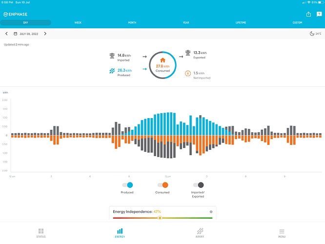

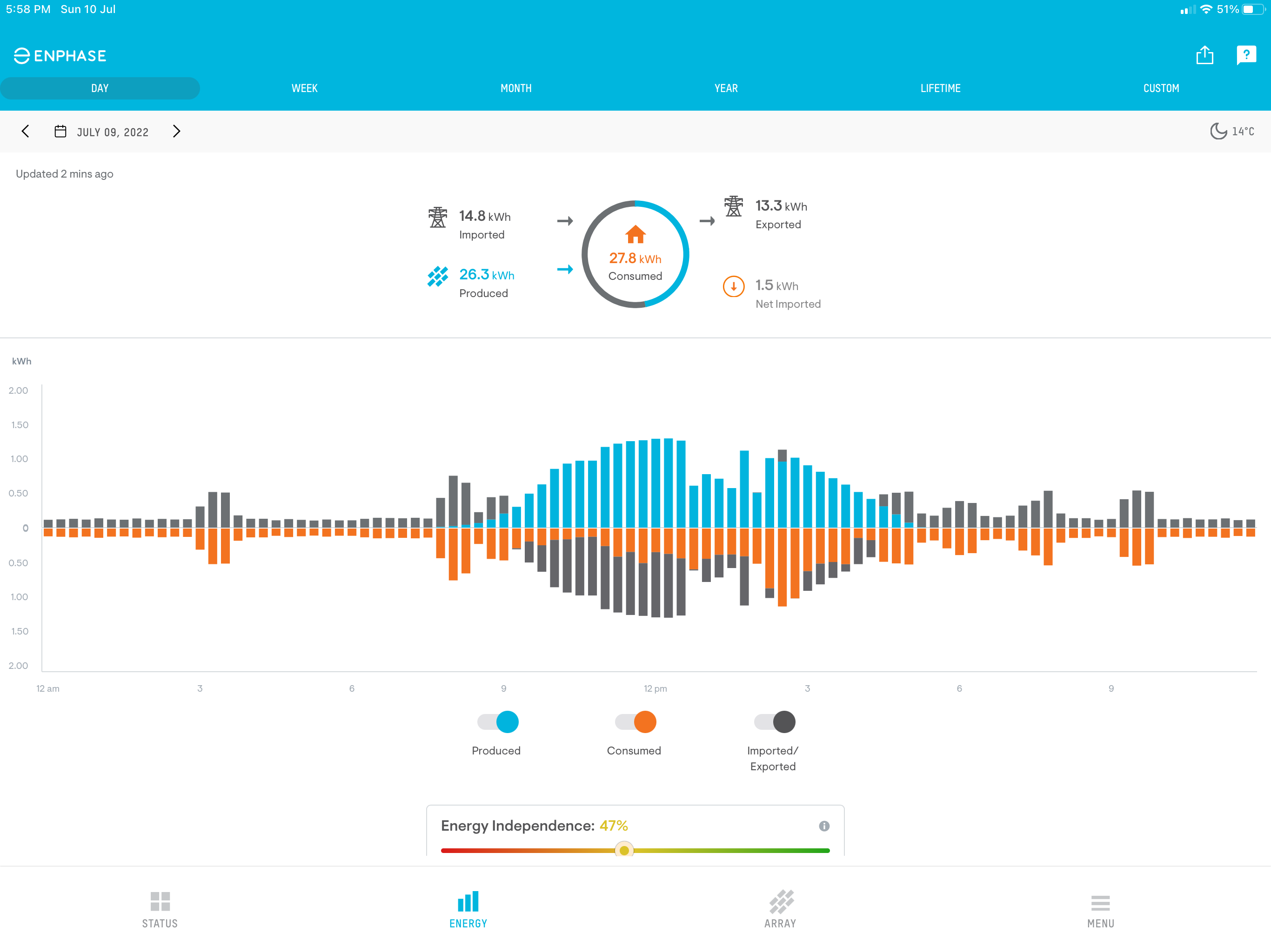

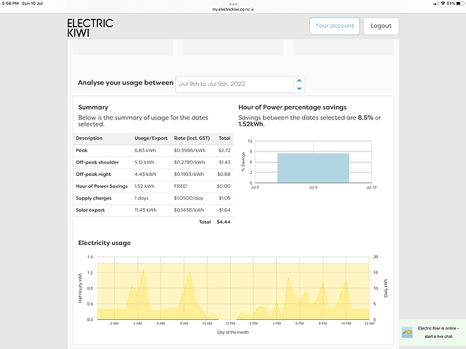

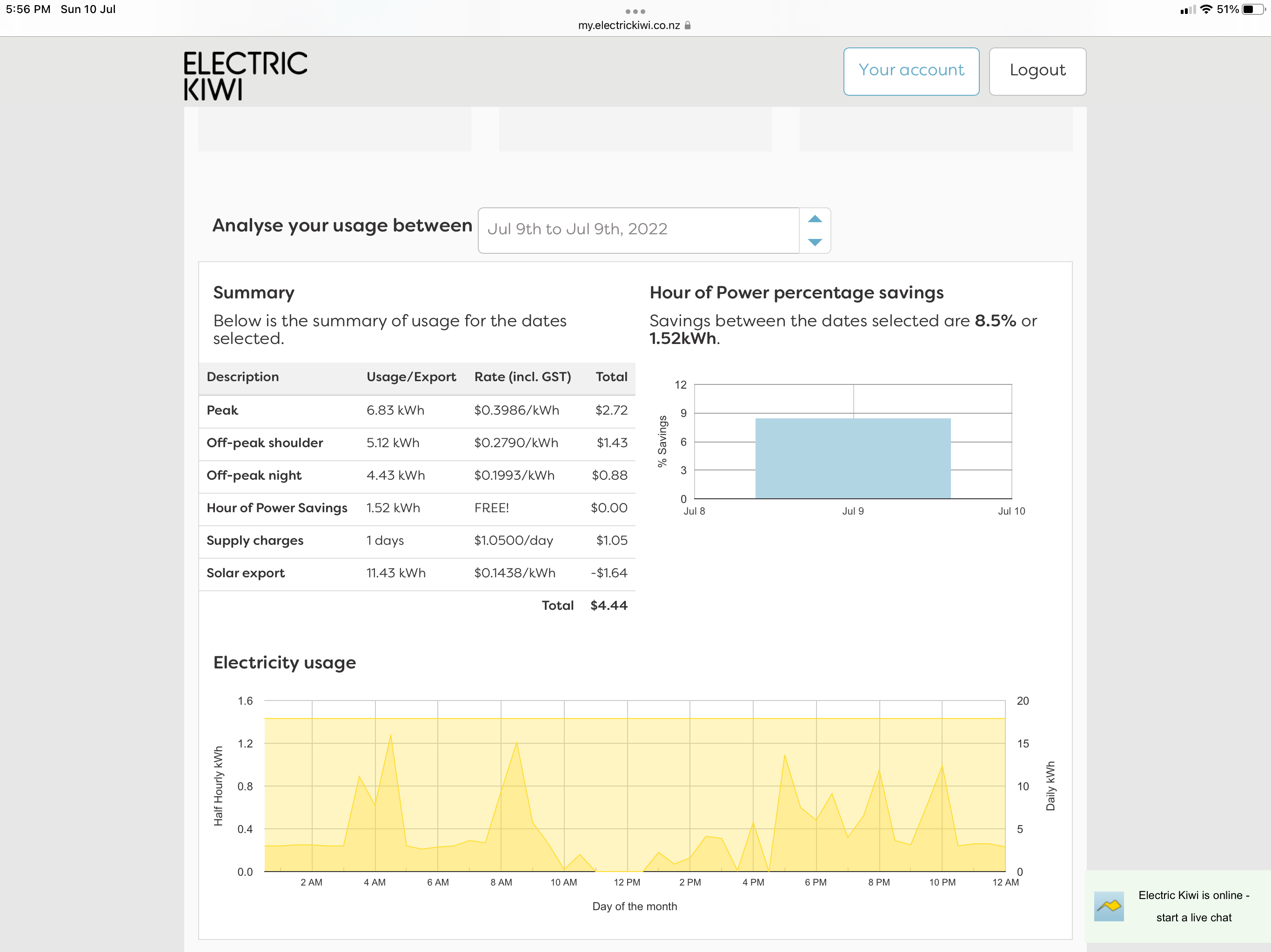

We finally had a sunny winters day yesterday. We generated about 26 kWh, covering all our daylight use (including a spa :smiling_face_with_sunglasses:) with about 11 kWh exported that we then bought back at a higher rate when it was dark. Pretty good for mid winter.
The solar app gives up this data (but is less accurate than the incoming meter):
Our power companies app shows how that breaks down into power charges:

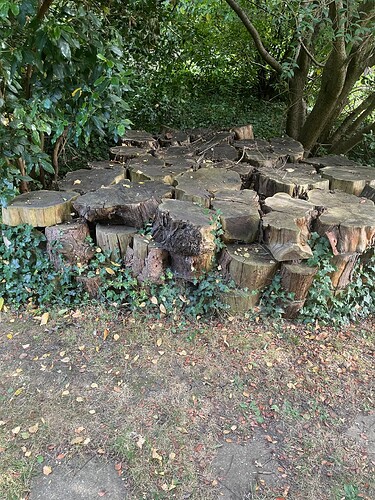

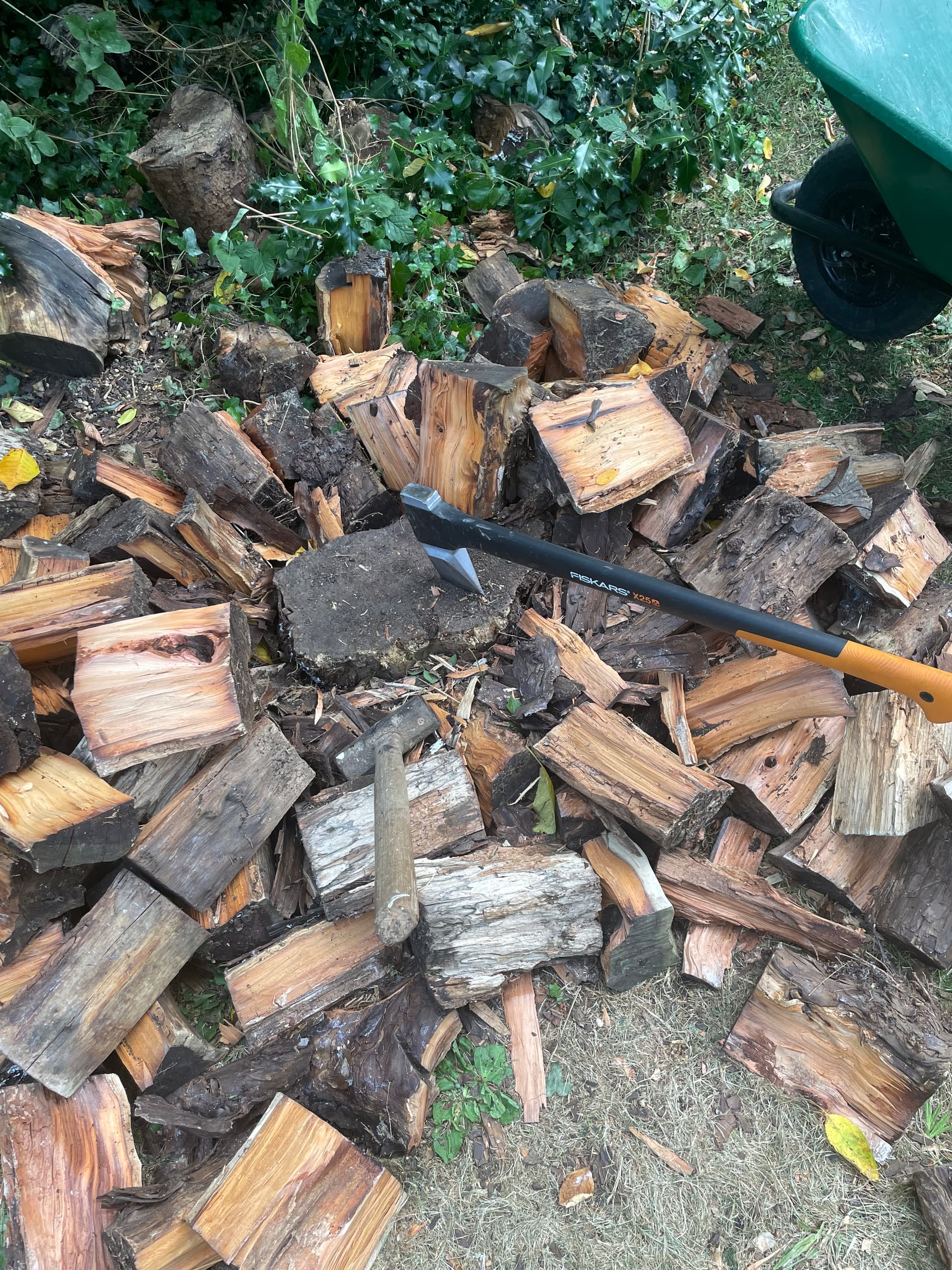

My summer project is to chop the wood for the winter. I bought a Fiskar log splitting axe a few weeks ago and have been chopping lately. I probably have 2-3 years of wood stacked neatly. It is yew and fir cut about 5-6 years ago from an aunt’s property where we tried getting planning permission for a new house at the bottom of a large garden. The trees grew into the highway a bit. The logs from the bottom are at least 600mm but cut thinner. Yew is very sappy but the seasoning seems to have left dry wood. It should burn well. This is nature’s energy storage.
The sledge hammer is to deal with logs that the axe doesn’t chop through. The axe is about 2.5kg with a carbon fibre handle. The handle is a little shorter than I like so the logs are placed on a chopping block so there is something to stop the axe. I’m trying to avoid my legs doing that job!
Phil
I really messed up my shoulder one log season from the constant jarring which needed a few visits to the chiropractor at some cost. I then bought an electric log splitter for future seasons.
My axe is quite light and the handle seems to cushion the impact. If I hold the handle tight while using the sledge hammer their is intense vibration- obviously I don’t! The axe metal is much harder than the average axe. Quite impressed.
I don’t think my logs would go in an electric log splitter.
Phil

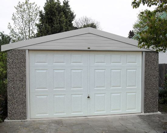

Has anyone here had solar panels installed on an outbuilding?
Whilst our house would be ideal as it has a large roof being a chalet house we’re not sure that we could tolerate the look of panels on the house. We’re coming round to the idea though that having panels could be beneficial.
Down the end of the garden we have modern a Comptons sectional garage. This is like the Marley garages of old with reinforced concrete walls bolted together on a concrete base. It has a steel A frame roof with concrete roof pitched at an ideal angle. The garage is 28ft long and 14ft wide so there’s quite a lot of roof area available.
I’m wondering if such a building could take solar panels?
It would require a long run of cable back to the house but presumably most of the other paraphernalia could be installed in the garage?
I can’t think of a reason as to why that wouldn’t work, as you say you just need a cable that will connect your inverter to your incoming power cables.
Solar panels can be mounted pretty much anywhere from a functionality viewpoint
It sounds ideal really, provided there is a system for fixing the panels to the roof. What exactly do you mean by a concrete roof? Tiles?
Concrete isn’t really correct having looked it up.
They are called fibre cement roof sheets. Corrugated and pretty thick and heavy.
The garage is similar to this. It’s a double tandem garage which is wide enough that if you get a car dead centre you can fully open all the doors.
