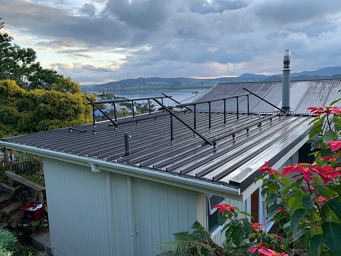

Good progress today, with the brackets installed along with the wiring from the roof to the control board. We had to change the design to move 2 of the NW panels to the NE Array - so 15 NW and 8 NE.
This is the NE Array on a 30 degree tilt on the flat roof:

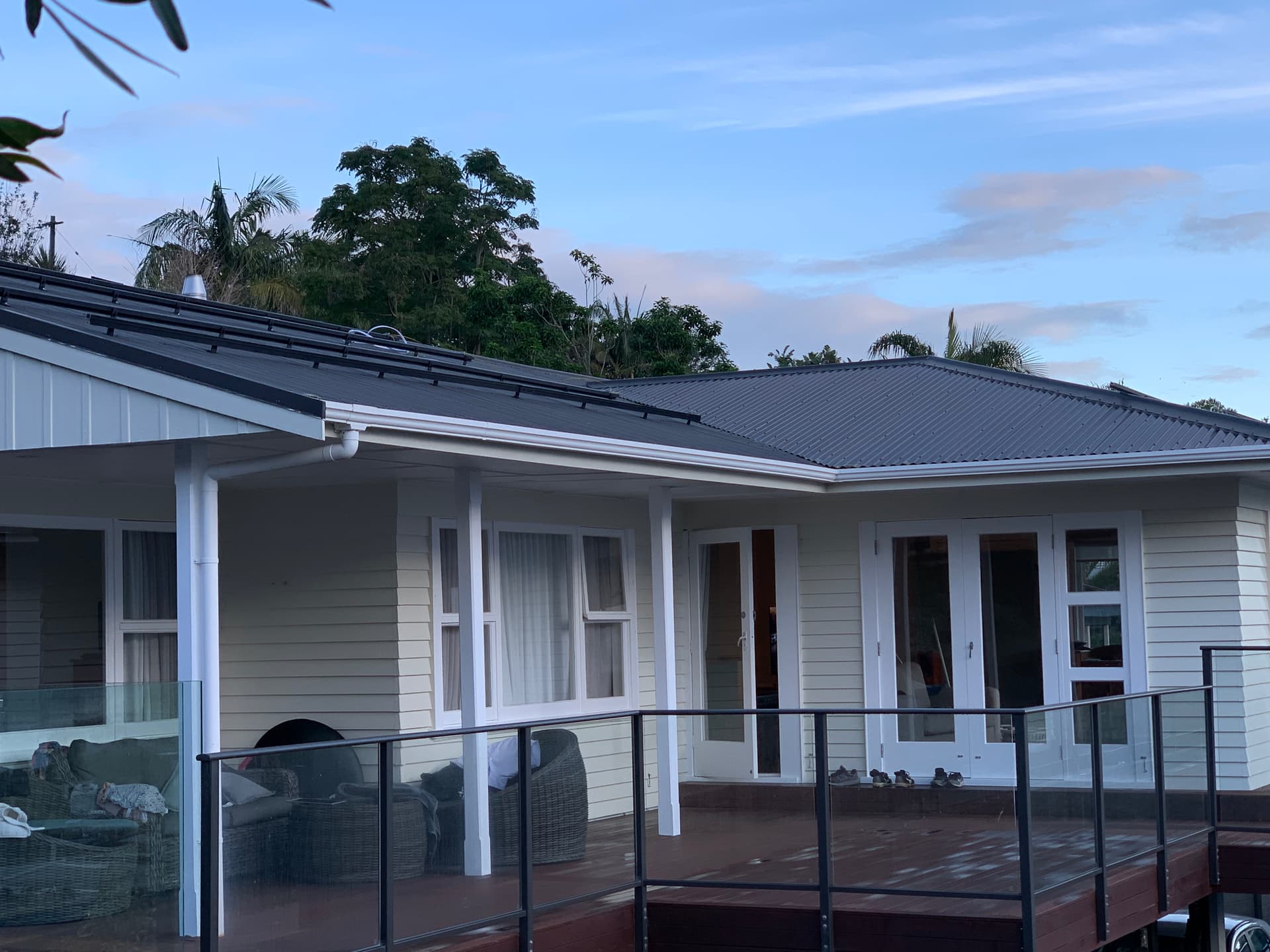

And the NW Array, which is on both the long roof and the small section of roof to the very right of the photo:

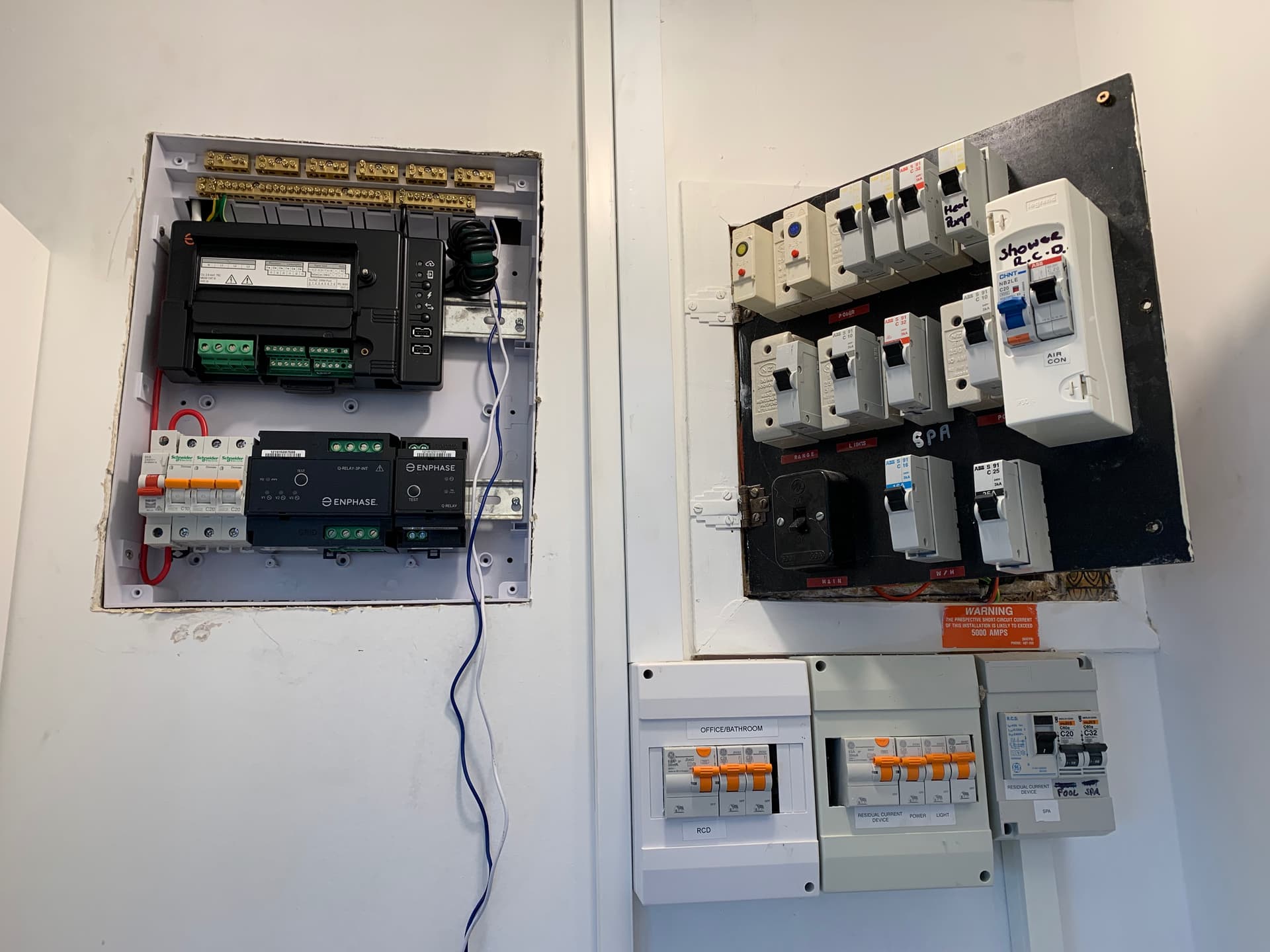

The control panel is bigger than our fuse box:

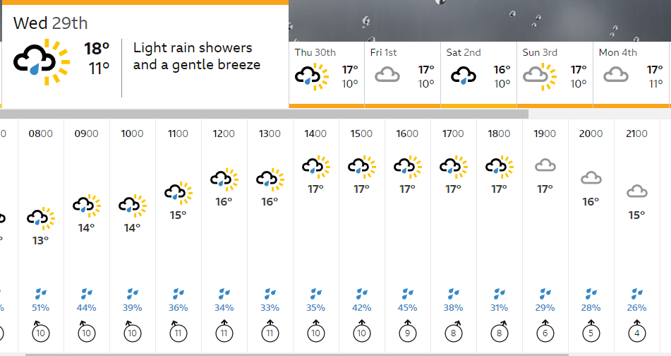

Its mid-summer here, we got to 16C today… :hot_face:
thats not good - im flying there today
Tomorrow should hit 17C…no prob..
depends where you are visiting, warmer in the south..
It’s mid winter here and it’s 16c here. :grin:
Lancashire and Scotland - have thrown another jumper in the bag
We’ve peaked at 12.9°C today with a lot of rain, that’s about as nasty as it gets here.
