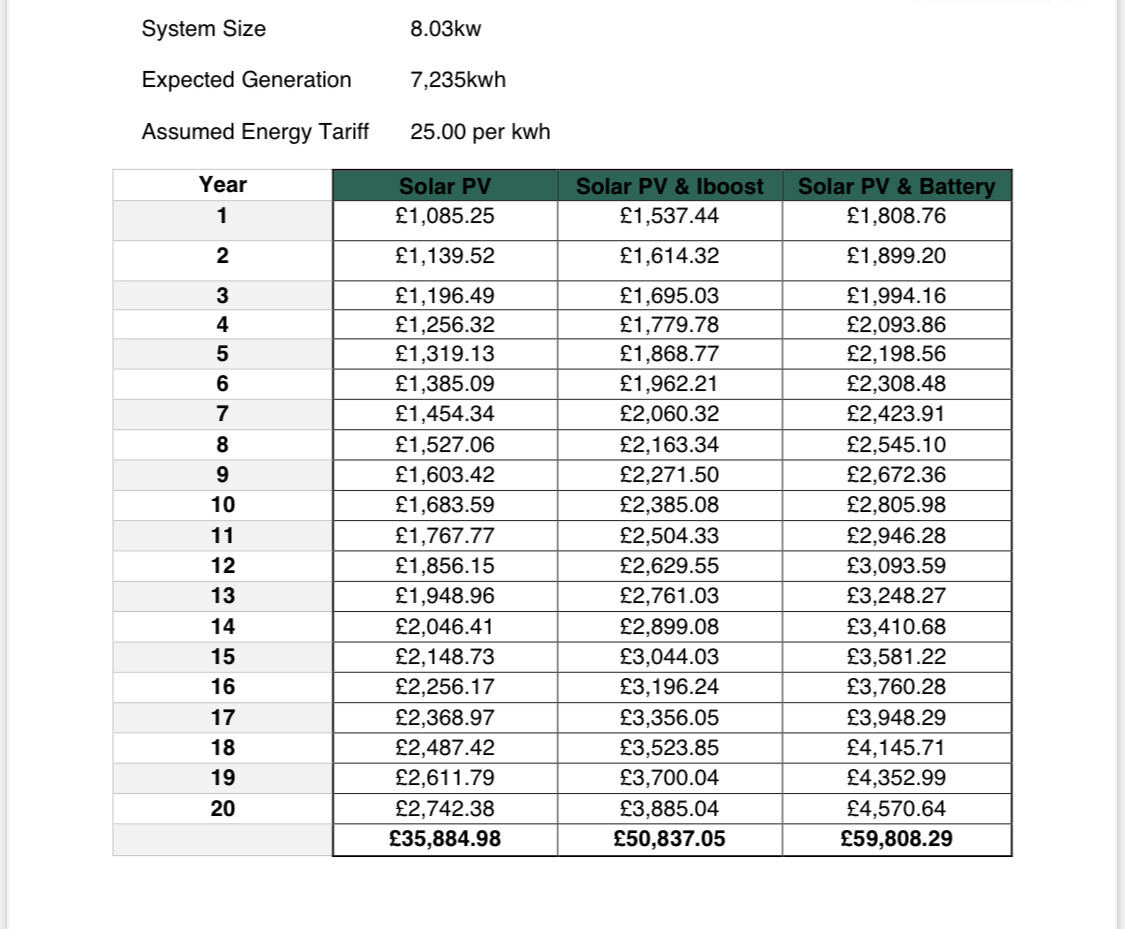

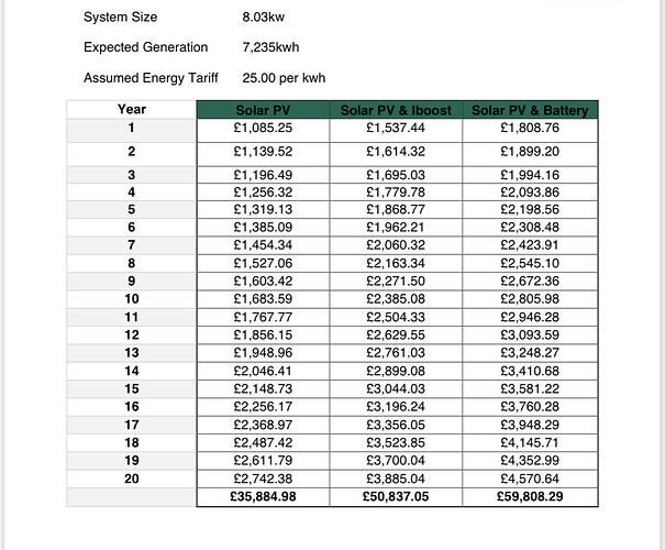

My 8kW solar system was fitted in May, cost £7600 and 13kW batteries were £6k fitted.
The info they gave me at the time suggested that the payback period (for both) was about 7 years, at an assumed tariff of 25p kWh with a 5% annual increase. Obviously with the price increase we’ve had (and the further ones expected) I’d expect that pay back period to be reduced.
Its a good investment isnt it.
My 9KW system went in last April ( autumn for me in Sydney) and payback was estimated at 6.7 years - my assessment now with price rises is under 5 years.

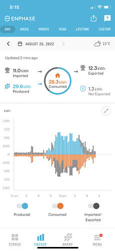

For the last 4 weeks I have been averaging about 30kW per day, with a pb of just a shade over 40kW.
Also, with a tariff that allows for cheaper energy overnight, I set the batteries to charge up overnight and discharge as needed during the day. My daytime energy use from the grid over the last month has been extremely low!
We hit 34kWh produced one day last week. I’ll report back when it stops raining……
