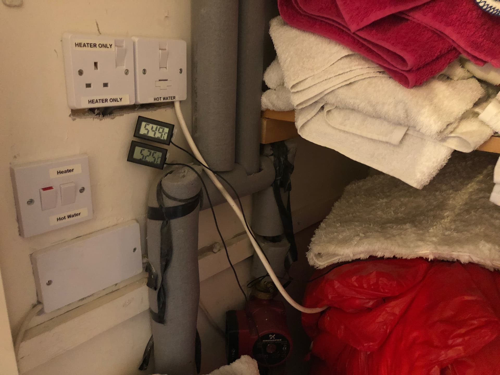

Your needs seem very similar to me. My Apollo diverter (not now available) only has the display near the fuse box. Initially this was a bit of a pest, but I found placing some £2 LCD thermometers with the probe at the top and another at the middle of the Tank tells me a lot more about how much hot water I actually have in the tank.
BTW, I have my Immersion set to 65degrees, and the Gas Boiler thermostat on the side of the tank set to 55.
