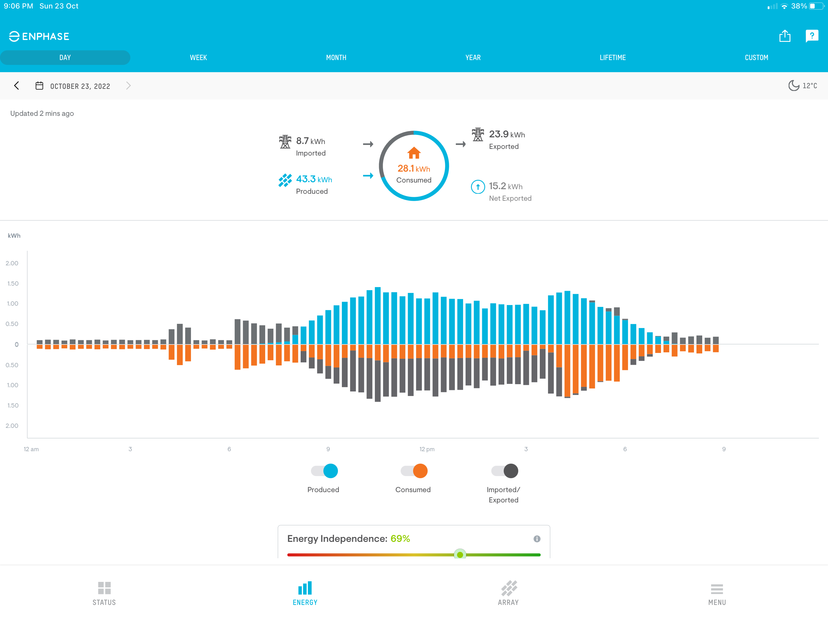

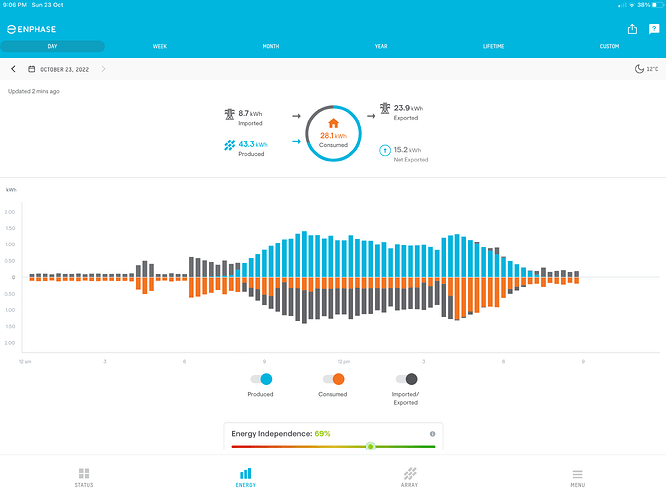

We finally had another clear day after 7 weeks of mostly cloudy or wet days (not a great spring so far) and we are 2 months away from the longest day now. So hit 43.3kWh production, the first time over 40 :smiling_face_with_sunglasses::clap::clap:. With daylight savings we have generation to cover our afternoon spa and cooking, and with cool mornings are still running a heat pump before 8am and we use our free hour of power for most of that from 6 - 7am. On these figures and the amount of exported power, that will be covering our daily power costs, including the daily charge. That’s a great outcome and I’m hoping the 6 months each side of summer will be great for solar generation.
The curve is quite interesting as we have NE (8 panels) and NW (15 panel) arrays. We get two peaks, with the first at 10:30am and the second around 4pm when the sun is directly above the larger NW array.
