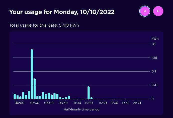

With the battery it’s a question of when I start drawing power from the mains during the evening (at around 00:30-04:30 some things like car charging and immersion heating happen). Seeing data like this certainly helps justify the spend! And on that day I used 16kWh of self-generated and exported almost 12kWh.
