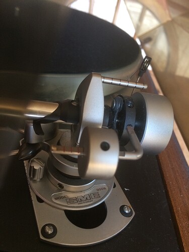

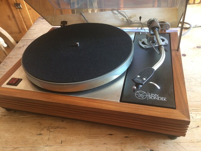

Amongst other hifi equipment, I have just inherited a Sondek LP12. The first look at it when lifting the dust cover is that the build is very nice indeed. I’ve included some pictures here. Obviously it needs a good clean and possibly a service. I can find no paperwork for this yet, and no obvious label on the underneath. So I had a quick internet search and realise its not just an average turntable and may well be a great re-introduction for me, back into playing vinyl ?. I have to say here, that I have been listening to almost 100% Hi-Res streaming for a while now, so had not planned a renewed interest in vinyl listening. But one never knows what the future holds. . . So, before I think about hooking up the Sondek and giving it a spin. . . Any input from you vinyl enthusiasts would be very welcome. For example, would this work well with my supernait 3, and is it worth finding someone to give it a good service etc. etc. etc?
Its certainly a world class turntable…
The SME 3009 is a special arm too…

An LP12 with an SME arm, the person who owned it probably knew a great deal about turntables. You have done very, very well

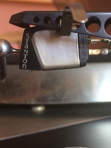

I think I can see a Stanton cartridge in the first picture, which could well be the 681, that was a classic combination with the 3009. That was a moving magnet IIRC. If it is LP12/3009/681 it should be a fantastic deck, but it’ll probably need a looking over from a specialist unless it was in regular use.
Thank you mpw/Ian2001/Eoink, for your reply. Yes it was working last year, and I know it has had light use over the years. Yes I am in Suffolk,UK and understand it may have been manufactured in Scotland? . No idea what type of cartridge it is, here is a picture if this helps?.

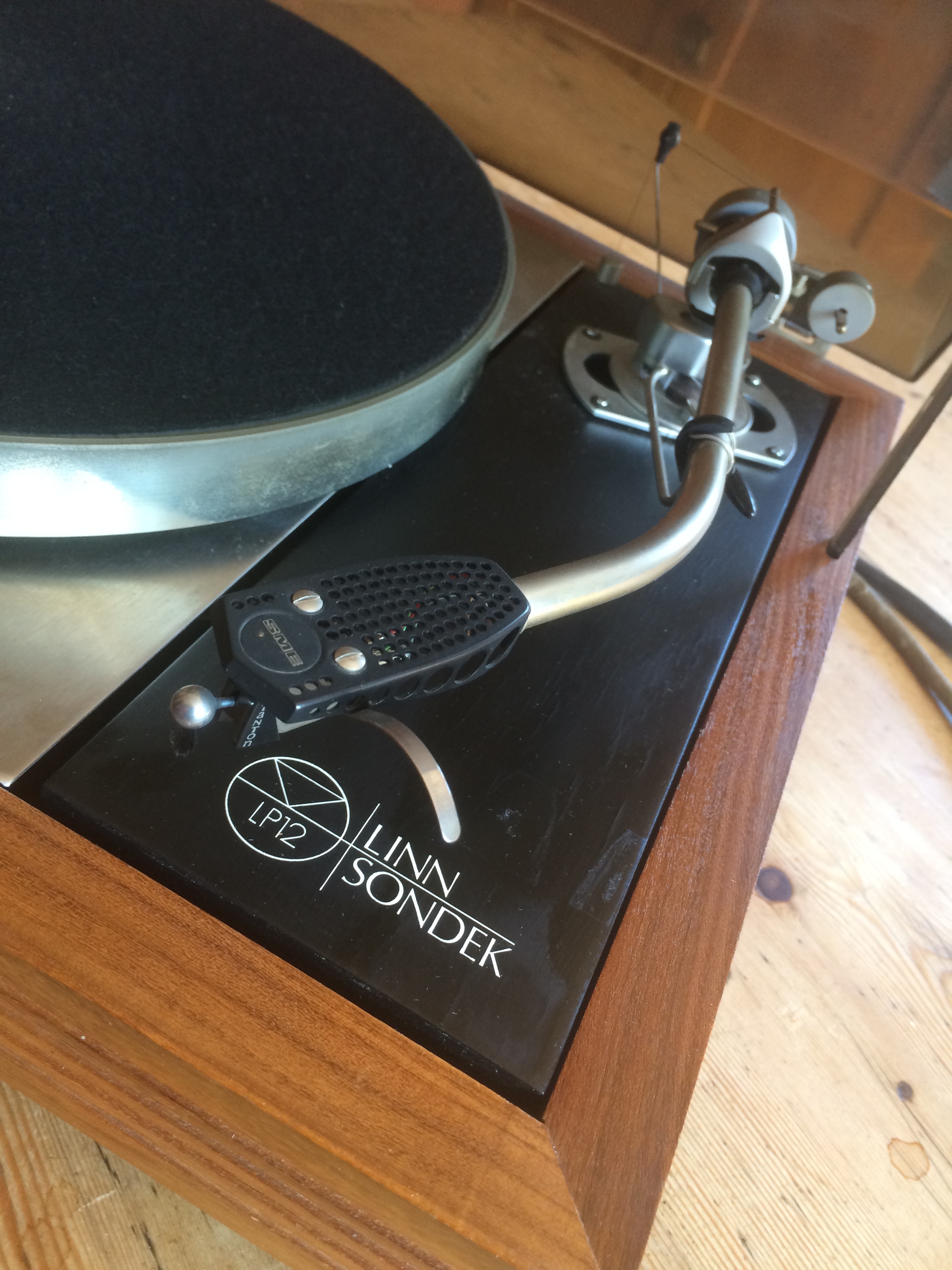

This looks like a hi-spec LP12 from the 1980s/perhaps slightly further back…but times have changed, with numerous updates for the LP12 and, as you allude, this TT could do with some TLC and may need an update/replacement electronics to make it work safely/at least some investigation.

There are many, many questions and points which could be asked here but I think the best route is to get it inspected and go from there. For one thing, I’m unclear what the shiny bulb-like structure is one the head shell - is it a protective guard for the stylus or a brush?

So we’re looking at a Linn Sondek LP12, an absolute classic turntable. It’s been a top deck for nearly 50 years. There have been many upgrades to the deck over the years, so it’s hard to say what spec you have. The SME3009 tone arm was a classic. I think that is a Stanton 681, but I’m no expert on Stanton carts, that combination was a classic and much sought after deck in the early ‘80s. I’d echo the suggestion to get Signals to look it over, it could sound really good, and if it’s the 681 go straight into your SN3 phonostage.

A great deck and the fact it is worth treasuring across generations tells its own story in our throw away, disposable age. A Linn dealer will be able to carry out a basic service (new bearing oil, belt and report on the condition of the stylus, arm bearings, operation of the motor & power supply). They can also check the suspension. If all is well plug it into the amp and enjoy but make sure your first LP is a well recorded piece of music for the full effect. A good version of Louis and Ella is great fun if you like that type of music.
With deep pockets there is a huge world of upgrades available from Linn and others if you want but I suspect the deck as is will sound great.

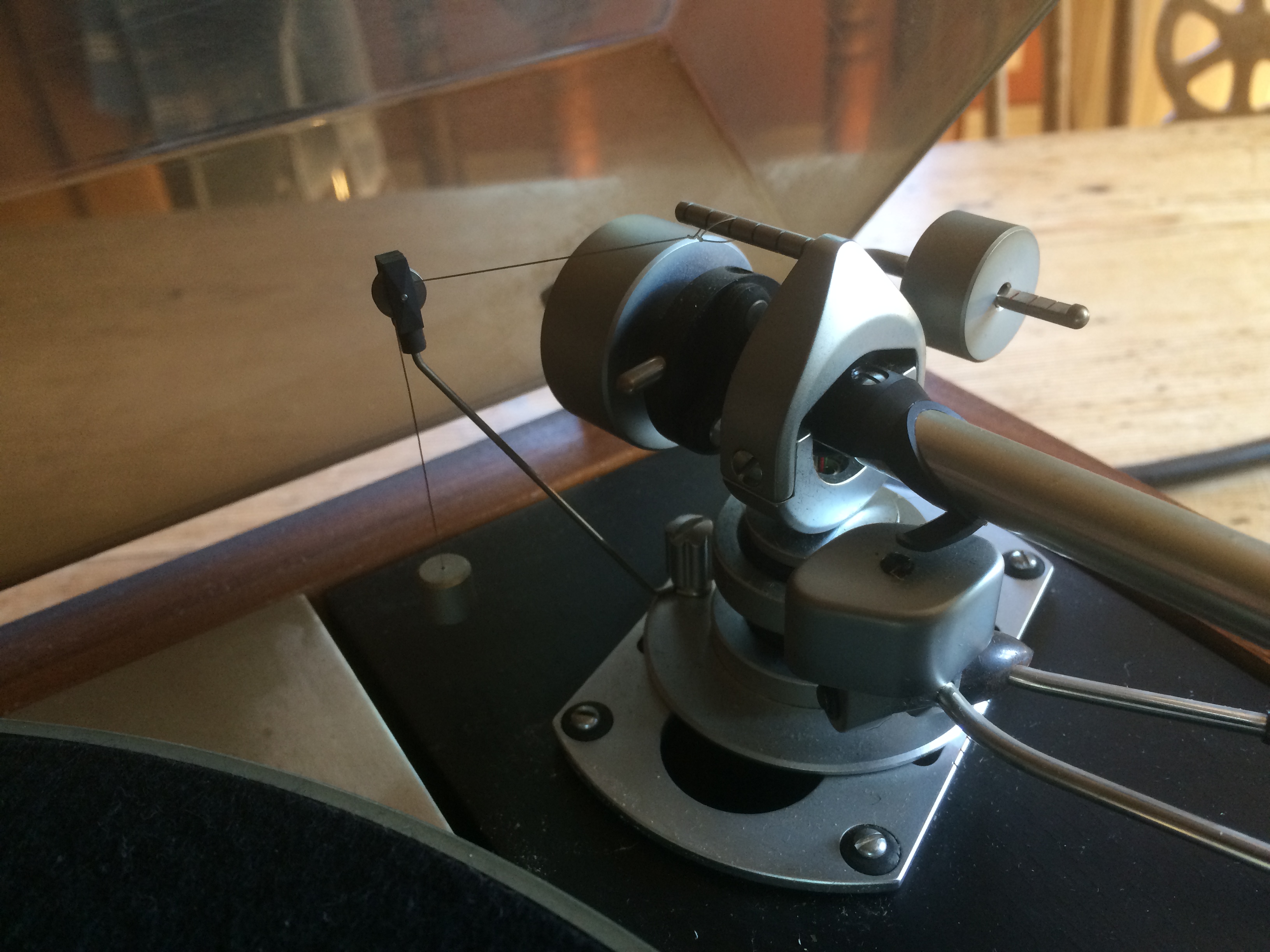

the arm should be a keeper s/t no issues with the bearings. SME arms are wonderfully engineered.

The Stanton 681EEE was a very highly regarded moving magnet cartridge back in the 80s (I think, or maybe even the late 70s). Normally, I would have expected there to be a lable on the side stating that it is a 681, so I’m not absolutely sure that it’s a 681, and yes, Stantons of that era (along with Pickerings I think) had very unusual front mounted cleaning brushes. I remember being very sceptical about their value and their effect on tracking back in the day.
I would think it very likely that the stylus could do with being replaced, so I would definitely get that checked out by a dealer. I believe that you can still get replacement styli for the cartridge.
I’d be inclined to change the cartridge as the coils are unlikely to be at their best after all these years - particularly if there has been a long period of inactivity. The SME is compatible with many modern cartridges.
