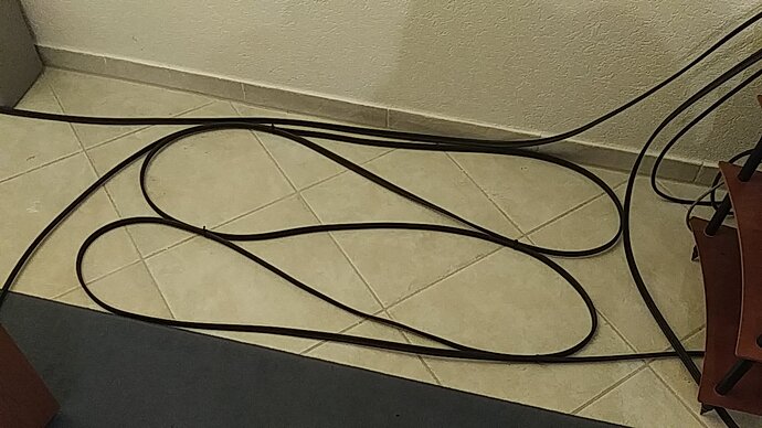

Would be nice if Naim could create a more flexible version of the NACA5, given they have achieved this with the SL. Trying to hide 5m lengths in a wife friendly way is not easy for a lot of people.

Fwiw I had in excess of 5m each side NacA5, but for domestic bliss and the fact that it is a hard cable to manage in a small area I decided to cut mine as the amp (135’s) were adjacent to the speakers, while I am not disagreeing with what Richard said above I don’t feel I lost anything by having shorter cable (3m each side) but it is a great cable for relatively small money.
