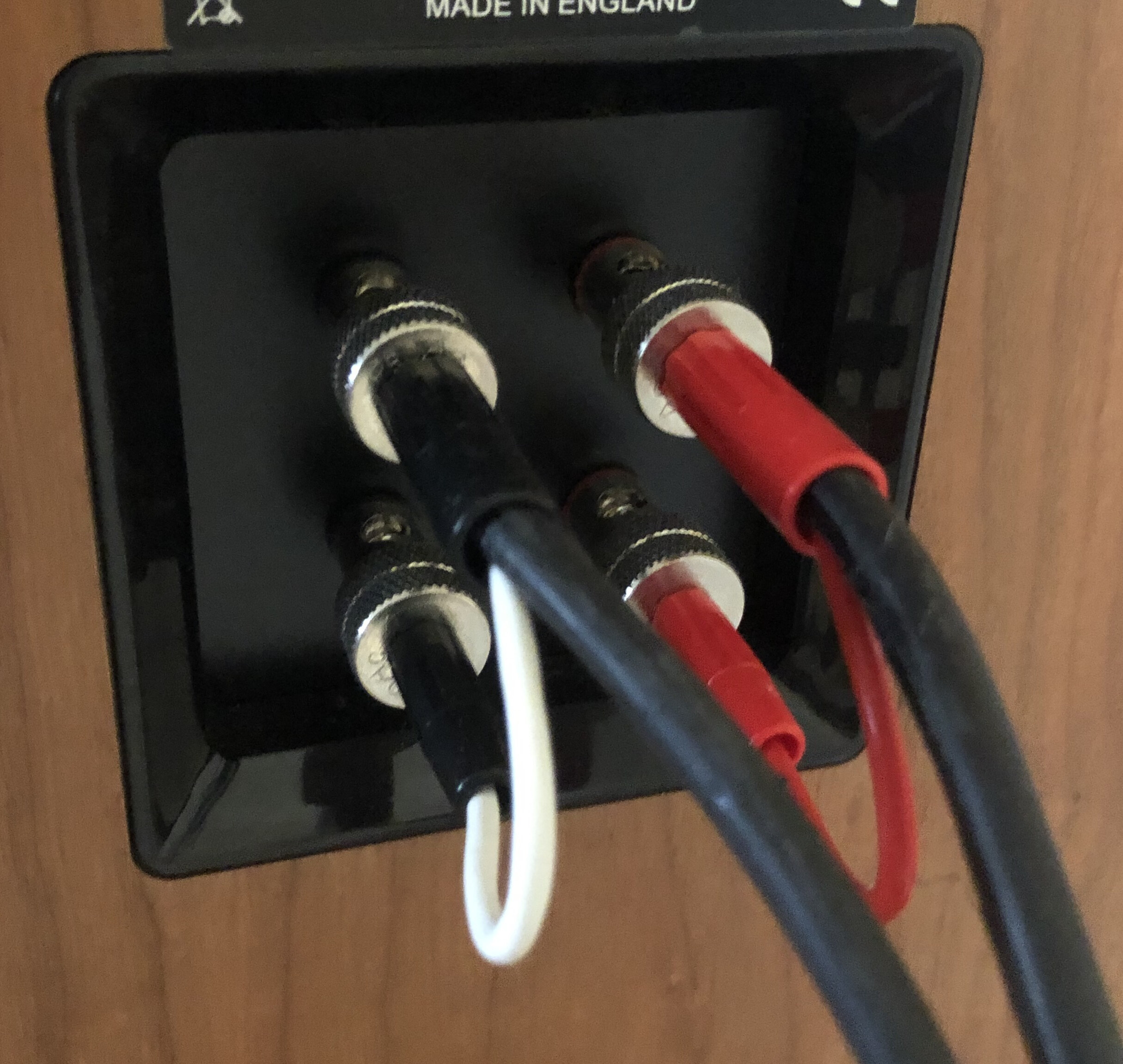

The solution is this:
That’s what I meant, thanks.
You didn’t solder the wires did you?
One example: The dealer soldered the jumper cables to the NAC A5 when I purchased my ProAC D30RS
The problem being here of course - the more solder joins, pins, different metal platings, jumpers in the chain, the more of the above will be effected.

ProAc’s with matching AU24-SX Jumpers
I recently tried doing just this, with NAC A5 and banana plugs from the standard Naim SA8 double plugs supplied with most Naim amplifiers. It almost worked.
Soldering pins to the ends of the wire was fine. But soldering pins to a section of wire from which the insulation had been carefully removed proved too difficult. Even with a 100W soldering iron, I couldn’t heat it sufficiently for the solder to flow properly. It seems that having the copper wire either side of the join (compared with only one side when terminating a cable) gives it too much of a heat sink. So you’d need a pretty powerful soldering iron to do this.
I gave up, and instead terminated the ends. Then made little jumpers using bits of NAC A5. Soldered at each end to keep the wires intact, but leaving the copper exposed to make the actual connection. (I am not sure if this is naughty, I suppose the copper will oxidise over time. Perhaps it would be better to terminate the jumpers with banana plugs at one end and spades the other. But I figured I’ll just make new jumpers from time to time with spare NAC A5.)
