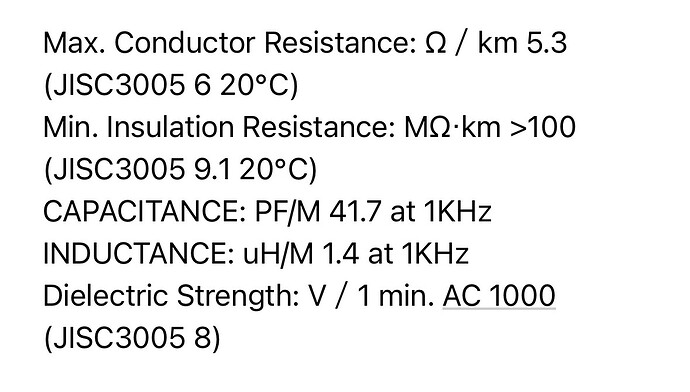

Hi looking for some input on speaker cable specs for Naim Classic 300dr. Naim specifies certain specs using specific terms and not being a super tekky type was wondering if these Furutech would work well
The specs quoted by Naim are for A5. But you can in fact use any cable with the 300DR that you like the sound of and not worry too much about the specs.
The above is fairly low capacitance and high inductance so would probably be fine on older Chrome Bumper Naim amps of the 70s and 80s that had stricter requirements. It certainly won’t be an issue with the 300.

Just for comparison:
NACA5 inductance = 1uH/m
& capacitance = 16pF/m
Superlumina moderate inductance 0.74µH/m
low capacitance 66.4pF/m
Whereas the highly inappropriate kimber 4tc
CAPACITANCE: 136pF / m
INDUCTANCE: 0.225uH / m
I believe even that is fine these days according the Steve Sells. Naim amps have had zobel networks for a few generations now and Richard has earmarked the FAQ on cables for update.
I personally would never consider using that brand of cables with Naim; others would agree. Tolerance of newer models aside; my sn2 is within the ā€œtolerantā€ era.
Yes, they have zobel networks, as do all audio power amps.
A zobel in this case is a capacitor & resistor in shunt across the output stage.
The thing that Naim don’t have is a series inductor, Naim use the speaker cable inductance for this.
How this all works is as follows … The zobel capacitor begins to conduct as frequency rises and the 10 ohm resistor becomes the damping element shunting the circuit Q.
With the variable capacitive reactance of the speaker load coupled to a length of speaker cable the Zobel circuit alone may not be enough. This is commonly solved by placing an inductor in series with the amplifier output downstream from the Zobel shunt circuit.
Naim do not have an internal inductor and instead use the speaker cable to provide inductance.

That might be the case, but my post is simply pointing out that all SS power amps must have a zobel on the output stage. What Naim don’t have that’s associated, but not part of the zobel, is a series inductor on the output.
I suspect the other reason Naim don’t suffer with capacitive reactance oscillation with later model amps is because they roll off output above 20kHz.

Bi-wiring is a no-no with Naim as it halves inductance & doubles capacitance as seen at the power amp output.
That’s 180 degrees in the wrong direction, Naim work best with high inductance and low capacitance.
