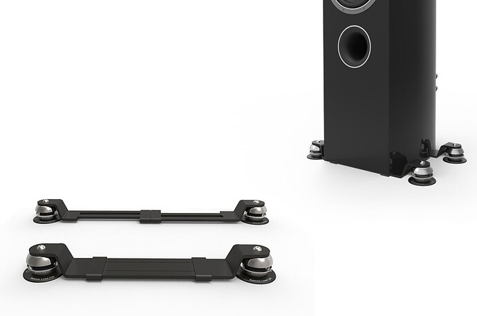

Townsend seismic isolation bars may do the trick

According to Townsend’s website these are not recommended for speakers weighing in excess of 30Kg and more than 1m tall due to stability / safety issues.
Yes I could. However I’ve now reverted to the ‘as supplied’ mode and I certainly prefer it overall to the Herbie’s pucks so I think I’ll just leave it there. Life’s too short.
