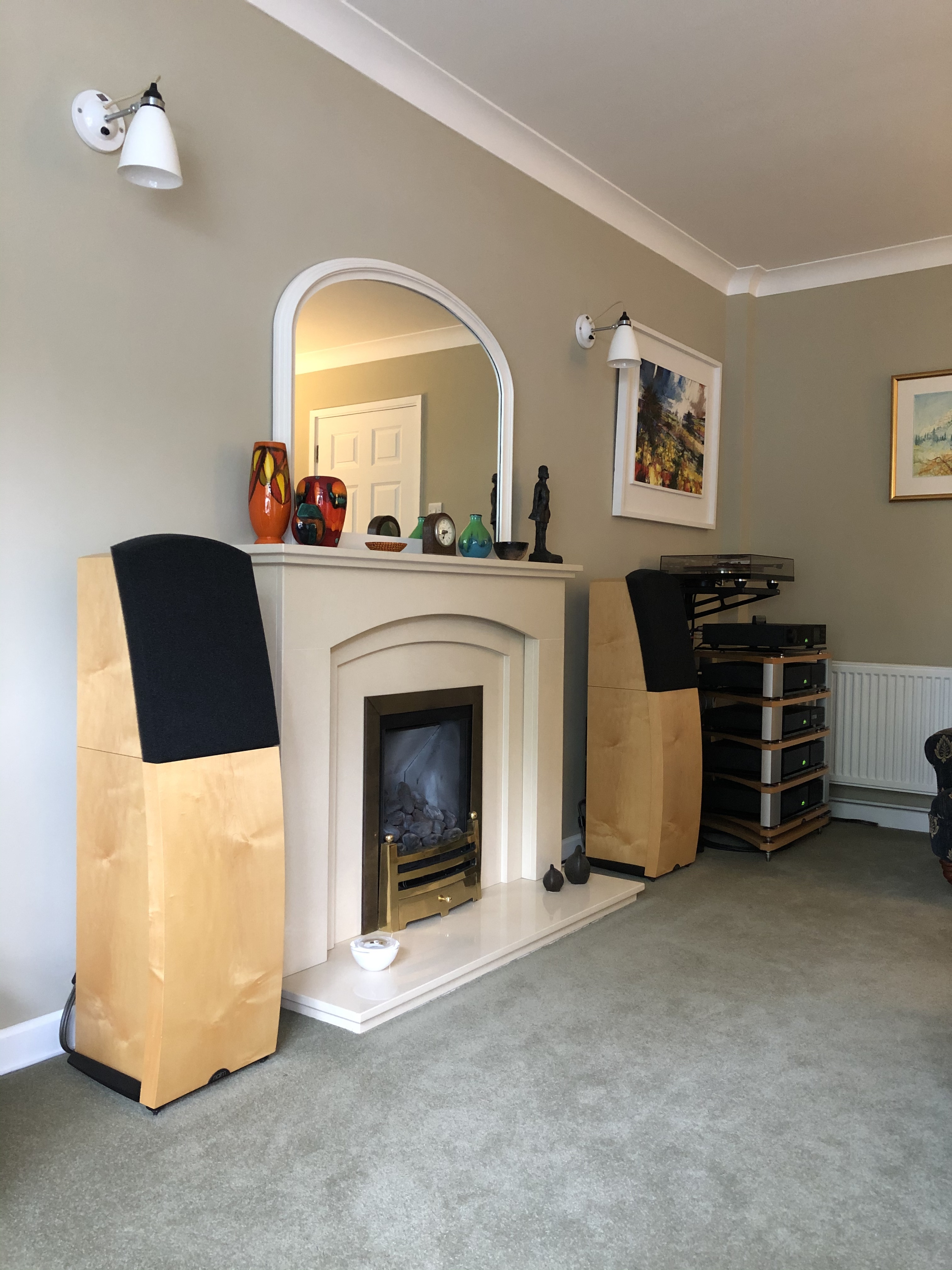

I think much depends on manufacturer. I have a pair of small in stature Neat Elite SX and they sounds much better 8ft apart with a significant toe-in. Whereas any pair of Dali’s I’ve ever owned like to be placed parallel. Perhaps this is my room. I also think a bit of the parallel placement seen in the ‘system pics’ thread is a bit of an aesthetic choice. It does look neater.
Agreed to try and correct my room imbalance that causes one speaker to be louder than the other I toe in one more than the other and it helps.
Case in point - nice and neat! Out of interest, it looks as if your Fraim is pretty close to the wall; do you find your cables a bit cramped?
There is actually loads of space behind. More than I’d really like.
