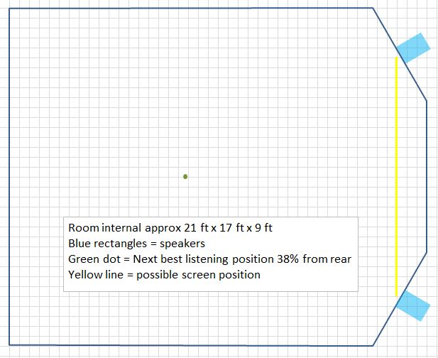

The following rough sketches give an idea as to the layout I’m considering - the near position probably ultimately best sound quality, the further one demanding more in the way of rear reflection control, but more accommodating for several people to listen, While the smoother response from flush speakers would increase liustening position flexibility.
