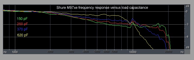

I’m considering installing a MM cartridge in my LP12/Ekos turntable (the exposed cantilever on my Lyra is just too tempting for a “senior moment”). However, I see the specs are listed as 47kOhms/470pF. That’s an awful high input capacitance for most MMs (with 100-150pF from the arm cable, it’s ~ 600pF total). Won’t this wreck havoc with the frequency response of most MMs (in particular, the new Shure M97xE I have tucked away for a rainy day)?

This is the data that sparked my concern. At the estimated input capacitance of the Stageline-N plus arm cable, frequencies over 10kHz are basically gone:

The input capacitance causes a resonance in the cart response. With an MM, this is within the audio range - and is why MM are sensitive to input capacitance.
With an MC the resonance is much higher - and would only trouble a young dog… :dog:
