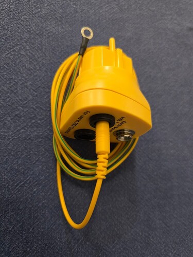

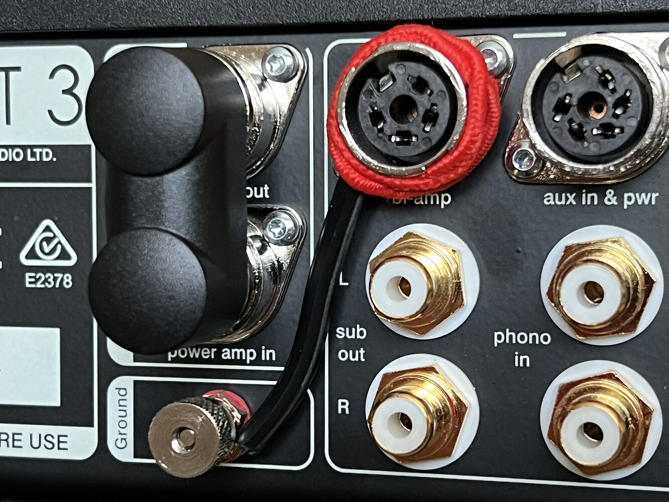

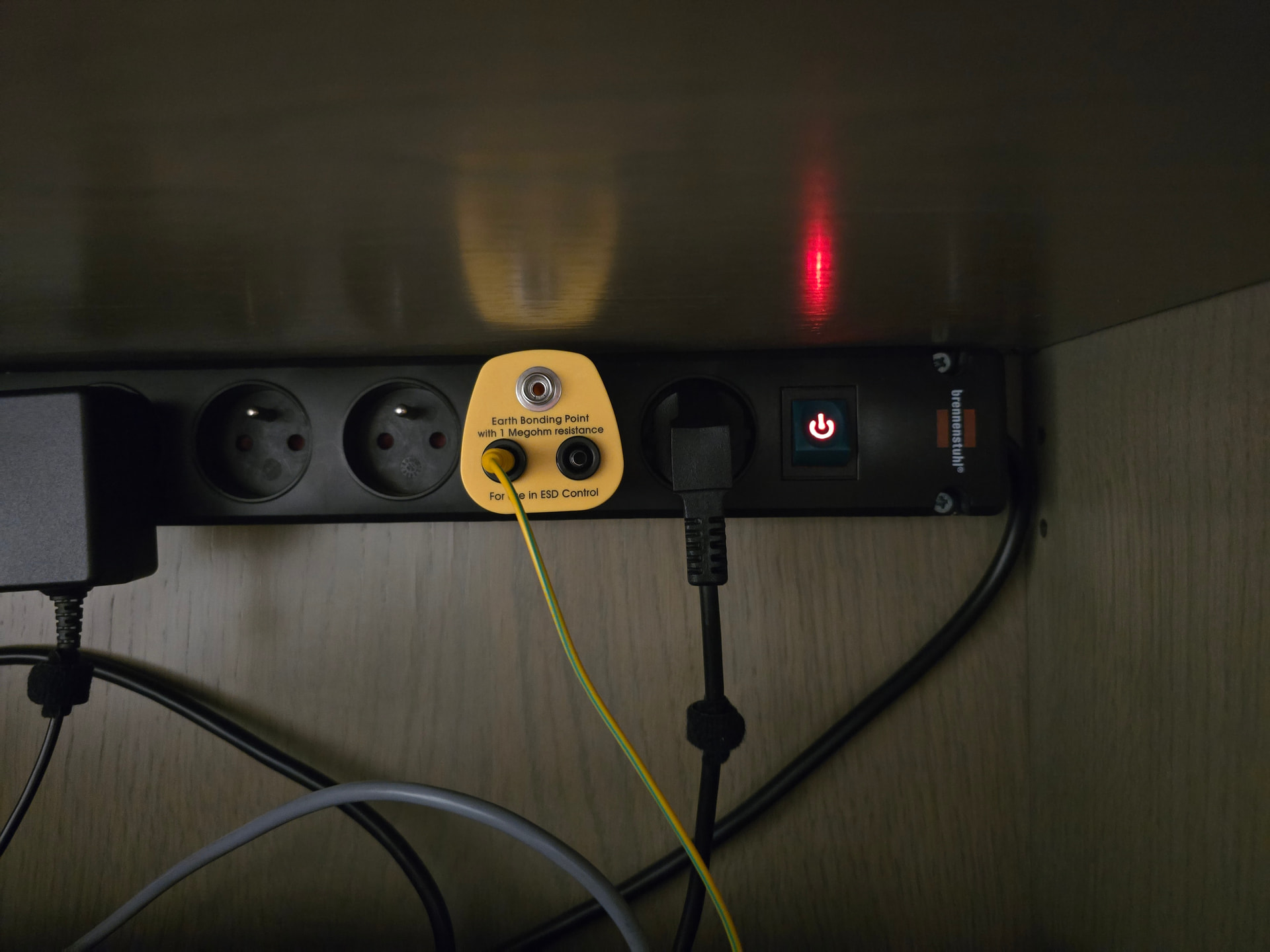

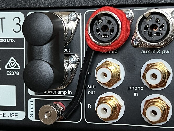

Try to ground the SN3, as I have grounded the N50 with this funny plug.
I created a thread about it on this forum a couple of years ago and with the help of others came up with the below. It worked for the hum but I sensed it removed something from the sound too, so took it back out again. Nothing major, just a real subtle difference, like the improvement in playing from the sd card in the 2go with it in airplane mode.
I think you create a loop with that configuration, try connecting directly to the power block, it really works!
Is the other end of your earth cable to the ā€˜ground’ on your N50?
Correct.

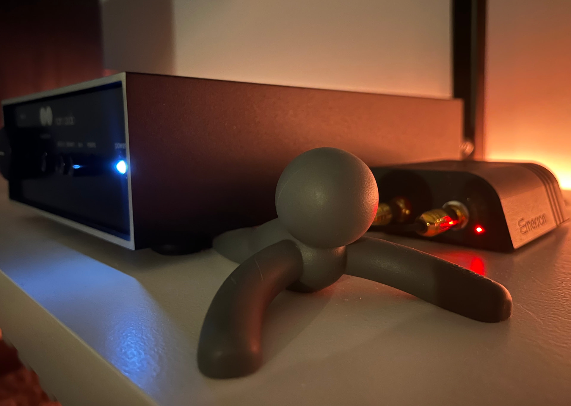

Straight Signal Path with the same industrial design language as my Nait 50 with even fewer features (-;
No WiFi
No Bluetooth
No Screen
No Headphone Jack
No Mechanical Volume Control ( LEEDH )
No Remote
Bit Perfect
Qobuz Connect
iRadio (airable)
iOS Interface.
